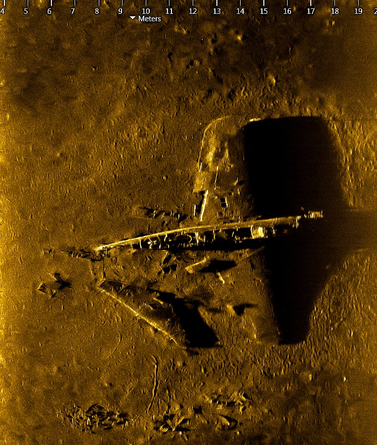

Edgetech 4125 side scan image of a plane
  • Edgetech 4125 side scan image of a plane
    The best image of a downed aircraft I have ever seen.Click image for larger version

    Sweet image-nice work.
    As I am now buying an Edgetech 4125 (400/900) tell me what the frequency was and distance was to the plan.
    Post more if you have them.
      That image was taken with the 600/1600 kHz Edgetech 4125 system. It is by far the best scan I have ever seen! I also had a 400/900 4125 out that day and collected images in all frequency sets of the 4125. All of the images were collected within 30 meters range per side. Your 400/900 will get ranges to 150 and 75 meters per side respectively. As I was really more interested with making the highest resolution images I could, I didn't tray scanning at longer ranges. I might go out again for some long range scans when I have time.

              This picture or scan looks like it was taken looking vertically down
              but why is there a shadow to the right of most objects ?
              damn fine picture though.
                The tow fish was about 2.5 meters off the bottom slant range from 7 to 15 meters off to one side.

                    It is sure a nice scan ! but the fish was only 2.5 meter above the bottem ???

                      As a general rule the tow fish height off the bottom should be 10% of the range setting to get the best backscatter energy and the best image. Range setting for this scan was 25 meters per side. That is one of the reasons hull mounted sonars don't perform as well in deeper water.
