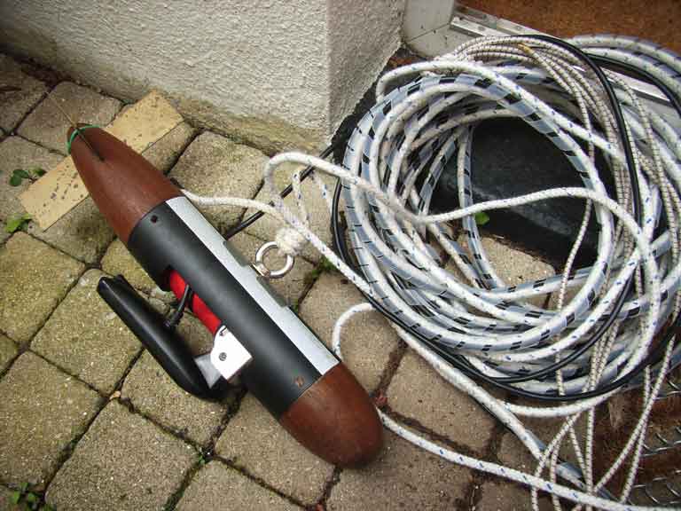

          Have had a go with the 981 transducer in a homebuilt towfish. There is one extension cable attached (a thirty foot version) but Humminbird were not keen on additional extensions.....they felt that cable capacitance would be excessive and this would adversely affect unit performance. If anybody has made their own 'long' extension or joined together a series of Humminbird ones.....and has had decent results.....I would be quite keen to hear. Cheers.

              981-based towfish
              Chaps,

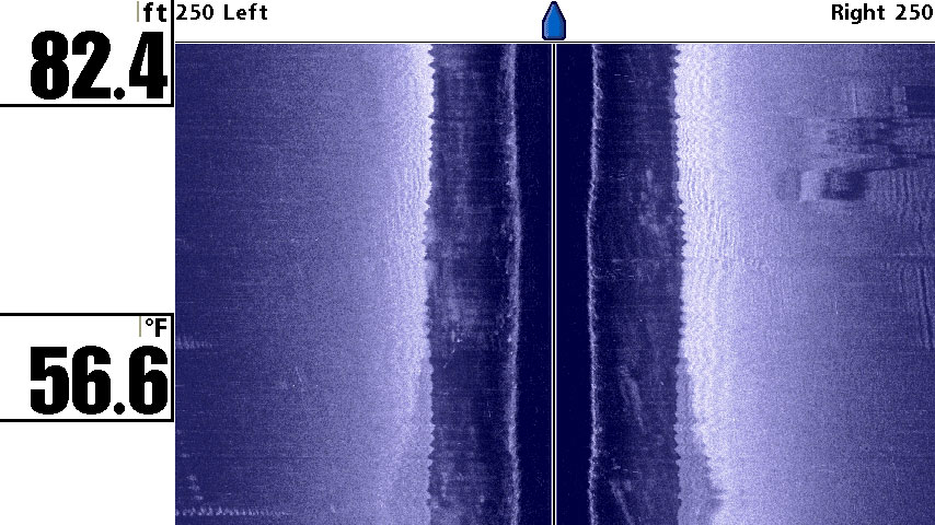

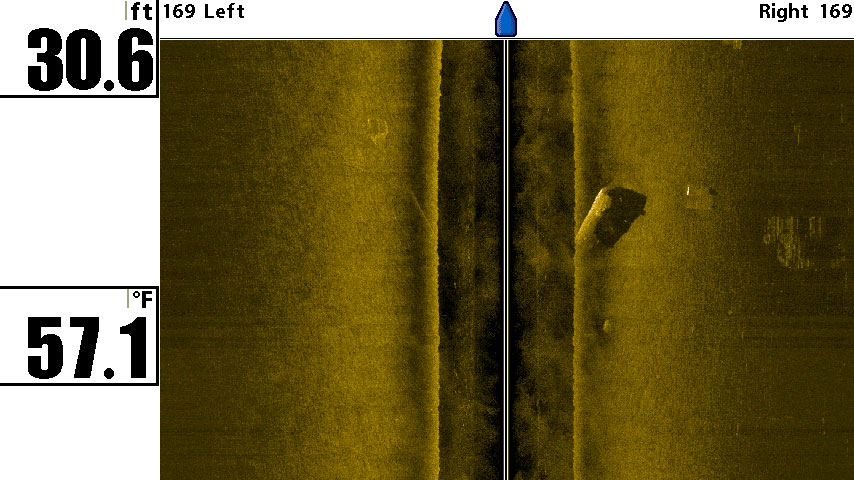

              Think I've attached a photo of the 'gadget' and two screen grabs from the system.
              On one you can make out the underwater 'habitat' just inside the breakwater at Plymouth in the UK. Also recognisable is the used tyre artificial reef....the area is used for commercial diver training and consequently there is plenty of debris on the sea-floor. This was taken in calm conditions and boat motion was slight....consequently the definition is good and distortion minimal.
              The second one shows operation in a slight 'chop'...therefore efforts have to be made to minimise boat motion (whatever you feel in necessary eg. tow with the wave motion). The 'inside' of the right and left traces show distortion, which gets worse the more the boat moves around and the wreck of the ELK is also distorted. In the lower left corner is 'noise' that might be associated with a high-speed engine (speedboat).
              The main problem with the 'set-up' as it stands is that you have to think hard how to minimise boat motion, in order to get the best images, image distortion being a prime issue. The tow cable is simply not long enough to allow you to a). get the fish far enough behind the boat to effectively 'de-couple' boat movement abd b). get it deep enough to throw a good sonar shadow.

                  Is the tow fish balanced? It looks like the tow ring is more in the middle and will cause the fish to be slightly off balance depending on depth and more suceptable to movement, possibly causing it to wobble significantly.
                  Robert
                    I also mention the balance issue because it looks like you are getting a double return. The transducer is not parallel to the bottom and a false bottom is showing up (the lighter line between the center and hard bottom return). It is prevalent in both images.
                    My suggestion would be to check the fish in a pool or area that you can view it under water and see how it pulls. I would bet the nose is slightly down and this is whats causing your problems.
                    Good Luck and let us know how it turns out!
                    Robert
                      Tow-fish balance
                      Rob,
                      Unfortunately I have no idea how the tow-fish actually 'flies'. It seems to work well alonside the boat though! I arranged the towpoint to be slightly ahead of the centre of gravity, so when the fish is suspended by it's rope it actually hangs slightly tail down. The thinking behind this (even if incorrect) was that, when the fish was towed, water passing over the fins would lift the tail into position....I imagined the balancing act between the tail being slightly heavy and the lifting force of the fins might confer some stability. It does seem to work quite well.
                      My main problem (I think) is just that the tow cable is too short. You need to have the towfish both vertically and horizontally separated from the boat in order to clear turbulence and isolate the fish from boat motion.
                      I'll work on this. In the mean time if anybody has already extended the cable a second time time.....please say something!!!!
