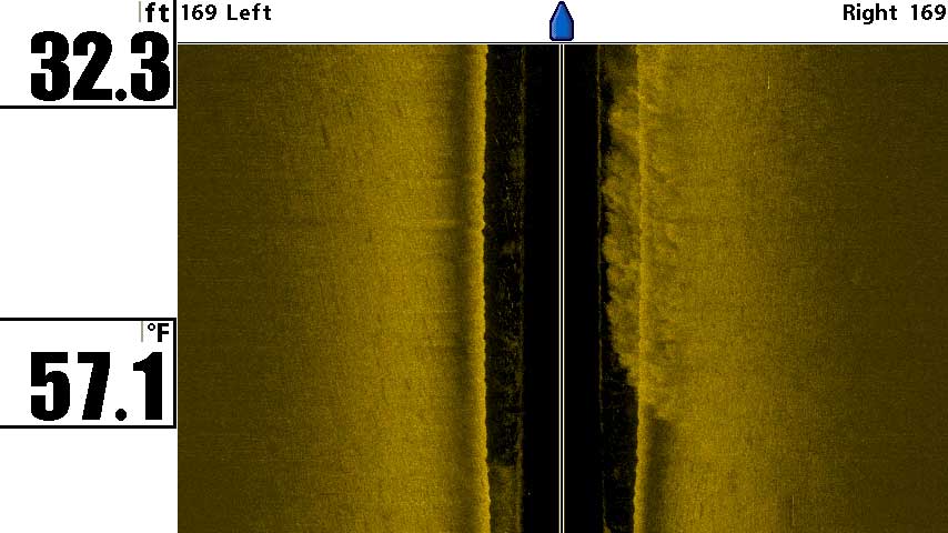

    Rob. You mentioned secondary returns on my screen grabs. I'm not very experienced with all the subtleties of side-scan but seeing as my towfish wasn't that deep, I did wonder whether some of the 'ghostly' bits that have appeared were 'surface returns'. I don't know whether I posted any of these....I'll check. My main problem just seems to be that the cable is too short....therefore I cannot get the towfish far enough behind the boat in order to isolate it from boat movement. Thus....every time there is a choppy sea (that's just about always in UK waters) the boat 'bobs' around and pulls on the tow-fish.....hence less than perfect pictures!!
    I'm going to have to just buy the other cable extension and see how I get on.
    This screen grab has ghostly bits and secondary returns!!

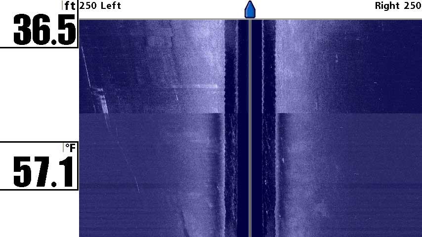

              Just as a matter of interest (but....bearing in mind I've only managed to get my little system into the water twice this year (failure!!)) I've included another screen grab.
              This shows the change in contrast when switching between frequencies. The upper half of the screen shows 262kHz and the lower half, 455kHz. No attempt was made to optimise the picture.....I haven't got that far yet although, as the image is a bit map (.bmp), photoshop or something similar could 'do a job'.
              I'll keep my fish as it is for the minute but will get some larger fins (easiest to do!) to try and increase longitudinal stability.

                I think the towfish works fine! I believe the "line" you see between the towfish and the bottom is an echo of the surface with waves.
                That you should be able to check easily by pulling up the fish slowly; the bottom ecko should then get farther away and the "surface" should get closer???
