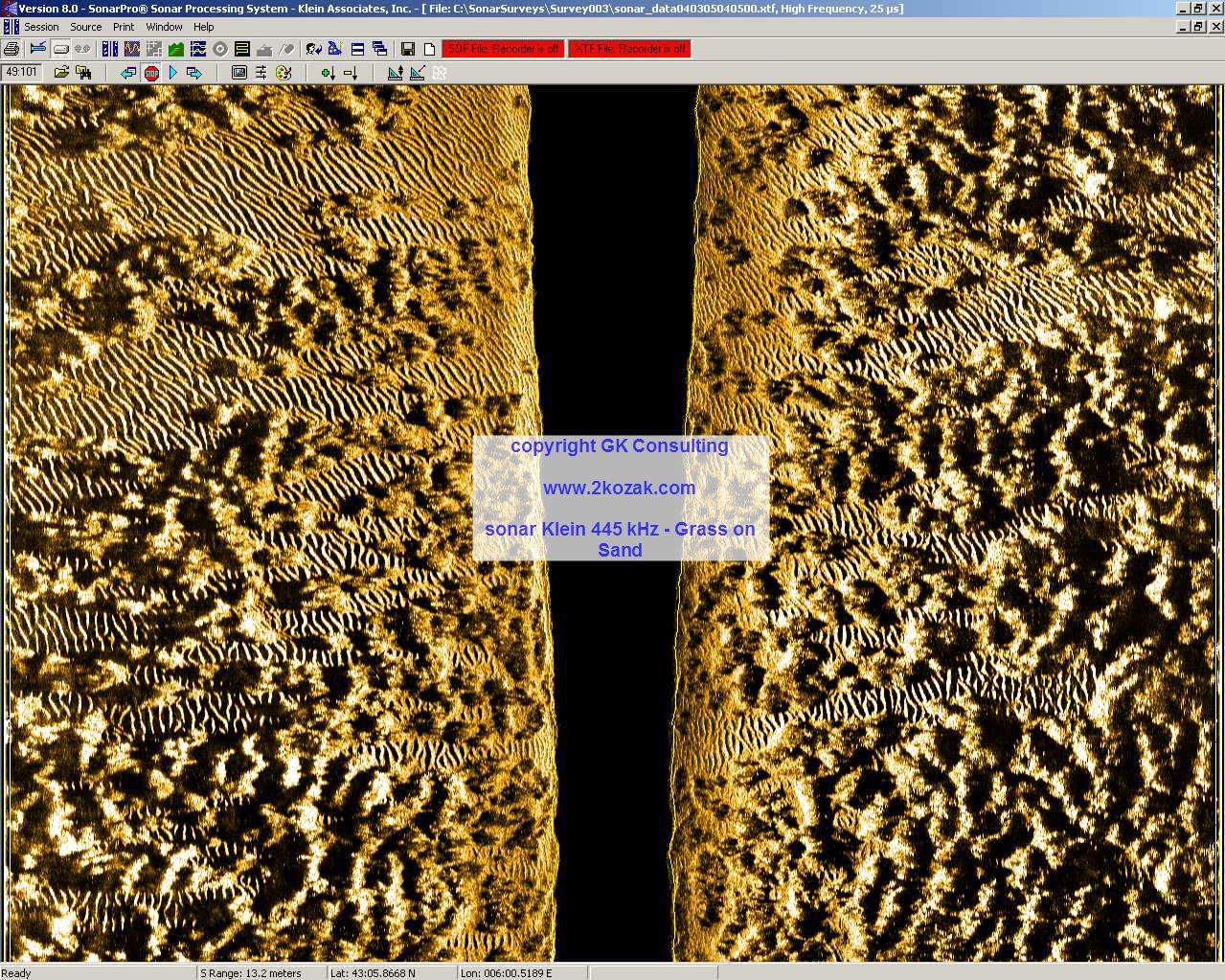

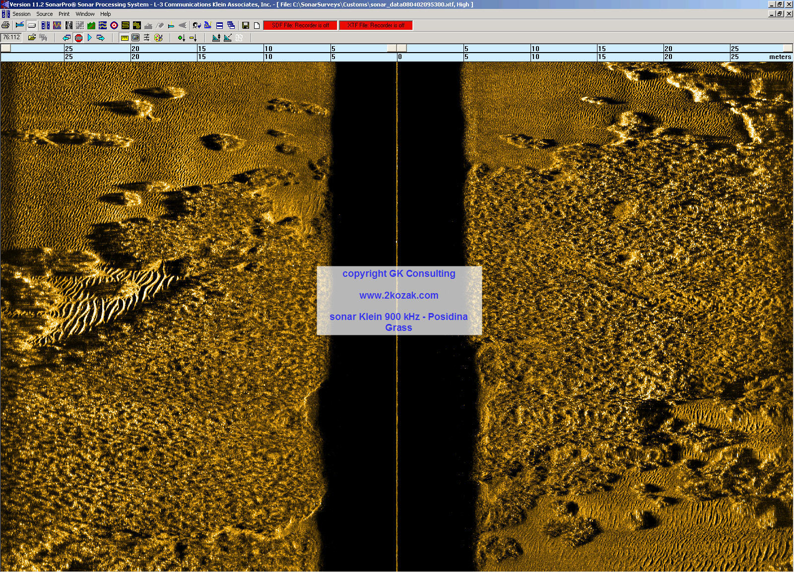

                          Hey Rob, Do you have any side scan sonar images of the grass beds? I am about to conduct a survey that includes oyster beds and grass beds. I know the oysterbeds will show up ok, but I'm concerened about identifying the grassbeds?
                          Thanks,
                          Jeremy
                            Jeremy,
                            Hi frequency side scam sonar systems are very efficient in mapping grass beds. attached are a couple example images.
                            Garry Kozak
