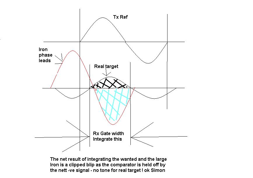

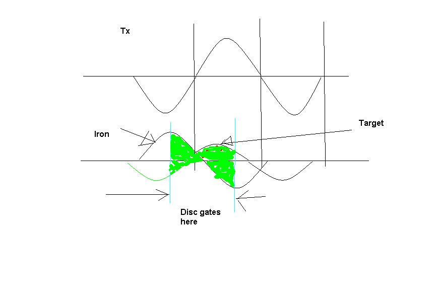

              After what qhahzi said yesterday about how Fe and non Fe signals appear to the comparator - I finally get it. phew.
              From that knowldge, I was thinking of my case in the Iron rich fields. plaques of cast iron the size of your hand scattered everywhere.
              Think of the integration of these targets on the disc Ch .... you get a v large -ve signal which holds the comparator off. A small positve going non Fe signal could be in there but you cant flip the comparator due to the elephant in the integrator giving massive -ve charge. 9 parts -ve and 1 part positive is 8 parts -ve - So Iron all the way no hear your real target.
              Were doomed - ,, hang on - the Disc Ch could be uni polar - So you have no massive -ve signal from Iron . Iron would not register,
              So a small positive signal could still set tone off. Currently the Dixc Rx Ch would have a belly full of -ve sig on it and no chance to hear the gold.
              Sure theres reasons why Im wrong - but cant see too many from here.
              Not certain how to go about it though - thats for later..
              There was a guy on here saying his IDX PP was rubbish - Swap your Rx lines over mate..
              Mine was the same - its really good now, also Iron has quietened right down as it would and its a joy when built right!! Not hugely deep - but very usable.

                    With disc set to cancel Iron it accepts real target phases.
                    with Fe larger than target mass - you get a -ve going result larger than small +ve going - so on average you get a -Ve signal holding the comparator off - no tone -- But you miss the real target.
                    Like -240mV of Fe sig and +80mV of real target together gives net result of -160mV and miss target.
                    Same for any machine like this - not knocking IDX - just learning.
                    S
                      struggled with pic attach!!
                        S
                        I agree, and how to best deal with it depends somewhat on the sizes and phases of the trash.
                        I don't think it is a matter of the iron being larger size than the target. Rather, if you could know the phase of the iron trash, you could set your DISC control to exactly "zero" the response to the typical piece of iron you are worried might hide your real target. If set it that way, the iron should not hide your target, because the iron adds exactly "zero" signal without going negative.
                        The success of that depends on how much the phase of iron depends on the size of the piece, and the range of sizes of trash. I was hoping it is a reasonably small range so you could pick a good point to set your DISC pot to "zero" most of the iron without the "-ve" problem causing much hiding of targets.
                        If the data in the graph Davor posted is accurate, large pieces of Iron will make the phase go more positive than small pieces. So we know that to "knock out" iron from making false signals, we'd need to move the DISC setting to make large iron signal weaker (close to zero response) than our target signal. However, smaller pieces of iron would try to make the signal go negative and potentially hide targets.
                        And I agree, not much we can do about it if our trash has many different phases. Two targets of different materials very close together will probably combine in phase to look like a different metal. Digging is required.
                        -SB

                          "you could set your DISC control to exactly "zero" the response to the typical piece of iron you are worried might hide your real target. If set it that way, the iron should not hide your target, because the iron adds exactly "zero" signal without going negative."
                          If you move your Disc to Integrate out the Iron - you loose half of the Target signal..
                          • #43
                            That's true, but anytime you have DISC and GEB channels, you lose some target signal. Because DISC and GEB channels have different sync pulse phases, one or the other will not be maximum target signal, and because both must exceed the threshold for a beep, you will never get "maximum" sensitivity no matter what.
                            We usually accept this -- for example, if you are looking for silver and you discriminate out copper, you will lose most of your silver signal, it is a fact of life. Iron at least is farther away from most target metals and zeroing it will not hurt as much usually.
                            To summarize, if you "zero" out iron, you will maximize whatever metal is 90 deg more phase. For example, if you "zero" the DISC channel response to large nail at 40 deg (referring to chart Davor posted above), you will maximize response to 40 + 90 = 130 deg, which is close to zinc and large gold ring. Of course if the GEB channel is set to "zero" ferrite at 0 deg, then the GEB channel is maximum at 90 deg, which is small gold ring / small gold chain, and that will limit the total response to the large gold ring (although not much).
                            So I guess we need to know what we are looking for and what type of trash is the most problem and check the chart and try to pick the best DISC and GEB settings to do the job.
                            To me, if I'm looking for gold far away from typical "picnic" trash, I would be tempted to use ALL METAL mode where both channels are set similar to the GEB channel and should be quite optimal for small gold pieces, I would think. But if much iron is around, then probably no choice but to zero out the iron as best as possible and lose some of the gold signal.
                            We also have to remember, this discussion is about not losing target when iron and target are very close together spatially. Otherwise, any DISC setting that makes iron zero or negative is fine.
                            I'm definitely going to think about modifying the TGSL AM sync pulse to get a square wave if possible, and maybe without phase shift, since it might make a useful gold hunter.
