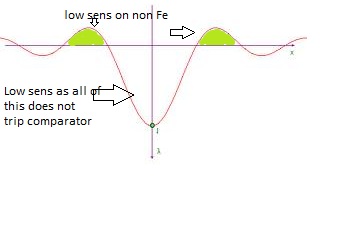

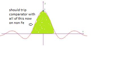

                That explains why on mine which is wired reversed -
                Gives a double tone each way for a target. See image.
                The double tone does give a clear ID for a real digable target - and I get 8.5" on shotgun brass in mineralised clay - measured properly in the field - placed FlAT- FACE UP
                I swapped my Rx wires over at lunch so I will retest tonight on way home. I expect Single beep indistinguishable from Fe target.
