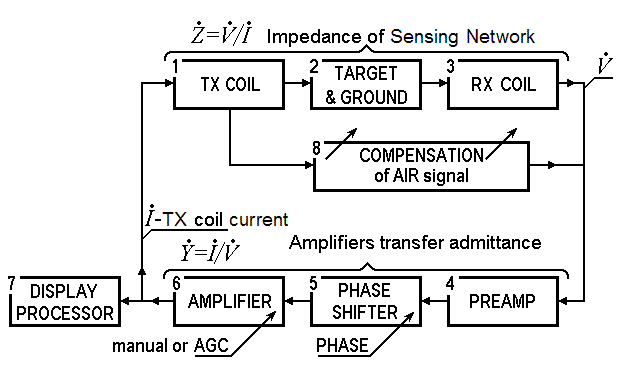

    How seems the block diagram of most sensitive discriminating BFO metal detector?
    I posted this information scattered in several threads of the forum. However ham builders keep to use primitive BFO circuits. It is time to start this thread for more completed explanation of design process for BFO type MD and to make,
    REVISION AND REDESIGN
    of several arbitrary BFO MD circuits.
    The design of an electronic appliance should start with analysis of most suitable block diagram. We need the most suitable block diagram also for revision and redesign of an existing project. Below is attached the most suitable block diagram for BFO type metal detectors, reinvented and renamed by (R)EMI group. The "new" name of BFO MD is REGEN or REGENERATIVE metal detector because transmitter and receiver are connected in postive feedback loop forming SEARCH oscillator. Google for "regen receiver" to understand why this name was very popular in 20-ties and 30-ties of 20th century.
    Here is the explanation how most sensitive search oscillator works:
    TX coil (L1) and amplifier (blok 1) form a transmitter for noise induction metal detector. If you can't believe this, please connect a loudspeaker instead TX coil. You will hear random NOISE because there is no regenerative feedback. To understand how an oscillator works, connect also a microfone instead RX coil. Now you have an audio locator because it can locate different objects which reflect audio waves. The audio locator can be adjusted to operate in three different modes:

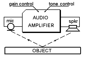

    If you have an audio amplifier with gain control and tone control, make the mentioned locator and play to understand that an oscillator is very noisy regenerative amplifier tuned to a frequency. The tuned circuit increases regenerative amplificitation of this frequency only.

        Please try this to understand how an oscillator works.

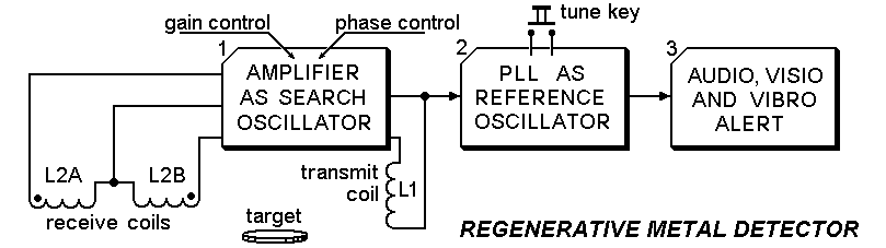

                      The regenerative principle with induction balanced search head is suitable not only for pinpointers. We can design a search oscillator which eliminates shallow targets and starts to oscillate when there is deep target buried in bad ground. For this purpose we should make analysis of regenerative block diagram:
                      http://www.geotech1.com/forums/showt...970#post109970
                      It is attached below for convenience. Note that the block 2 is simlifyed. It contains mutual inductance, ground and target. We should expand it in several blocks to show the convolution of genuine target signal made by ground.

                        I performed such "regenerative" experiments with a balanced search head many years ago , and found that it's a kind of "dead-end way" ... idea looks beautiful , but completely useless in reality Too many factors of instability make the operation almost unpredictable
                        More interesting seems to be another way - to make a classic LC resonant oscillator , oscillating with its own positive feedback , and add another feedback loop with more amplification , going through a balanced search head - in another words , it must be a multipath feedback oscillator . Thus we'll obtain a kind of "boosted BFO" detector , working like a classic BFO , but with increased sensitivity .
                          It could work. Main theme with all metal detectors is extracting all metal response due to the eddy currents, which is at angle against the Tx. In case balanced coils are used in feedback arrangement, it is quite possible to emphasize the eddy current response, as opposed to the self-regenerative oscillation that would emphasize ground response.
                          Off resonance detectors do that in a way, but with balanced coils this could become more sensitive.

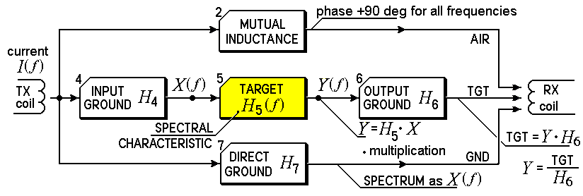

                            ... Note that the block 2 is simlifyed. It contains mutual inductance, ground and target. We should expand it in several blocks to show the convolution of genuine target signal made by ground.
                            The block 2 shown in post #11 is represented below in expanded form with several blocks.
                            The designations in block diagram are for Frequency domain to avoid CONVOLUTION.
                            There are 3 signall paths:
                            1. AIR signal. We obain pure AIR signal when the search head is lifted high in the air, far from ground. I think the term "AIR signal" is involved by designers of Coinmaster Pro, but I'm not sure.
                            The mutual inductance (represented here as block number 2) operates as an ideal derivator (differentiator). That means the AIR signal has phase led 90 deg for all frequencies. We can minimize the AIR signal with induction balance between RX and TX coil and compensate it with two controls (see block 8 in post #11).
                            2. TGT signal. It contains information for impulse response function of target h5(t) but convoluted with response functions of ground h4(t) and h6(t). This happens in time domain. To simplify analysis, we will use Frequency domain where the CONVOLUTION is transformed in MULTIPLICATION. That means TGT signal is product of frequency transfer functions H4. H5. H6 (point designates multiplication).
                            3. GND signal. This signal is suppressed (d) when we use induction balanced coil configuration and (b) when are used two RX coils connected as TWIN LOOP configuration.
                            Remains to analyse with Barkhausen criterium when the search regenerator will start to oscillate if there is deep buried target and how to design the target to make large change of oscillation frequency.
