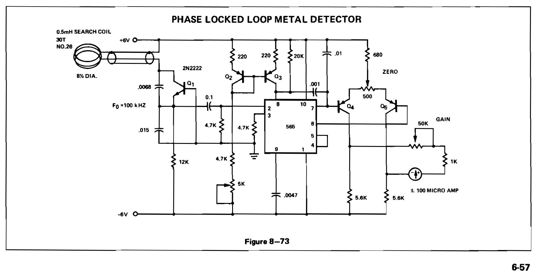

    To be bit off-topic here: Not exactly BFO, this one is PLL, from old Signetics data book, circa 1974, 565 chip is now obsolete, interesting just for historical reasons. Version of it was presented earlier, among old forum look MD schematics, this one is original. Just stumbled upon it in archive.

      There have been a number of variations of this idea presented over the years. For example, there is one in the Geotech Projects section by Kamil Kraus ->
      http://www.geotech1.com/cgi-bin/page...raus/index.dat
      He quotes a detection depth of 75cm, but this is completely wrong. The actual depth is more like 75mm.
      The sensitivity using this technique is very poor.
