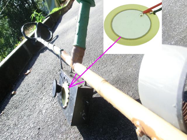

                  Davor, you do not need "incredibly rare headphones". Cheap and widely available piezo element will work very well:

                          I'm sorry davor, I don't have oscilloscope, its quite expensive here (at my country, eventhough a secondhand one). Well, if I cannot use a normal headphone, I'll just use piezo. In the schematic, it shows that a sounder piezo was used, is this a normal piezo like a piezo buzzer type? At here (my country), I can find only two type of piezo, one is piezo buzzer and another same as WM6 shows to us in picture in this forum. Which one I should use? Or I just use a normal speaker instead? And by the way, how deep this circuit will detect metal inside soil? Do you guys know?

                            So, can NE556 IC be used this project? Also, piezo tranducers - is this looks like in WM6 picture? Can this be replace by a normal speaker, say 8 ohm mini speaker?

                              Hi WM6,
                              Nice picture you have, is this the matchless metal detector project? or it it just another project? And, do you use a screen wire to attach the search coil?
