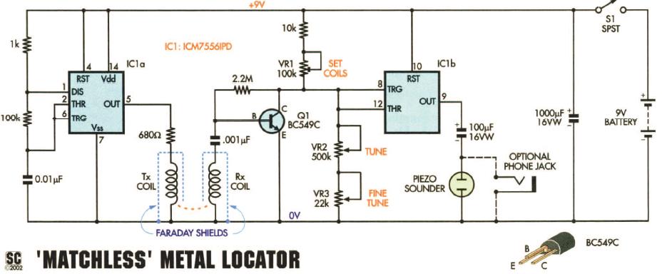

        hi Jap,
        This schematic taken in geotech website, the IC and the piezo sounder I can't sure I can find it here, but as you guys said try other type like NE556 etc. Also, the coil position almost make me confuse, do I need follow exactly as the author show (in picture, in the project article)? or do I need some calibration/reposition it? Any advice?

          Hi Gwil,
          So, can NE556 IC be used this project? Also, piezo tranducers - is this looks like in WM6 picture? Can this be replace by a normal speaker, say 8 ohm mini speaker?
          You can NE556,Also, piezo tranducers in WM6 picture.
          Can this be replace by a normal speaker-.....NO ,Can use headphones up 32 ohm

            Hi Jap,
            normal/standard headphone? stereo or mono type?
              Hi adiputra
              I haven't built this detector so I don't know for sure, but I can see one possible problem with using an ordinary 556 timer instead of the CMOS low power 7556. The input impedance of the comparators in the 7556 is many times higher than in the 556, and this may be necessary for successful operation, at least in the IC1b section.

                  Hi WM6,
                  Nice picture you have, is this the matchless metal detector project? or it it just another project? And, do you use a screen wire to attach the search coil?
                  Yes adiputra, it is photo of "Matchless metal locator" (as on schematic you posted).
                  As coil cable I use screened double microphone cable connected directly (without connector).
                  My piezo element is relative big of about 5cm in diameter with nice tone, not to high tone as on small one. Hot glued on housing.
                  According author TTL version of NE556 will not work - but I did not check this. Rod is out of bamboo.
                  This is an old construction and don't remember all details any-more, except that two different CMOS are working in the same way and that depth in soil was very poor (not to mean that you cannot achieve better results).

                    hi Wm6,
                    Ok, so in conclusion, do you think i should build this project or not - any advice/suggestion? and if I still want to continue to build this one, what are the suitable IC i should use? can you give some example of the IC - (as you use in your "matchless metal locator" in your picture)? According to your picture, may I know the depth it can detect metal in the soil?
                      I think it is worth to try to get some experience in MD design.
                      It is extremely well documented, which is very important (you see - even so, you have a lot of questions).
                      It is very cheap (you can burn one IC only in worst case).
                      It is good experience how to make and tune DD coil.
                      Yes, on depth it is shallow (at least mine - maybe yours perform better), but a lot of stuff you can find will lying shallow 1" or 2".
                      As IC use any CMOS version of 556, how your MD will perform, will be mostly on your coil construction and on quality of used earphone and not on IC brand name.
                      Try with smaller coil than mine first, say no more than 12cm in diameter (or as per author directions).
