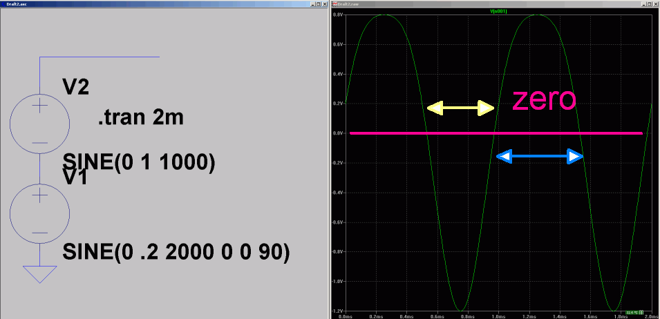

                  It almost makes sense in a system that is driven by a constant frequency. When such a coil that is within a tank is exposed to ground proximity effects, e.g. Δμ it's resonant frequency will go somewhere, say down. Because it is driven from a constant frequency source, it may observe some phase change if it is constructed as a loosely coupled filter, and it happens in a Rx front end with Frx > Ftx and high Z op amp input. With Rx we can not do anything about this phase change in a system driven by a constant frequency source, except lowering the Q. In Tx of such a system we actually can not observe such a phase behaviour because a parallel Tx tank is driven by a constant frequency voltage source, and a Tx coil, being clamped directly to the voltage source, has current constantly at ~90°, spoiled only by a coil resistance. In this configuration, a capacitor is placed in a tank simply to reduce power consumption, otherwise it has no influence on Tx operation. Provided you are happy throwing 0.5A with 300uH coil and without tank capacitor.
                  In conclusion, It is beneficial to have low Q in a Rx frontend, especially if Tx is a constant frequency driven coil. With Tx Q is irrelevant, unless it is ridiculously low so that power consumption goes through the roof.
                    at resonance - phase=0
                    oscillator supports phase balance and distorts the received signal -> noise from the ground
                      You lost me here. Phase exactness is a function of a phase shifter. In case it is supplied with a signal rich in 2nd harmonic, yes, it is exactly what happens in ground proximity, at diferrent phases, e.g. Geb and Disc, you have a completely different offset as a result of 2nd harmonic. See the picture, and just imagine what happens with a bit different 2nd harmonic phase. In such case a constant frequency oscillator is undoubtedly a better choice, but only because of the missing 2nd harmonic. Being voltage source driven, a Tx coil will always have u and i in almost perfect 90° relationship, and it is largely irrelevant for MD operation, yet marginally better if it compensates a Rx phase as an oscillator does. This advantage is completely lost in case of a Tejon-like Rx front end - it has negligible phase change because Rx Q is <0.5.
