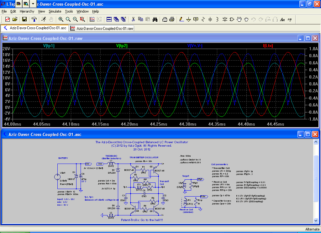

              • The Gift Day

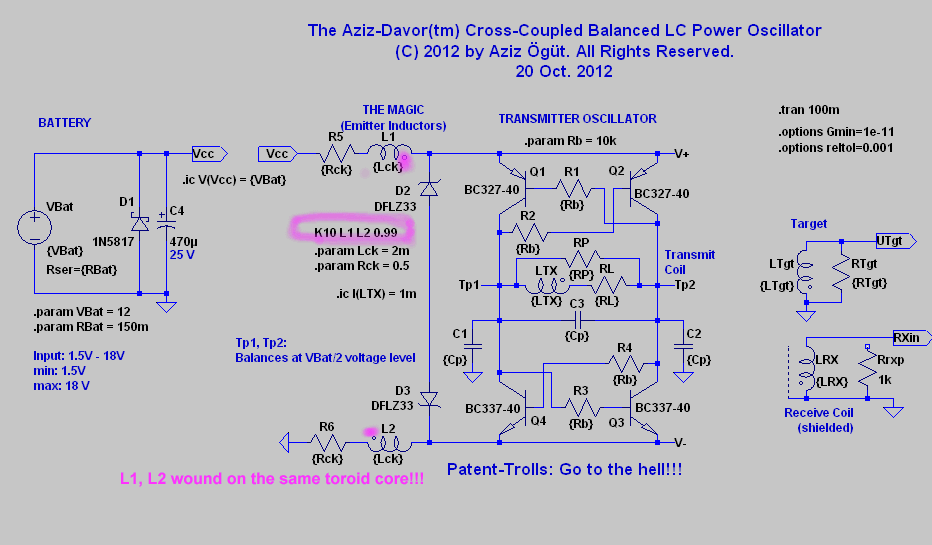

                Hi guys,
                I'm putting the legendary Aziz-Davor* Cross-Coupled Balanced LC Power Oscillator spice files for your convenience to play and experiment with.
                *Davor deserves it well as I wouldn't get so far without his valuable contribution.
                Note, that the inductors L1 and L2 (chokes) are becoming the emitter inductors/chokes. We need two chokes for best operation. And you shouldn't use low inductivity chokes for this purpose (high inductivity: best efficiency, best sine wave forms, best ripple rejection, etc. ) and they should be at least 1 mH each (Well, I'm using 2 x 2 mH or more) .
                Tp1 and Tp2 balances at VBat/2 voltage level and can be used as virtual grounds or references.
                Here is the schematics:
                Here is the spice files zip archive:
                Aziz-Davor-Cross-Coupled-Oscillator.zip
                Have fun playing with it.
                Cheers,
                Aziz

                      I did. I noted a somewhat odd 2kHz modulation going on, and concluded that it must be related to the chokes interaction with the tank capacitances. It disappears when Rck is raised to 10 so that must be it.
                        Yep, it's a typical startup process when the oscillator starts running and a high current is flowing through the inductors first time. Indeed, the inductors resistance (Rck) isn't critical and one can make the inductor with thin wire too (more Ohm). As there is less current flowing, the losses aren't that much.
                        Aziz
                        • *LOL*
                          If you change some parameters, you will get more bang at the expense of more power consumption.
                          L=50µH
                          RL=0.1
                          Cp=2.2µ
                          TX coil current: 9.3 A pp
                          Power consumption: 98 mA (1.17 W)
                          Almost all of the energy is burnt in the TX coils resistance (1.05W, ~90% of the input energy is burnt in the coil). But the transistors should keep cold (15 mW each).
                          I have found, that low inductivity TX coils (<50µH) have a startup problem (can't start oscillating).
                          Aziz
                          • Ok, more precisely: Low Q TX coils have a startup problem. And when the osc. isn't oscillating, high current flow through the transistors can cause overheating and damaging. If the TX coil isn't plugged, this isn't critical (almost no current flowing).
                            Funny, when playing a bit more with the circuit, it tells you a lot.
                            Aziz
                            • Played a bit more.
                              Result:
                              One toroid core required for the emitter inductors L1 and L2. Keep attention to the phase dots of the inductors. L1 and L2 can be wound bifilar like.
                              Cleary an improvement.
                              Aziz
