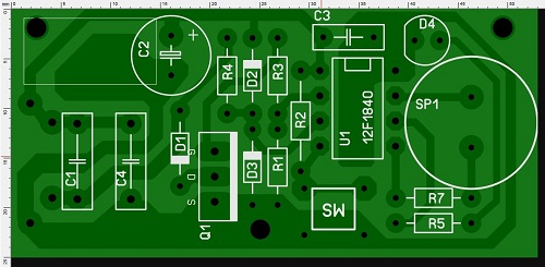

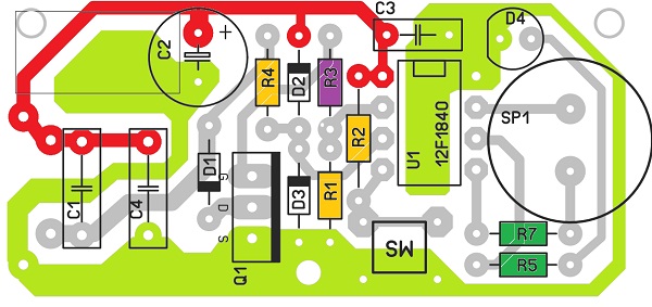

            Hi ApBerg

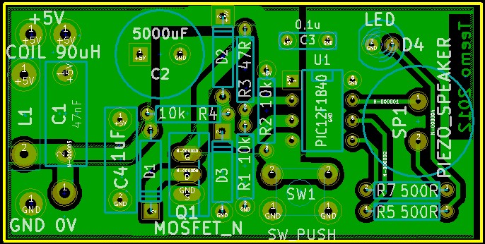

            I see you have redrawn the board. Nice! What software did you use?
            I made the board in kicad. I can share kicad files also. But I have no time tonight. I must investigate first what files and libraries I must include.
              Good job Ap on pcb
                HelloTeemo,
                Yes, it is a redrawn from your board in Sprint Layout. I like that drawing program.. it is easy to use.
                A copy from an existing pcb is easy to make. If you have a 'copy.bmp' from a pcb board you can put that ‘pcb-bmp’ as an under layer in Sprint. Then it is easy to place components and draw tracks over that “ copy.bmp layer”.
                When ready, to make a copy, the “copy.bmp layer” can be removed and so you have a “new” pcb that is free to modify and to adjust ....
                Another reason I like Sprint is that on my Canon printer it makes very good transparency sheets, if I select in the “canon printer- options” : high resolution paper / best print quality /only gray... it gives a perfect transparent that is good to use with my modified UV face browner and “UV pcb” board.
                Best regards and thanks again !
                Ap
                ...no I have no connections to Abacom...!
                I have not made the pcb... yet....so it may have errors!
                  Here is quick screen capture of my board layout:
