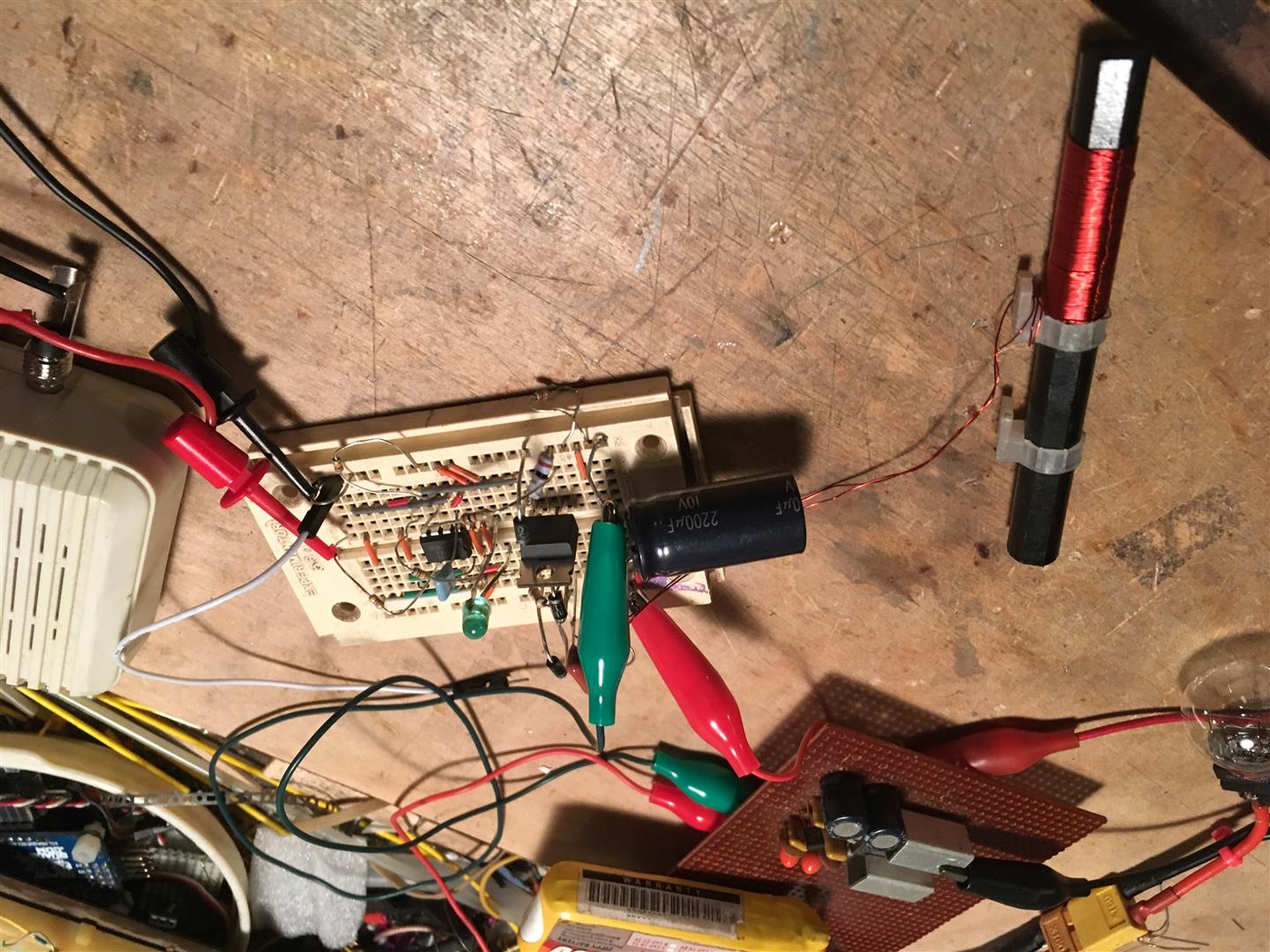

  • I built this circuit as a pin pointer using a ferrite rod out of an old AM transistor radio. Wound 80 turn #24 enamel wire of ferrite rod.
    Used the PIC12F1840 processor and the 1.80 source code. I did change the default 'mode' from 0 to 1 since this is the mode I found most useful as a pin pointer.
    This circuit/PIC code works great and makes finding a target in the ground much easier.

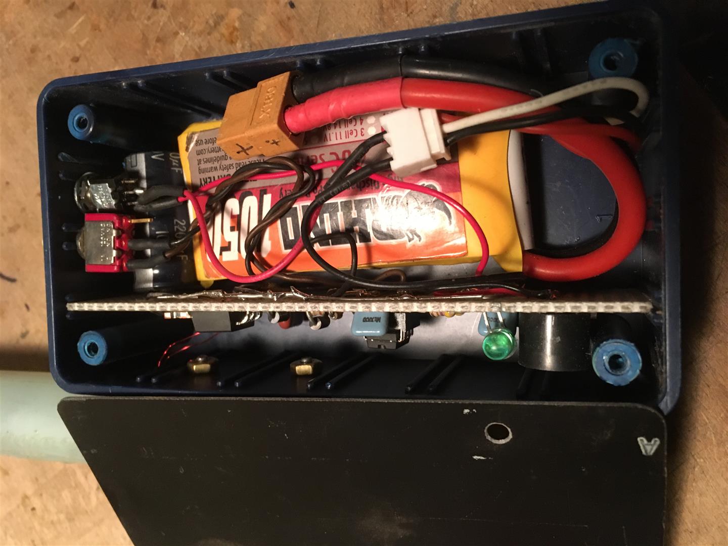

    I didn't have enough good NiCad or NiMH batteries and could not get it working with 3-AA alkaline batteries so added a 7805, TO220 regulator to run from a 2-cell LiPo (7.4V Nom). The circuit works BUT the quiescent current of the 7805 is quite high and will discharge a 1000mA-hr LiPo in a few days. This defeats the idea of putting the PIC into Sleep mode and required adding an ON/OFF switch. There are newer 7805 like regulators with much lower quiescent current so this may still work.
    First picture show the circuit prototyped on a plug-board and ferrite rod.. The large 2200uF cap is REQUIRED, else the PIC keeps resetting due to Voltage drop-out.

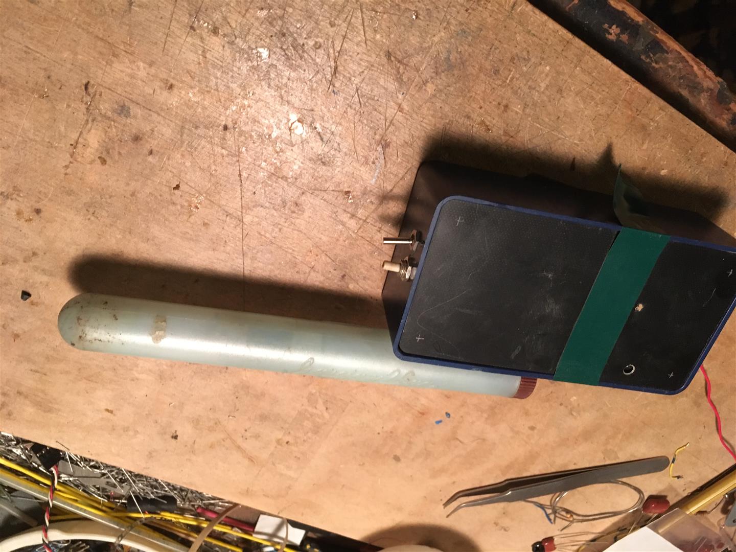

    Next pictures show the project and the point to point wired perf-board in a plastic enclosure. The ferrite rod is inside the plastic Cigar tube which is attached to the box with two screws. This makes a handy pin-pointer as the rounded cigar tube is easy to poke around in the dirt to find the target.

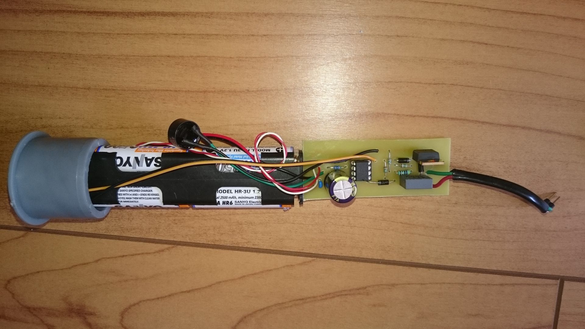

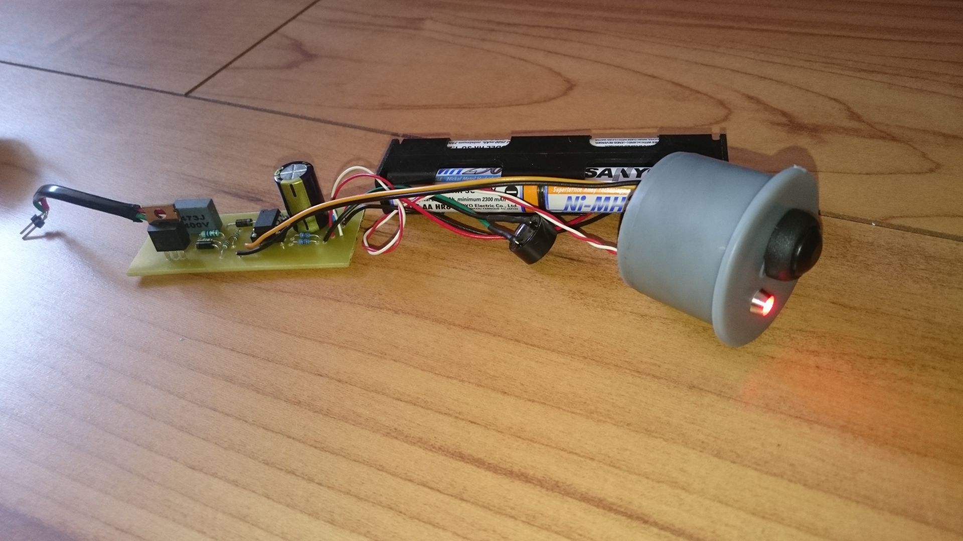

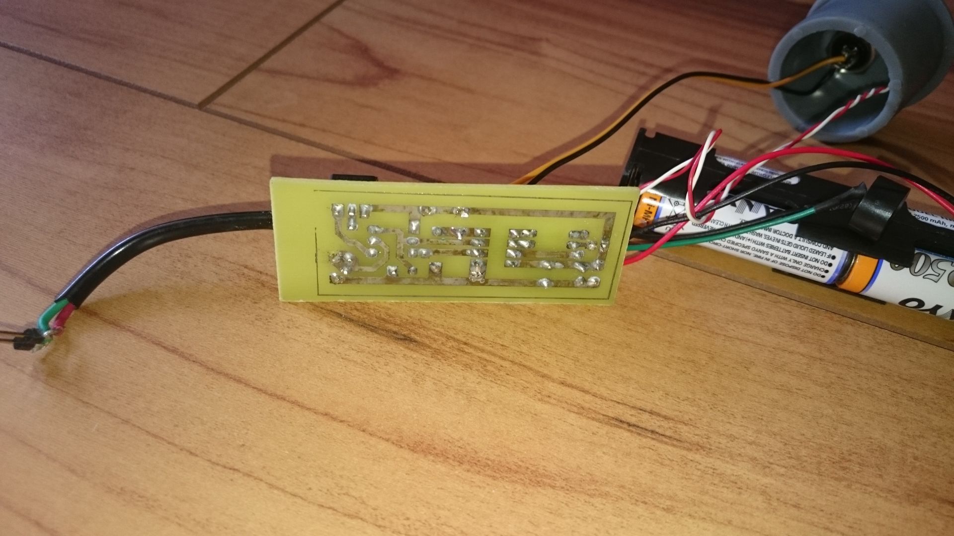

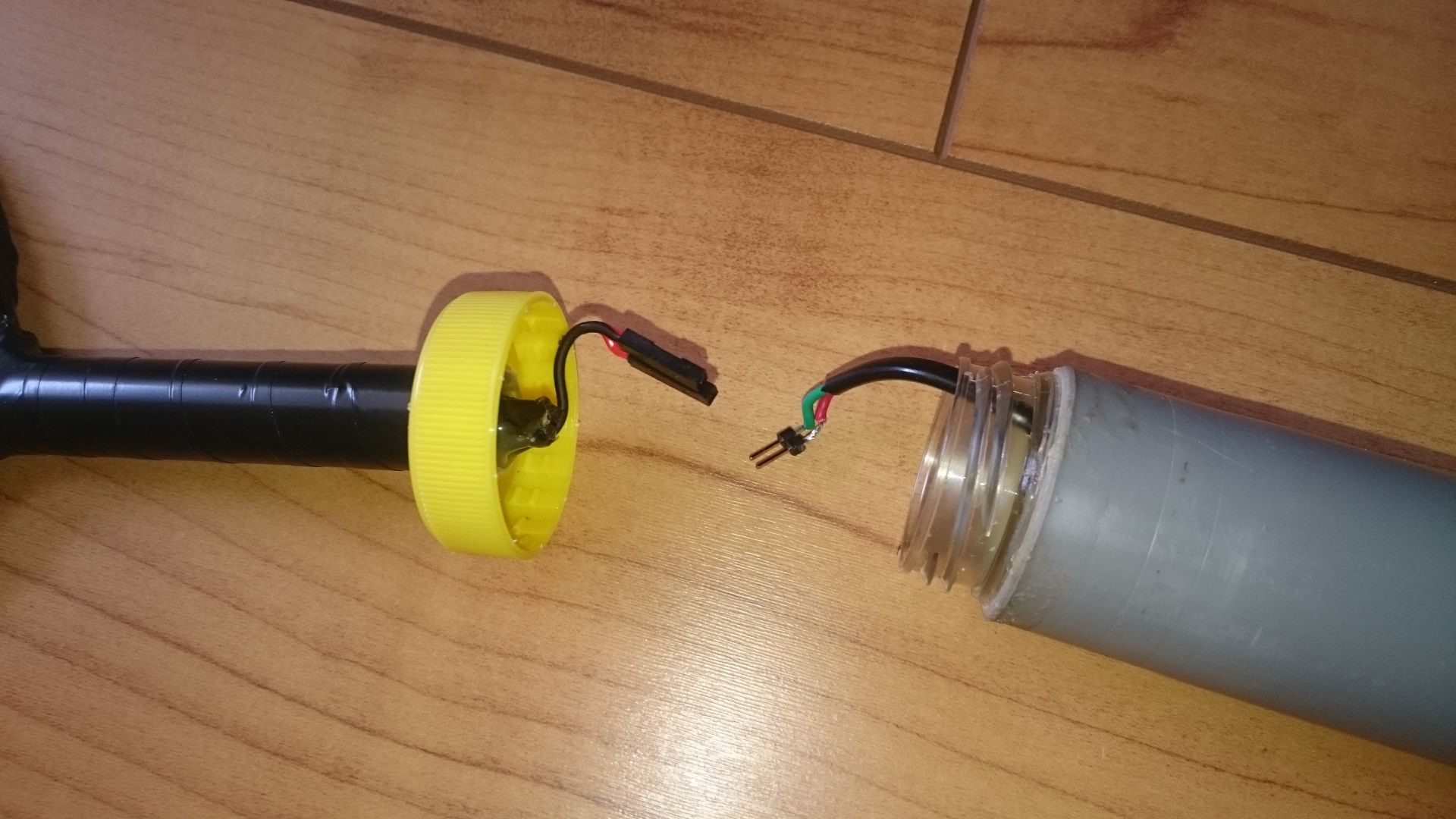

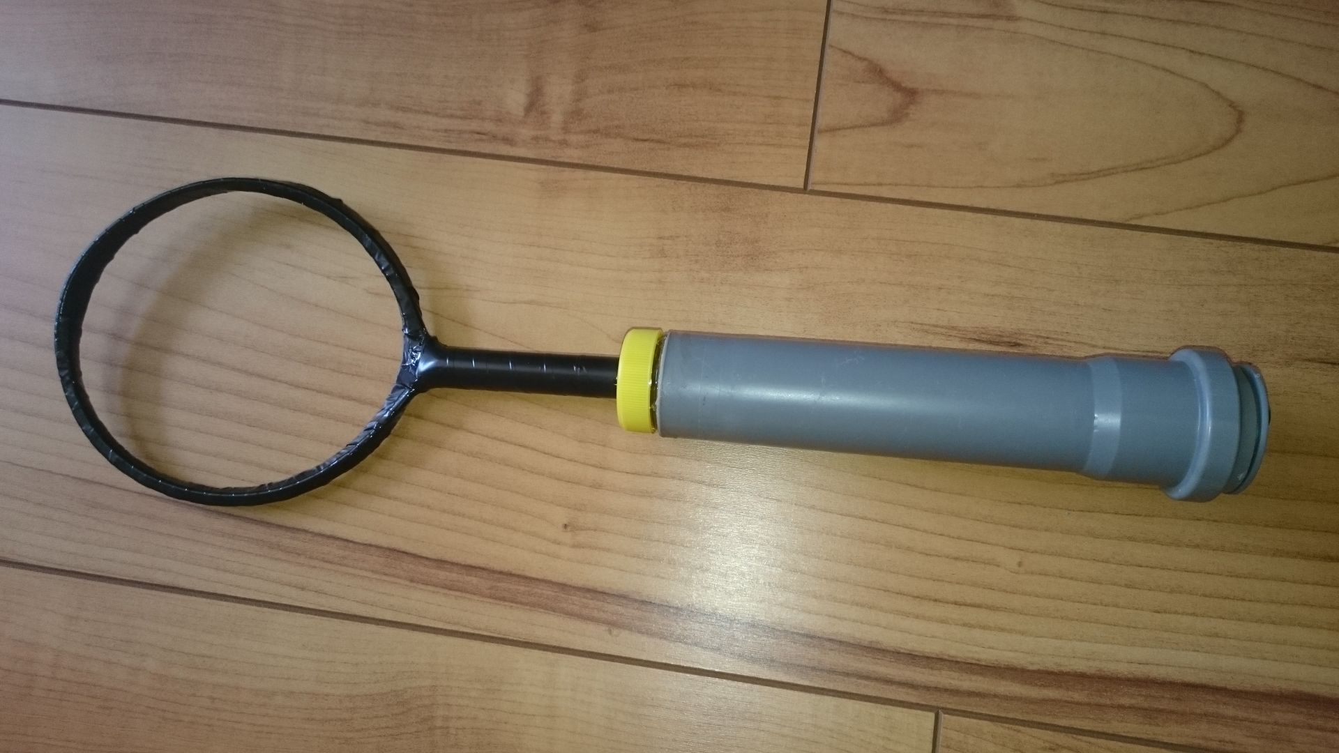

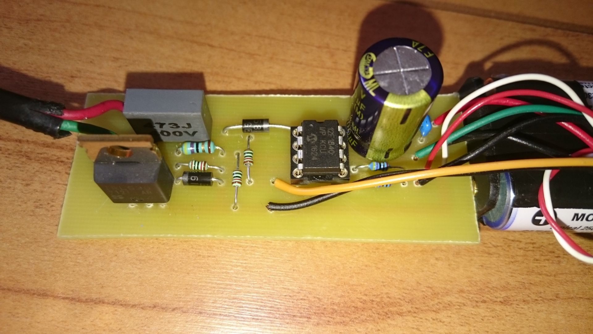

        • I modified the code for the 12F1840 PIC, now default Mainmode0 is distance indication.
          I use this circuit as a pinpointer. Coil is D=0,75mm enamelled copper wire, 30 turns, 0,6 Ohm, 175 mH. The body is made from drain pipe, bottle neck and cap. The head is changeable. I tried with bigger searching head, but not the best for treasure hunting without discrimination. Teemo wrote: "Ferromagnetic metal target objects decrease free oscillation frequency and non-magnetic metals increase oscillation frequency" So, when the program compare the result with the reference, and the frequency is decreasing, that means the metal is ferromagnetic, and it gives a high tone output. I tried modify this part and mute this sound, but no luck. I'm not a programmer.

              • The diameter of the coil is about 125 mm, I used DVD cake box as a form. I have good results, but only in my garden, because in my country treasure hunting almost impossible legally. Even in my garden is illegal... I think this pinpointer very accurate in soil.

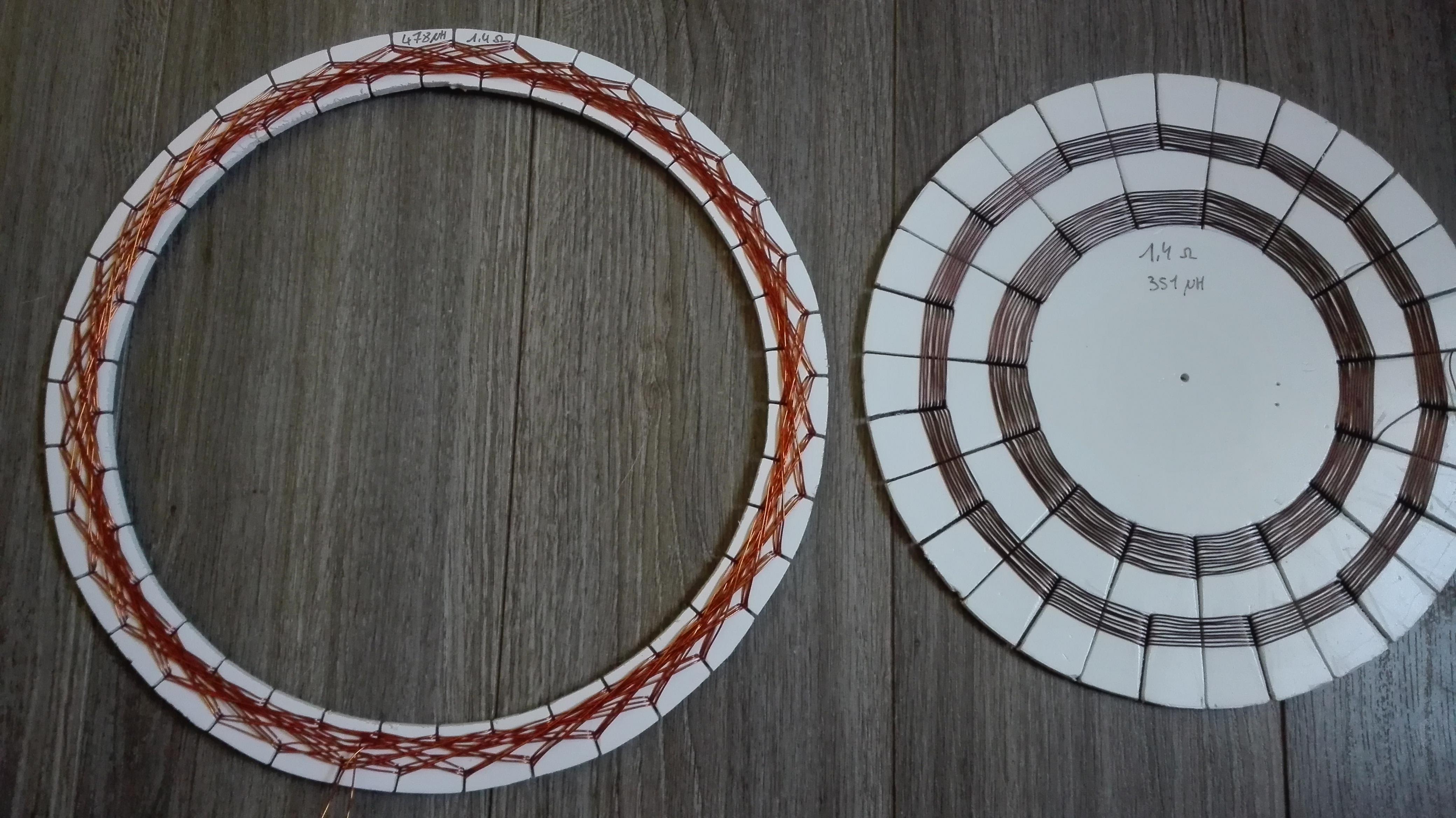

                          • Here is the air test with a 20cm spider coil (350uH).
                            The pitch becomes lower when a coin comes close to the coil, it should be higher ???
                            https://youtu.be/S2-BtTLF2VQ
                            • Originally posted by reptooyep View Post
                              non-ferrous object produces a Lower tone.
                              Ferrous a higher tone.
                              Try an iron/steel object then copper, brass, aluminum, lead objects.
                              • Oh, strange, i did not noticed any pitch difference with differents objects.
                                I'll test tomorow.
                                I have another coil to test with (the one from the video is the one from the right,
                                Tomorow, i'll test the other one
