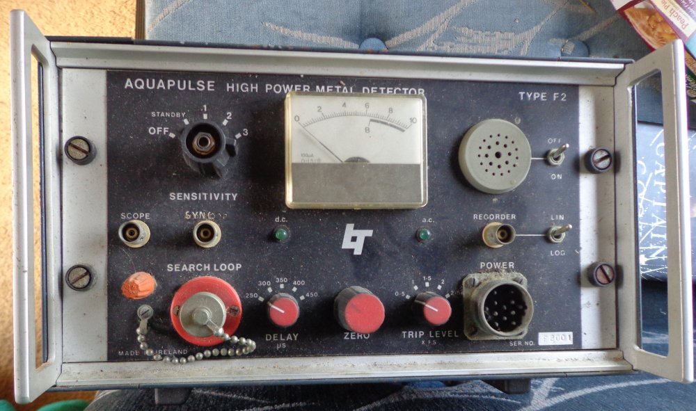

            High Power PI still in use after 32 years
            Not quite so ancient, but a pure PI built in 1981 for Mel Fisher in his search for the "big pile" of silver bars on the 1622 Atocha wrecksite off the coast of Florida. This detector can pulse 50A through a large coil towed on a sled along the sea bed. The detector electronics was housed on a survey boat along with its associated chart recorder. Power was 48V from marine lead acid batteries. Short delays were not necessary as the TC of a single bar was several milliseconds, and there was plenty of signal at the 250uS minimum delay on the switch. Sea water response was also minimised by this.
            This unit is still being used by the present owner, who was also involved in the Atocha search, and I will be furnishing him with some coil details.
            Many thanks to Mikebg for helping to re-establish this contact between the owner and myself.
            Eric.

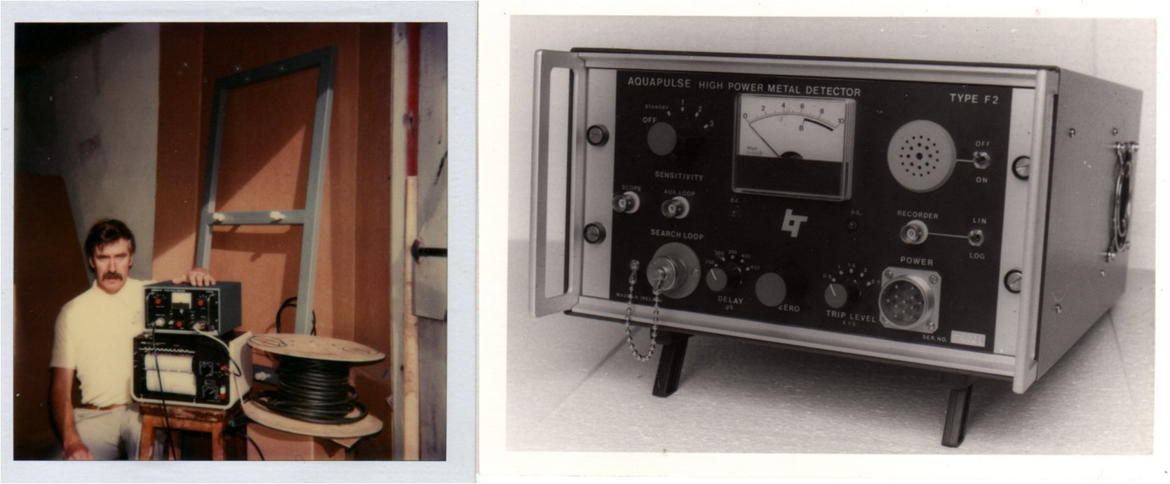

                Well it arrived back today after 32 years away. Looks like it will need some TLC but I gather it still works and inside looks good. Here are some pictures taken at the time in my Irish factory where it was made. I think I need an overhall too. Was my hair really that colour?
                Eric.

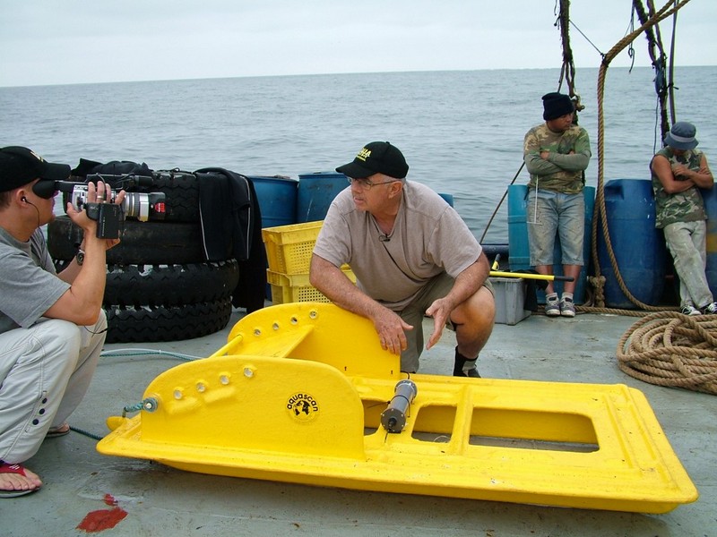

                  These photos are great. A pioneer in pulse induction and electronic shipwreck recovery.
                  You probably had your hands in this also

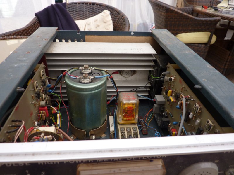

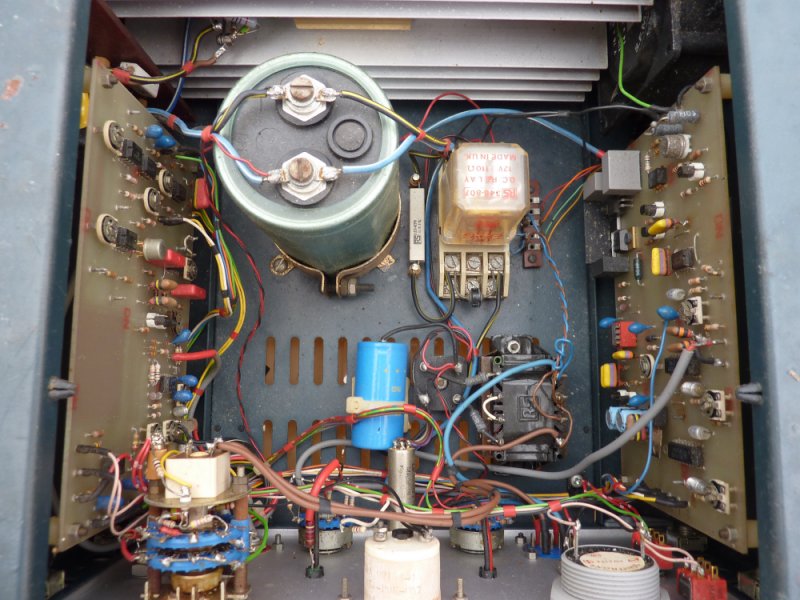

                    Not too bad inside. The 22,000uF TX reservoir cap dominates the scene, with big heatsink for 2N5883 driver and PT7505 80A power transistor behind (no mosfet power then). Heat extraction fan at right end of HS. Relay is to charge capacitor up slowly in standby position on front panel switch (avoids melt down of switch with 50V supply). Pulse generator and sample generator board to the right, and RX to the left.
                    Eric.

                      Nice pics, a true work of art (real electronic art!).
                      Obviously built to last!.

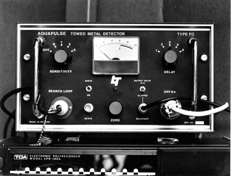

                                I'm sure other treasure hunting groups would have liked one, but Mel Fisher wanted the edge over others and one machine was part of the agreement. I did make a lower power version that ran off 24V and quite a few of those were sold. Ironically I threw out most of the manufacturing information a couple of years ago, thinking it would never be needed again. Luckily I found a few notes and part schematics in a notebook that escaped the purge. Picture of 24V AQ.
                                Eric.
