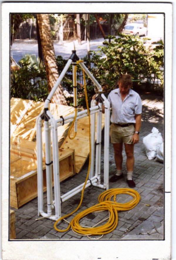

        I thought I had posted this yesterday - did anybody see it? Can't find it today so here goes again.
        This is the coil and sled made for the High Power Aquapulse. ABS pipe filled with special epoxy so that it is not bouyant. Nylon runners as wear surfaces. Demountable 42in coil. Planing device on cable ahead of the sled (not shown) which drives the cable down when towing so that the sled stays on the bottom.
        Eric.

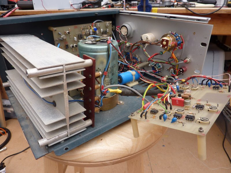

          This is the stage where a wire breaks off when you are not looking, and you can't see where it came from. Refurb on High Power PI going well and main pulse driver and sample generators functioning properly. TX pulse is 2mS wide. Delay adjustable between 150uS and 500uS as it is for large objects only. Seems strange to be resoldering joints that I last made in 1982.
          Eric.

            If it were possible, someday, make a reverse engineering of this device would be fantastic. I'm just dreaming a bit.
              I would forward engineer it, as I already know how and why it works. A modern version using the latest devices and circuit techniques would be quite straightforward and be at least half the size and weight. You would still struggle with the power supply though; 40 - 50V at 5A. OK on a boat with marine batteries, although you do need a dedicated set to avoid alternator noise.
              Eric.

                  Hello Eric, you're right, with the techniques and current components, we can greatly improve the circuit, is that I have a passion for the "vintage" and I also believe that the greatest difficulty of a powerfull detector is the power supply and circuits related.

                      Hello, Eric, you have more information about this "monster coil". Inductance? maybe resistance?
                      • Thanks to Eric for sharing this usefull information.
                        I think "monster coil" have inductance under 2mH, and resistance a little under 1 ohm.
