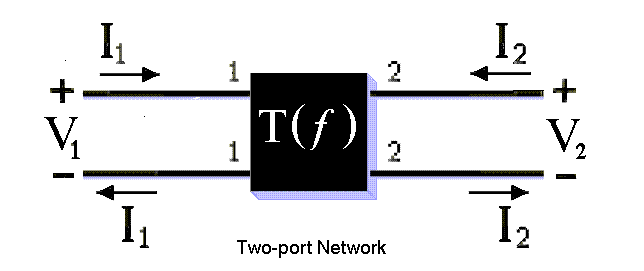

      I will start with the answer of first question using the attached image. The block represents sensing system of a metal detector. Notation T(f) means transfer functions in frequency domain (the network is described by a 2 by 2 square matrix of complex numbers). Please read in Wikipedia for Z-parameters, Y-parameters, H-parameters and G-parameters,
      The forward transfer function is mentioned in a lesson attached in the post:
      Inside the black box are connected in series 5 stages: TX coil, ground, target, ground and RX coil.

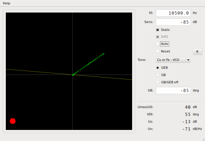

        I would also like to get a user's reference to all the other items shown on his display as shown in a picture near the bottom of the page. In particular the following:
        f0
        Sens
        Static
        Diff2
        Auto
        Reset
        R
        VCO
        Umax/U0
        VDI
        Us
        Un
        Also, your interpretation of what is being graphed on the left.
        I'm running a later version of that same program. The only thing that has been changed on the display is 'auto' has been changed to 'auto comp'.
        If anybody else can give opinions on what each of these mean, I would appreciate it.

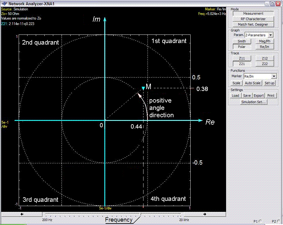

          COMPLEX PLANE
          If someone has downloaded the file
          "NI_Multisim_Analog_Devices_Edition_10_0_1.exe ", he can see the NETWORK ANALYZER. It represents complex plane as shown below with axes Re (real) and Im (imaginery). However there are publications where the axes are denoted as I (inphase) instead Re axis and Q (quadrature) instead Im axis. Other notation is R (resistive) instead Re axis and X (reactive) instead Im axis.
          The axes divide complex plane in four quadrants named as shown in image.
          A point placed in complex plane represents the value of a function at given frequency. There are a slider and two keys for movement of marker (change of frequency). Here a triangle marker is used instead point . The position of point M in complex plane can be expressed in rectangle coordinates (Re, Im) or in polar coordinates (magnitude and phase). The phase angle is measured relative to Re axis.
          The pont M placed in 1st quadrant has positive Re coordinate and positive Im coordinate or its argument (phase angle) is between 0 and 90 deg. The position of point M is expressed as Re + jIm. For the given example, the marker M at freqency 5024Hz is in position 0.38 + j0.44. To express marker position in magnitude and phase, you should press a small key with triangle symbol on it.
            Mike,
            I think that your phasor/vector description is the correct description of what the fat green green line is in the display of the above metal detector program written by Alex Zorg. Thank you for your description. It cemented into my mind what I was heading towards.
            What I don't know yet is what is represented by the thin yellow line that goes across in the above picture at a slight angle to the X axis.
            By the way, the X axis can also be thought of as the Sin Wave component of each wave and the Y axis as the Cos component. Alternatively, they can be just described as the X component and the Y components. For me, it is too many years since I studied complex maths (use of imaginary numbers) without ever having used them for me to feel comfortable with them although I feel OK with phasors/vectors but I just don't think of them as using imaginary numbers.
            I'm slowing trying to take the maths I have learned relating to metal detectors and then document it in ways that don't require the use of imaginary numbers. Some of my descriptions are probably a lot longer because of it, but I think that a large number of people who like myself don't use imaginary numbers in ordinary day to day work, will find my descriptions easier to understand.
            Happy New Year
            Ken

                Oh, by the way, another name for the two axis are calling them the 'Inphase' axis and the 'Quadrature' axis. This seems to be used in some University type Metal Detector Research Papers.
                Ken
                  Ken, please read my posts carefully. This is explained above in the post # 19.

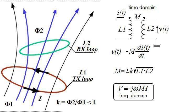

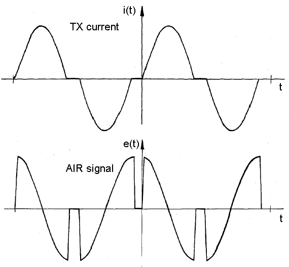

                  AIR signal in time and frequency domains.
                  When search head is lifted far from ground, it generates AIR signal. There are no target and ground inside the black box called "two-port network" or shortly "twoport" shown in post #17 . Inside the box remain only TX and RX coils.
                  The AIR signal is caused by mutual parameters between TX and RX loop. Using suitable shield, we can suppress action of mutual resistance Rm and mutual capacitance Cm. To suppress action of mutual inductance M we need induction balance. The attached figure illustrates the concept of mutual inductance. A part Ф2 of the whole magnetic flux Ф1 generated by TX loop, appears linked with RX loop. Mutual inductance M is the concept that the current change in one loop induces electromotive voltage in another nearby loop. Shown is what means coefficient of coupling k.
                  The EMV induced in RX coil is expressed in time domain and in frequency domain. Mutual inductance has sign + or minus depending on what lead of RX coil is connected to ground. Mutual inductance is positive at connection shown in circuit diagram. Sign minus is according Lenz's rule:
                  “Whenever a change in magnetic field occurs, an electric field is generated to oppose the change.”
                  Below is shown a TX current and its derivative.
                  What happens in frequency domain?
                  Instead derivative of TX current, we have multiplication by jω. Letter j means imaginery (quadrature) part, ie the frequency transfer function generating AIR signal consists only of imaginery part.
                  The angle frequency ω has dimension radians pro second; ω = 2πf, where f is periodic frequency masured in Hz (Hertz has dimension periods or cycles pro second). The formula shows that
                  The AIR signal is proportional to TX frequency.

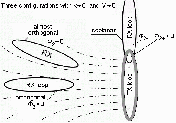

                      IB : Ф2 = Ф2(+)+Ф2(-) = 0 =>
                      => k=M=0
                        Originally posted by Sergey_P View Post
                        to be continued ->
                        => k=M=0
                        or simply Ф2 --> 0 at orthogonal and "almost orthogonal" configurations:

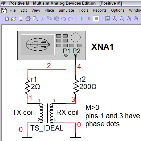

                          AIR signal at positive mutual inductance

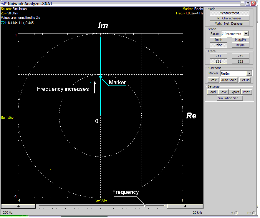

                          The AIR signal in complex plane
                          The simple two-port network shown in post #21 represents the sensing system when there is no ground and no taget.
                          http://www.geotech1.com/forums/showt...389#post163389
                          Here is the network analyzis. The analyzed parameter is Z21 (voltage induced in RX coil vs current through TX coil).
                          The marker is set to a frequency almost 10 KHz. The Re component of Z21 is almost zero.
                          You can press a key to show Z21 as Magnitude and Phase and move frequency between 200Hz and 20 KHz.

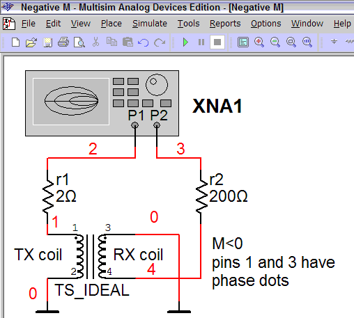

                              Let we analyze the negative mutual inductance or M<0. Here is the network connected to analyzer.
