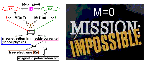

          Sergey, M=0 is an impossible mission.
          Despite this, I have analyzed your suggestion before years:
          To suppress AIR signal, we should analyze how it is generated.
            M= zero or constant ... does not matter ... it has no effect on Re, Im target!

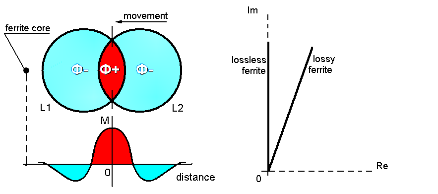

                        We know that ferrite core increases magnetic flux. Let we see what happens when an induction balanced search head moves over a small core made of lossless ferrite as illustrated below.
                        Both coils L1 and L2 are in induction balance because the positive flux Ф+ (shown with the red area) is equal to negative flux Ф- (shown with the blue area), When the blue area of search head appears over ferrite core, the search head generates signal as negative mutual inductance M<0 shown in post #36 . When the red area is over the ferrite core, the search head generates signal as positive mutual inductance M>0 shown in post #27 .
                        The diagram below represents how changes virtual mutual inductance M when search head moves.
                        CONCLUSIONS:
                        1. The generated by lossless permeabilty signalis are as AIR signal at positive mutual inductance.
                        2. The induction balanced search head has zones with reverse readings.
                        The theory shows that the lossy ferrite has Re component proportional to frequency. That means the phase lead of lossy ferrite is less than 90 deg as is illustrated on the diagram.
                        Small iron meteorites and small hot rocks generate signal as small ferrite core.
                        What happens when we have a large ferrite core as halfspace? It increases both Ф- and Ф+. Therefore, the induction balanced search head can suppress the signal genrated from magnetic soil.

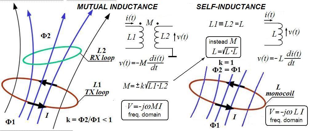

                          MONOCOIL or self-inductance is specific case of mutual inductance when k=1 because Ф2 = Ф1. The formula for M
                          becomes M = L. Note that M for MONOCOIL is always positive. That means the AIR signal should have positive Im
                          component as shown in post #27, but we should analyze this with SPICE.
                          Unlike induction balanced search head, the MONOCOIL has no reverse reading. It has a lot advantages, but a
                          disadvantage makes MONOCOIL not suitable even for BFO metal detecors. Monocoil generates the largest AIR
                          signal.

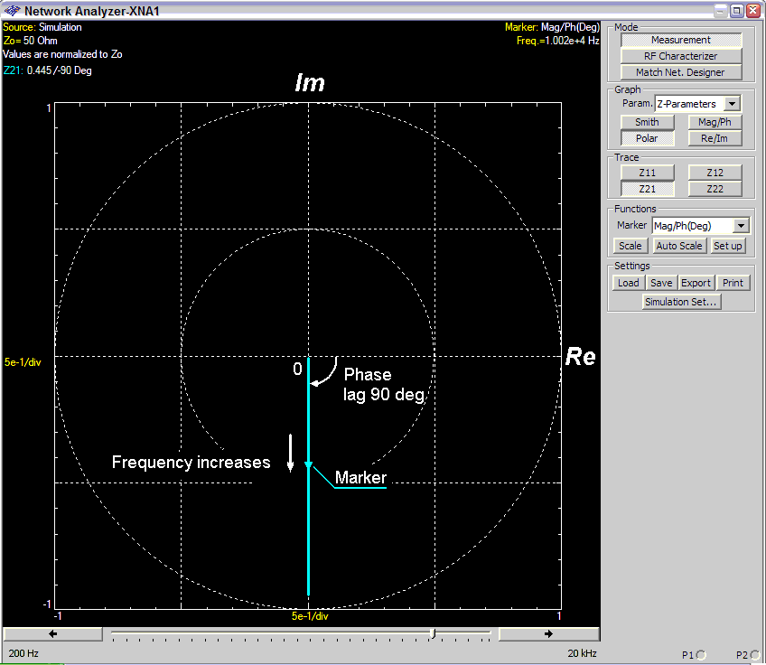

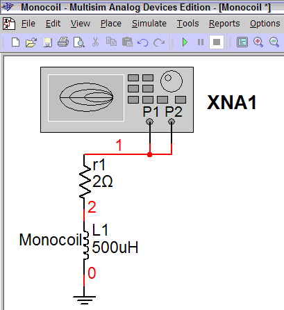

                          Let we connect a MONOCOIL to NETWORK ANALYZER as shown below.

                            So, finally, that elusive AIR signal in IB coil is actually signal due to coil disbalance. But coils can produce disbalance signal in both phase directions referenced to TX, (negative mutual inductance?!?) and ferrite may or may not generate signal of opposite polarity to it. I hate computer sims.
