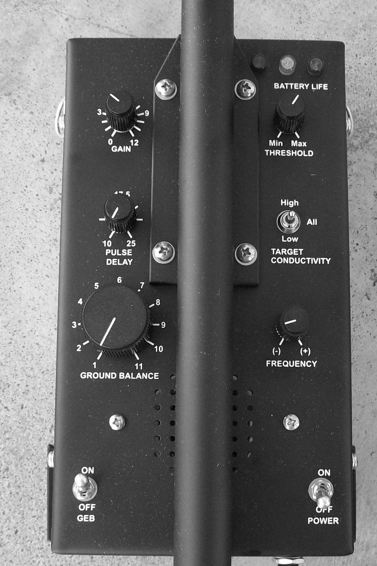

i have another one battery. Tommorrow i will charge it and i"ll give another one try!!!!
. I restored the GB as the prototype (one potentiometer) and now works fine. I don't know if the noise was from the potentiometer of from the cables or from both. Maybe one other time to make again the experiment and to try to solve this problem. Now it detects the gold sovereign with Gb=10 and delay=10 from 20 cm with low tone (as high conductive). Next month i"ll go again for test at the friend with the 45 buried gold coins. Also i will try a sovereign and a Caesar to see if they can detect the mystery coins. Of course i will inform you.
for your help especially the Reg
