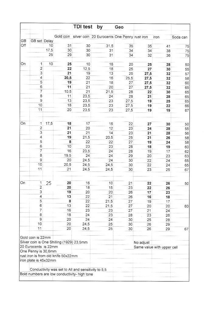

ID:	337129 .....concrete ? !
    • #77
      [ATTACH]25616[/ATTACH] .....concrete ? !
      What do you mean???
      • #78
        Here are the results when the detector is correct ?I know that was defective if I understand ,and I think each detector it does not matter who ten devices the same name TDI can be or any gpx3500 does not matter ,between ten there are slight differences . means the whether this test can be a a landmark for Whites TDI that's what I think ,thank you Geo !
