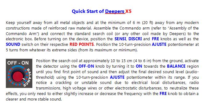

                          • #73
                            When the delay under 25us, there is a problem with wet soil, when PI detector used in the field, forest ...
                            Problem with ceramics ("Roman bricks") and wet soil, there in the first 15cm...
                            The Deepers Detectors (8AT, 10DD, X5...) that was solved the holding coil at a height of 10cm-15cm from the ground...
                            Here's an excerpt from it manual Deepers X5 (that does not have ground balance):
