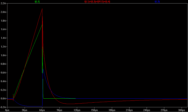

        I think we perfectly agree so far. Below is another simulation, this time it is an attempt to simulate a FE target.
        I changed the TX to 50us, so that the blue target trace with a TC of 10us gets 5xTC, TX ON time.
        The red target trace should represent a FE target. I would appreciate your opinion if this is an acceptable approximation of what it should look like.
        Next I will do the short, high voltage pulse. I will try to calculate the same amount of joules into the coil, to keep some constant.

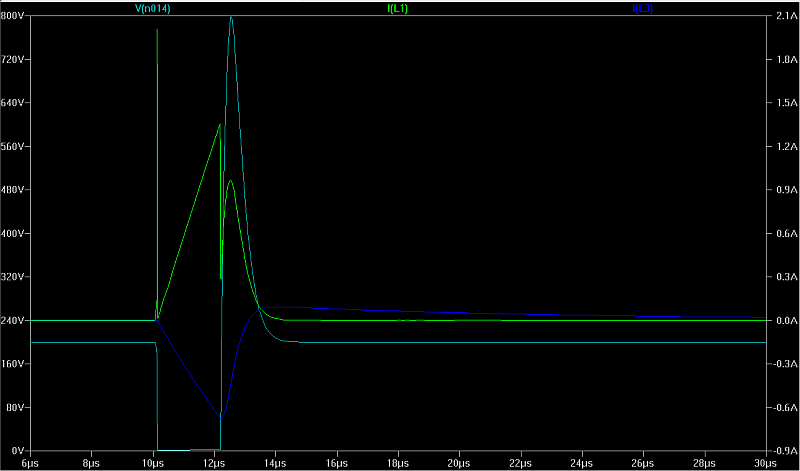

          Below is the closest quick simulation of the 2us pulse. I could only use 200V, because I have no Mosfet over 800V. Even like that, the Joules in the coil are many times more.
          Using the same coil, 300uH, 200pF stray capacitance, 0.5R, the problem is with the stray capacitance. the resulting target response from the same 10us TC target is much lower that by conventional pulsing.
          Using the TEM TX method, we use a short, high voltage TX and a long slow charge ramp. Maybe this is a better approximation to a very short TX pulse.

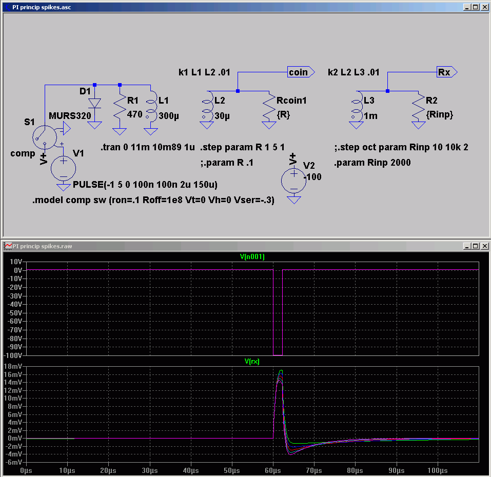

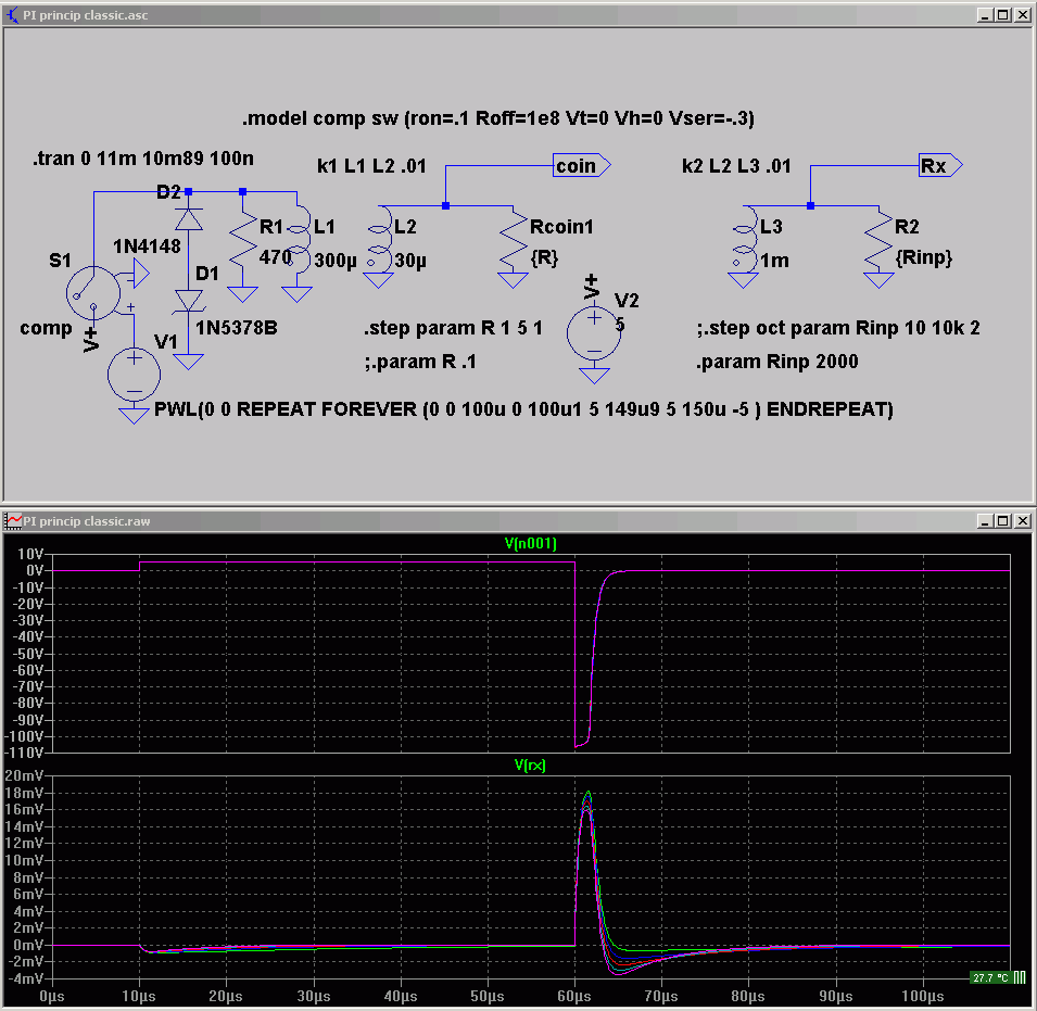

              PRO FLYBACK. Are you saying that if you pulsed a coil with, say, just a 2uS 500V pulse, then that is a good as a long low voltage (100uS or more) conventional pulse that generates a 2uS 500V flyback anyway?
              Yes.
              There are caveats though. There is no way that current will just stop flowing with no apparent reason, so the end result, observing from a coil current point of view, is a triangular wave. The advantage is that a Tx coil is at a very low impedance all the time, thus not influencing the target response at all, and energy losses can be negligible.
              It just can't work as a monocoil ...
              A first example is a simplified classic flyback PI:
Name:	PI classic.gif
              And the other one is an equivalent voltage spikes generated one:
Name:	PI spikes.gif
              To be fair and square to both cases I used a kind of IB topology, but also a parallel resistor in spikes case (which basically does nothing).

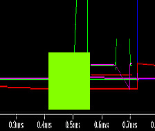

              • #52

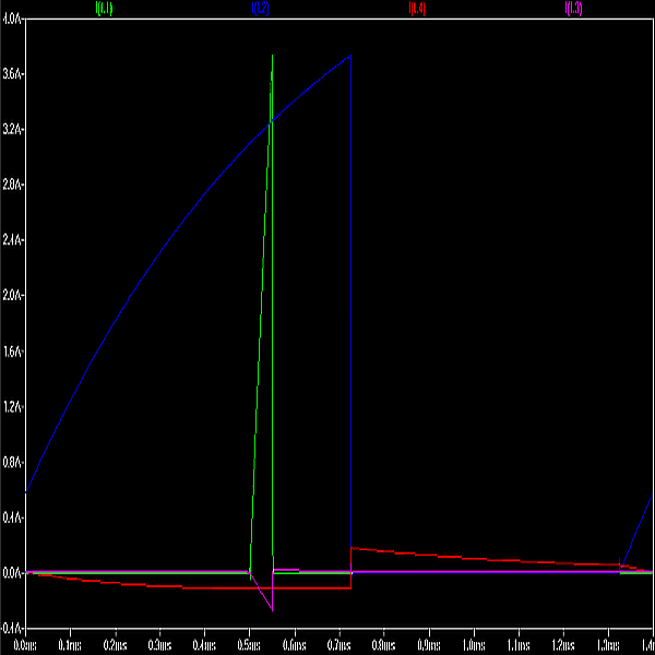

                Here is the short and long simulation.
                Same coil, same target of 500us TC
                Same TX amps
                The blue trace is the long TX
                The green trace is the short TX
                The red target response is from the long TX
                The pink target response is from the short TX
                Quite clear I would say
                • #53
                  Same TX amps
                  OK I'm not exactly sure whats clear but I'll have a stab. What I see in your sim is that the difference between the TX on sample and peak fly-back response sample is the same either way. However you have a lot less time to sample the peak with the shorter on pulse so I guess that means a crapper SNR. But then of course you can pulse more frequently and probably make it back. Hmm yes.. not super clear... not to me anyway.

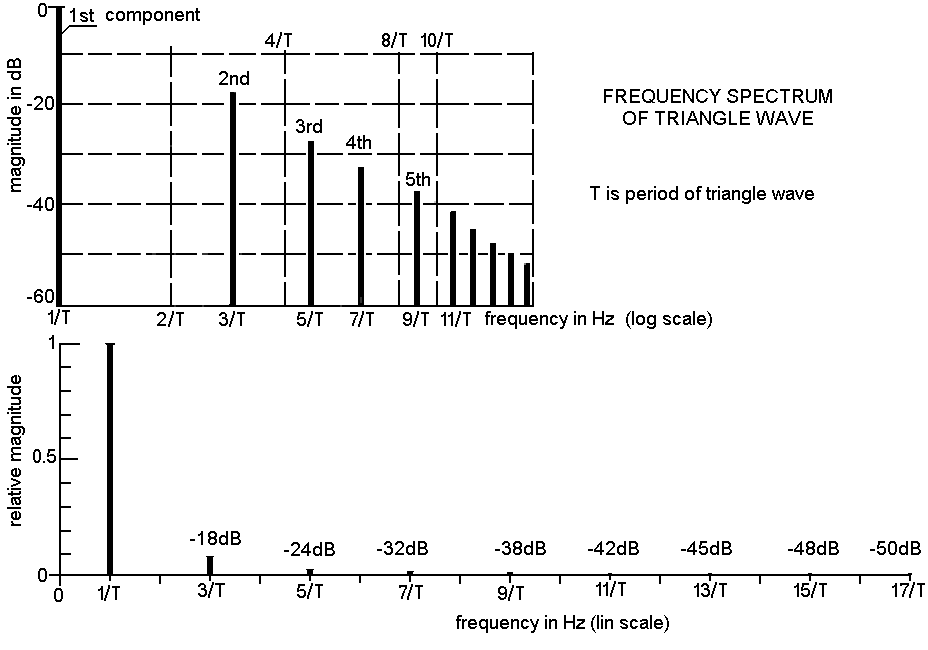

                    Freuency analysis illustrated in post #31 showed that triangular wave technology is not efficient for WB (wide band or PI) metal detectors because harmonic components have low amplitudes and are placed in large frequency distance.
                    However as a bad educator, in post #31, I use dB scale for amplitude comparison where visual differences reative
                    to amplitude of fundamental frequency seem small, and log scaled frequency axis where visual distances between
                    frequencies of harmonics also seem small.
                    Here below is given for comparisn the drawing which is more suitable for educational purpose. Both axes are linear.
                    What next?
                    Can you tell which form of TX current is most inappropriate for the WB metal detector?
                    HINT: It looks very much like a triangle wave and in radio ingeneering is called CW (continous wave).
