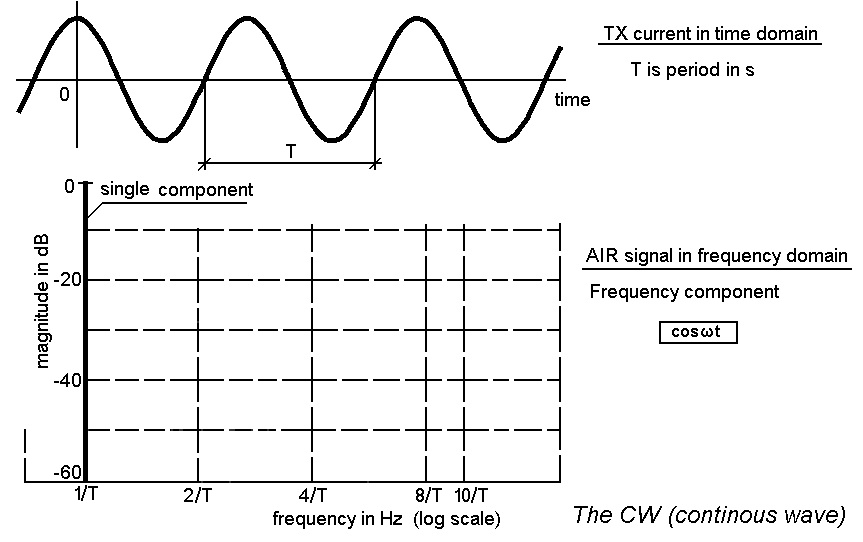

      SINE INDUCTION METAL DETECTOR
      What next?
      Can you tell which form of TX current is most inappropriate for the WB metal detector?
      HINT: It looks very much like a triangle wave and in radio ingeneering is called CW (continous wave).
      SINE INDUCTION
      Below is attached the answer.
      Despite time domain is not used in my hobby, I see how a synchronous demodulator (in a VLF metal detector) samples this waveform in T/2 windows.
      The next question is:
      How to distort the sine waveform in order to obtain frequency spectrum like trapezoidal waveform?
      HINT: See figures of patent mentioned in post #54.
