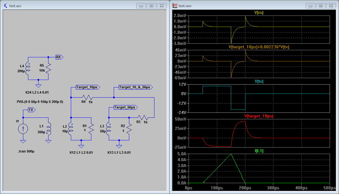

        Below is a simulation with a 200µH TX coil and two targets, one with a TC of 10µs and one with 50µs. Peak current is 5A. From left to right:
        (A) 100µs/10V driving pulse, 2µs/500V flyback pulse
        (B) 2µs/500V driving pulse, 2µs/500V flyback pulse
        (C) 2µs/500V driving pulse, 20µs constant current (5A), 2µs/500V flyback pulse
        (D) 2µs/500V driving pulse, 100µs constant current (chopped, mean value 4.75A), 2µs/500V flyback pulse
        Results:
        (B) Produces a very weak response for both targets, much lower than (A)
        (C) The response of the 10µs target is already better than (A)
        (D) Both targets have a higher response than (A), especially the one with the longer TC
        Any eddy currents caused by the driving pulse that are still present in the target at the time when the flyback pulse starts will reduce the response. Provided that driving pulse and flyback pulse are time separated by several target TCs, the amplitude of the target’s response after the flyback pulse depends on the following two factors:

                    Tinkerer, I just wanted to explain what is causing the target response, and how the pulse lengths and the pulse sequence affects the amplitudes in a conventional PI.
                    Of course the TEM method is better in terms of efficiency. However, don’t forget that it is possible to recover a good portion of the energy in a conventional PI. This could be 75% or more if the coil has a low DC resistance and the cc phase is not too long or not present. Also, there are a lot of applications where only mono coils can be used.
                    I think you missed one simple option here, a voltage drive.
                    I don’t see your point … there are short pulses of 2µs/500V/5A, but only the current is plotted.
                    don't look at the induced current in a target. Look what comes back to the receive coil.
                    We have essentially the same curves at the RX coil regarding shape and relative amplitude, but with a TX voltage offset. So for explaining the target response, the pure target eddy currents are more suitable. Here’s a simulation showing identical curves for the RX voltage V(rx) and the target eddy current V(target_10µs) with some V(tx) offset added:
                    Thomas

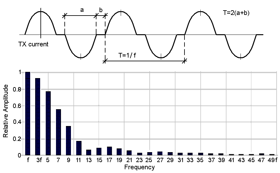

                                The next question is:
                                How to distort the sine waveform in order to obtain frequency spectrum like trapezoidal waveform?
                                HINT: See figures of patent mentioned in post #54.
                                This is the answer for question in post # 62:
