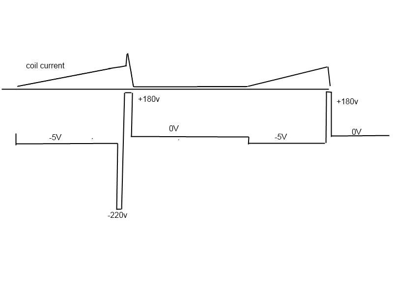

    Hi Guys,
    Brainwave
    So we see that the turn off di/dt slope cancels the eddy currents from the tx on time. So what if we pulsed the coil in such a way that the turn off di/dt canceled all of the eddy currents in a larger target so after the turn off di/dt current slope there were no(close to none) eddy currents left in the target? Ground response would still be there. Then this ground response could be subtracted from the ground/target response from a normal pi pulse...... This would not work so well for small targets, but I'm sure something could be adapted and arranged to work for the smaller targets
    cheers Mick
    • #92
      Here's a picture of the tx current/voltage waveform that could possibly do the job to cancel eddy currents in large targets and keep the ground response equal after both of the "tx periods"Click image for larger version
Name:	anti eddy current pulse.jpg
      Cheers Mick

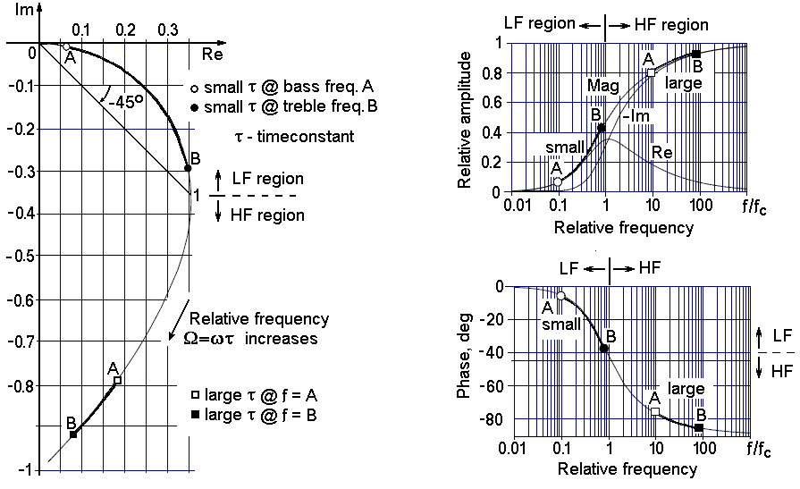

        Mick, why are you trying to answer these questions with TIME DOMAIN? Everything in this domain is shrouded in the mists of the mathematical operation CONVOLUTION.
        The analysis should be done in FREQUENCY DOMAIN, where all signals are processed by multiplication and division. Here's the visual answer to your question with normalized locus. Frequency domain shows what frequency spectrum you need to identify small targets. The explanation of diagrams is given in other thread:

                        I can't agree with convention that "salt water" is 0 degrees. The GND signal at salt water has significant phase lag relative to phase of TX current even at extremely low frequencies (below 3kHz). To decrease magnitude and phase of salty GND signal, Eric Foster reduces diameter of TX loop for beach combing. The timeconstant of salt water (conductive halfspace) depends on square of TX coil diameter D:
                        I also can't agree with your term "high conductors". More suitable is to say targets with "large timeconstants" because the timeconstant depends on square of target eddy diameter:
                        The diagram in post #93 is valid for two pieces of copper or two nuggets with 1:5 eddy diameters. Note how large are phase differences despite both targets are made of the same metal.
                        Most suitable for phase test is a ferrite core because the phase is independent on frequency. It generates signal with phase lead 90 deg for all frequencies.
