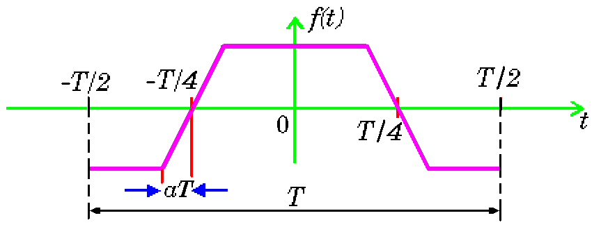

        Start to design "WIDEBAND METAL DETECTORS". The term is from Frequency domain, where metal detectors are two types only: narrow band and wideband (MINELAB uses term "BROAD BAND": BBS, FBS, FBS2).
        It is time all professional designers of "time domain" metal detectors to use Frequency domain for AC analysis and design.
        Before to start special thread for AC analysis of WIDE (or BROAD band) metal detectors, I will pont a link for Jawa applet.
        FOURIER SERIES APPLET
        When "a" changes from 0 to 0.25 the signal changes from a square to trapezium and triangle wave.
        You can control the applet to see how frequency components change.
