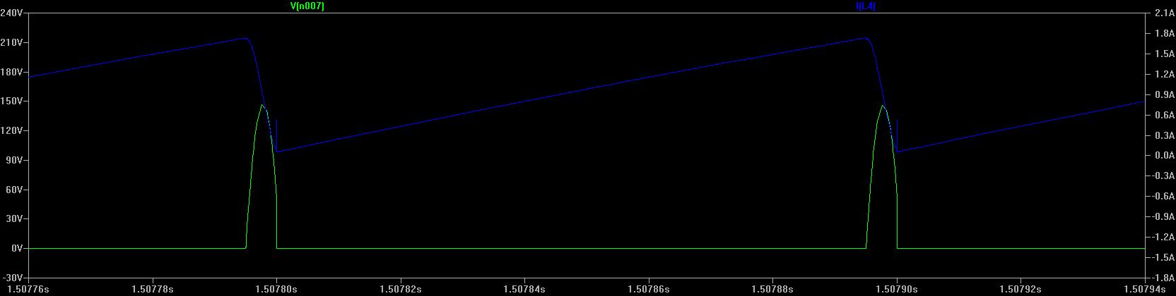

    • ... who needs IB .... TEM front end with moodz "no resistor damping" control circuit on MONO coil and the half sine flyback is brought not only referenced to ground but also ground balance, EF cancel and EMI reject and target detection automagically. So the maths for PI applies for TEM also and it is not FD. Blue trace is coil current .... Green trace is flyback.
        Yup, a ZCS (zero current switch).
        Works with mono coils too.
        Aziz
        • ....nice try but no dolly Aziz .... its not a zero current switch .... there is still a decay here ... I just manage to do it perfectly in nanoseconds. Each of those flybacks is 5 microseconds wide ( the Exciter TX pulse is 95 us on and 5 us off )

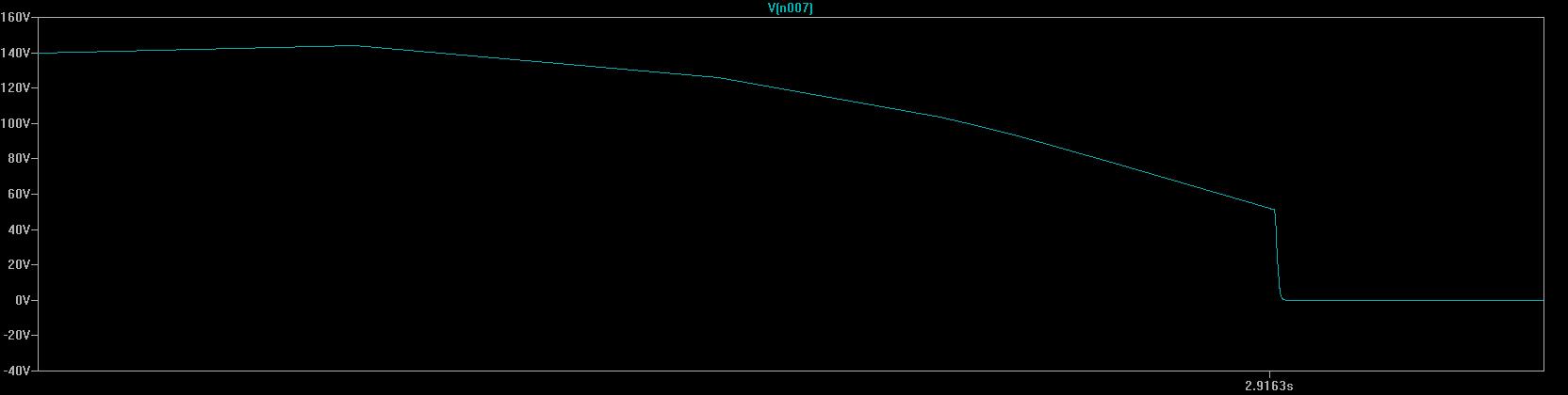

          Here is an expanded view of the right hand side of one of the fly back sine wave .... you can clearly see the moodz damping in action and a clear decay to 0 volts in a matter of nanoseconds ... there is no switch.
            Ok, I can see it now.
            But what is happening to the coil energy? Storing, recovering, wasting (burning), beaming into a ZPM into an another universe?
            Aziz
