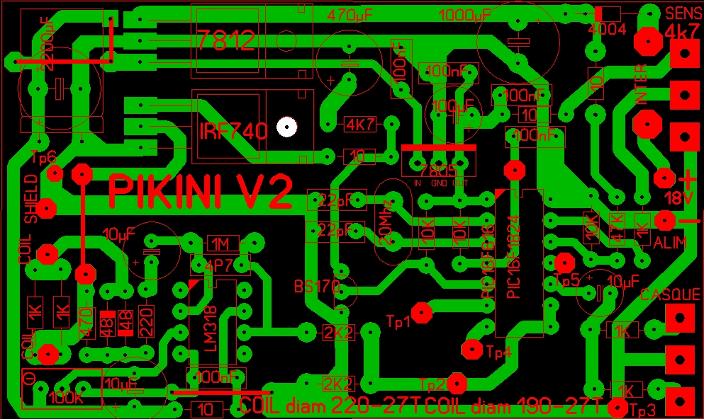

PICKINI - an easy to build PI detector

Nice work on the PCB

Did you use the "contact" method to make the pcb for this project ?
is there a link to the instructions for useing contact ?
We spoke about this briefly on a thread somewhere, but when I run the contact
through the laser printer it crinkles and shrinks with the heat.
The basic info I have is you first print the PCB on paper to see where the pcb is being printed
then cut out a piece of contact and stick it over the pcb printing
then run the paper through the printer again to print on the contact.

for my projects i use a scotch tape (not for pupil ) but for windows or furniture (i use paper not the sticker of course )it cost 2€ for 10 meter so you can do a lot of pcb.simply print your layout on the shiny side of the paper (perhaps you'll have to do some test) .or you can try with a photo paper for ink printer but not the glossy paper ,i used matt paper.

Hello 6666, yes I did use the 'Coles' book covering' here in OZOriginally posted by 6666 View Postjohnandles
The contact has to be unpeeled from its backing (hope that doesn't sound condescending) then stuck over the previous print.
Use a credit card to Iron out any wrinkles, (this is important)
Then re run through the laser again on high resolution.
Then Iron on as usual.
It worked for me.
I have previous pictures posted here and It is a working detector..(on the bench, at this stage).
The info should be on an 'Industructables' web site.
Hope this helps
Cheers
John
Hi F117!
Look carefully at the detector scheme and see that the transistor BS170 is shown as NPN transistor. Datasheet Fairtsild Semiconductor says BS170 is N-Channel Enhancement ModeField Effect transistor. What is true NPN or N-channel.Is it possible in the circuit diagram be considered NPN transistor BC170?
Hi Toros,Originally posted by Toros View PostHi F117!
The transistor on the PCB is a really a BS170 MOSFET. I used the symbol of an NPN transistor in Eagle, just to get the PCB layout right with the 3 legs aligned in a row instead of triangular. I know you can create your own components and I did for the combination of potmeter/switch.
This transistor is just a level translator, should work also with an NPN transistor.
