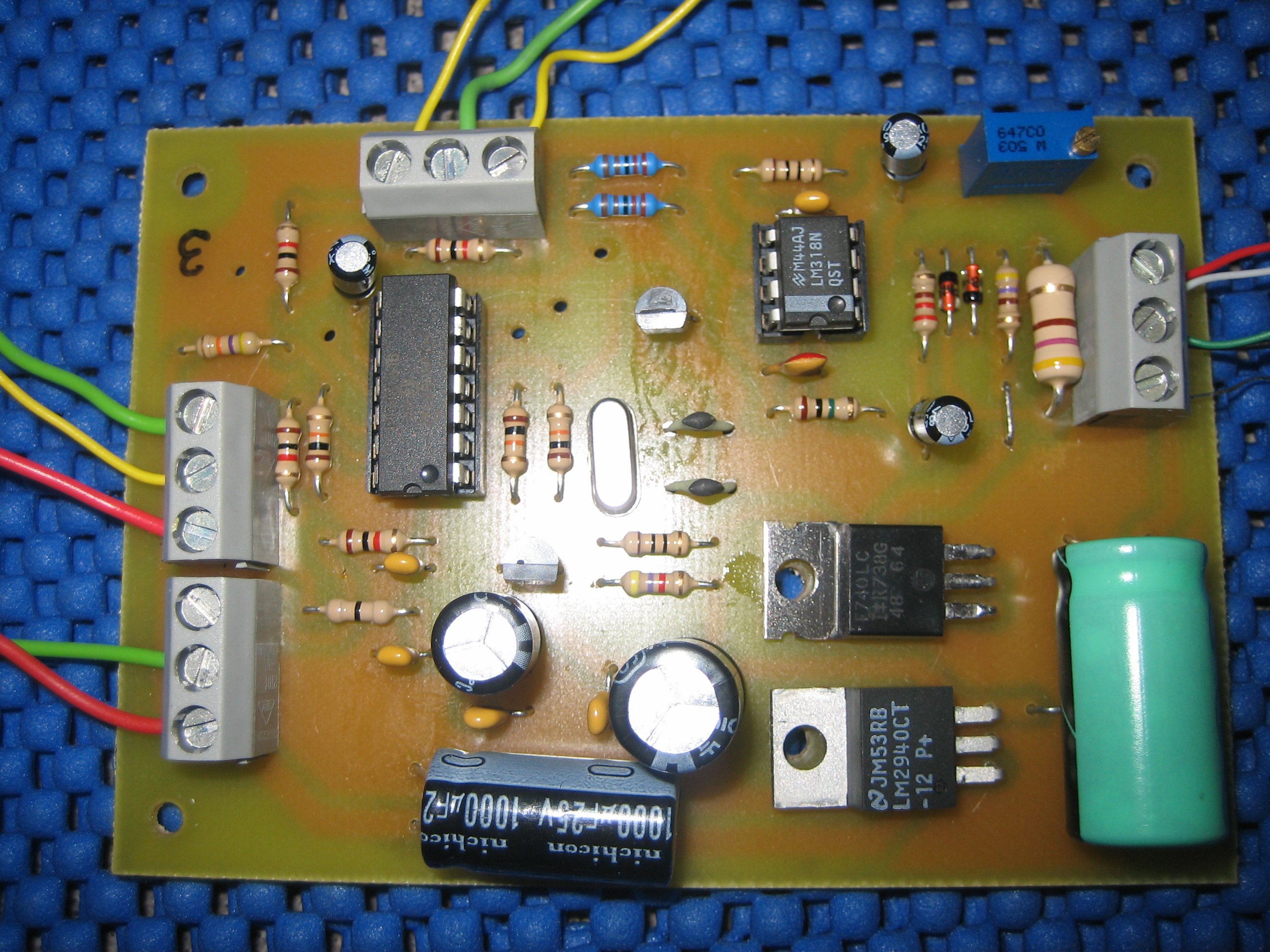

    This is a very simple, straightforward, easy to build PI detector. I am in no way an analog electronics specialist, so I shamelessly copied the front end of the blind squirrel detector and hooked it up to a simple Microchip controller. Since software is more my speciality, the shortcomings of the front-end electronics are somewhat compensated by the signal processing software + audio feedback.
    There is only 1 control: a 4K7 potmeter for sensitivity combined with the power switch.

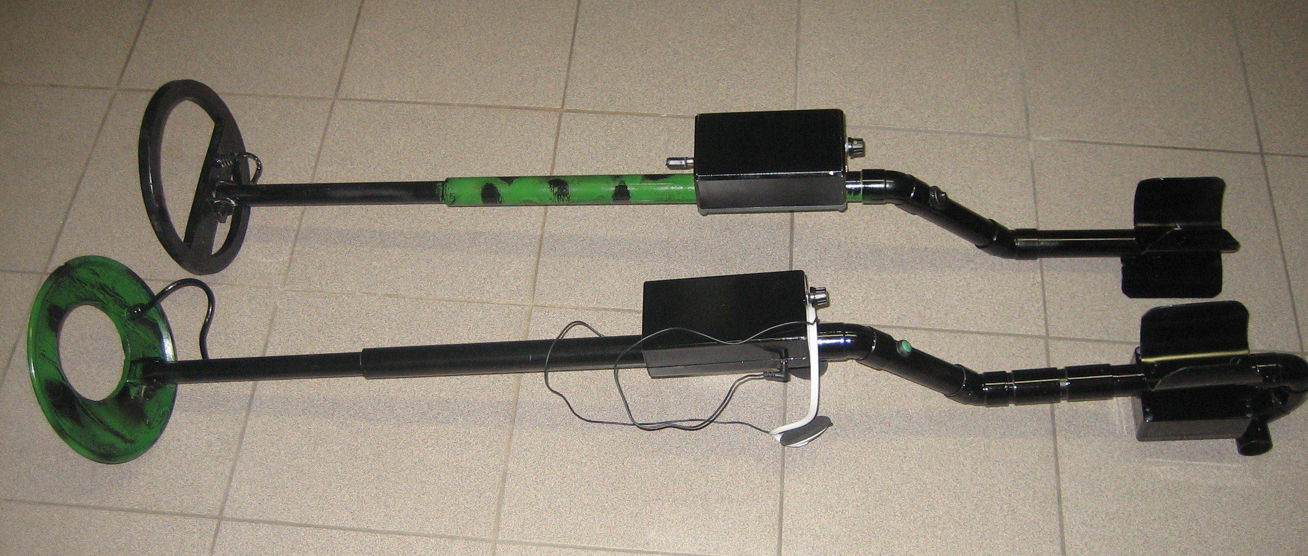

    So far, we built 6 units, and all perform equally well. Air tests show about the sensitivity one can expect from a 20 cm diameter coil: about 25 cm for my gold wedding ring. 20 - 30 cm for euro coins. All depends on the quality/size of the coil.
    That is why I spent some more time on field tests instead of simple air tests. I normally search with an XP GoldMaxx Power which is like most IBdetectors an excellent detector on fields, but is close to worthless on the beach. With the Pickini detector I searched fields that I had gone over with with the XP GMp and still recovered small items at greater depth.
    On the beach, it never gets boring, although a lot of the finds are trash.
    You can find all the data + PCB + software here:

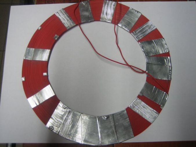

                            Which size coil gave the 30cm result ?
                            thanks
                              The coil type that gave overall best results is a flat spiral wound coil - ID 14cm OD 24cm - 30 turns:

                              But without the shielding tape !
                              This is the coil that can be seen on one of the detectors on the picture at the top of this topic, embedded in a flat plate.
                              So far, I only tried this coil and a 20 cm classic round coil - the other one on the picture.
                              It's also surprising (or not) that the small euro coins, that are made of iron, can be as easily detected as the larger ones.
