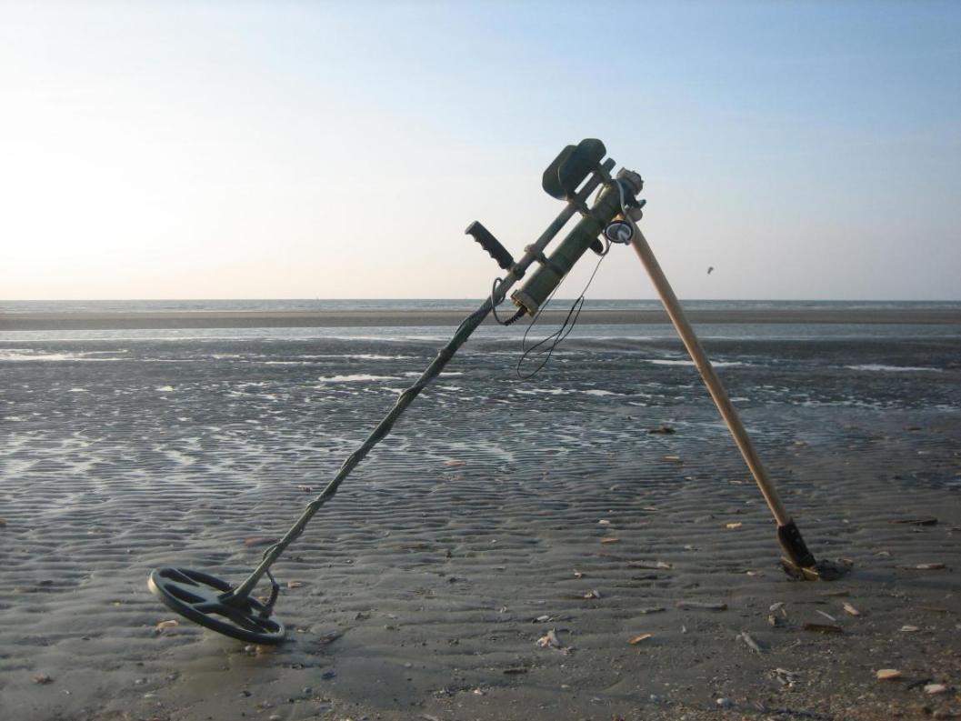

                    • New PICKINI V3
                      After having built quite a few of the V1 and V2 PICKINI detectors, it was time for some changes:
                      V3 is largely based on the same principle = flyback pulse width measurement.
                      This principle is described in the book "Inside the metal detector" on page 170 = PI design 5.
                      Major differences from V1/2:
                      • smaller single sided PCB footprint: [35 x 110 mm] or [1.38 x 4.33 inch] fits nicely in a drain tube.
                      • simpler power supply: unregulated 10V - 14V DC, so less batteries needed.
                      • new analog frontend around NE5532 opamp + virtual ground - as described in ITMD.
                      • smaller microcontroller: 8 pin PIC 12F1840.
                      • new mechanical design: straight stem from crutch, coil shell and lower stem were bought.
                      • optional pinpoint pushbutton: switches the detector into non-motion, allowing it to hover over the target
                      • extra audio signal when no flyback is detected = "coil error sound" - mostly caused by bad coil connection.
                      The entire description and download section can be found here:
                      http://users.telenet.be/willaert/MD/.../V3/intro.html
                      Enjoy,
                      - Bernard
                      • Very nice job!
                        What sort of depth do you get on a Euro coin?
                          Very nice job!
                          What sort of depth do get on a Euro coin?
                          Thanks, George.
                          A "euro coin" = 1 euro is detected at 20-30 cm with the 25 cm diameter coil in the picture. Performance is equal to the V1/V2 versions and is largely dependent on the type of coil used.
                          The funny thing about "euro coins" and PI is that a small 5 eurocent coin is detected at equal distance or even better because it is made of iron with a thin copper layer.
                          When hunting on beaches that are already "combed" by discriminating VLF detectors, I get to find all the small eurocent coils.
                          This doesn't add up very quickly but keeps you going.
                          - Bernard
