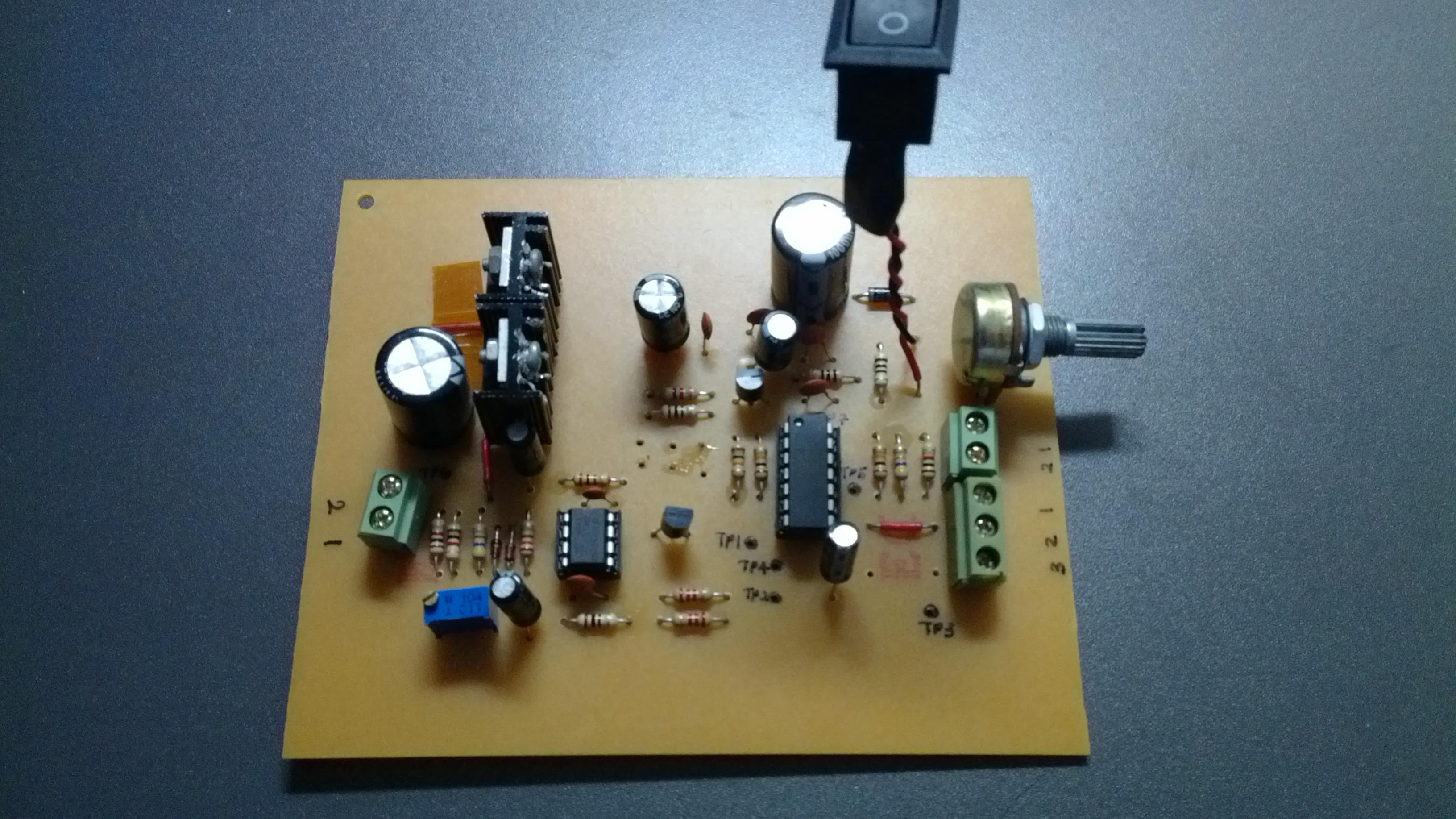

              • hello vawn90,
                can you post or link a picture from the pcb layout which you have used?
                    Attached is the photo of my pcb layout and you will notice different in the component, as in my country, Malaysia will receive component at least a month from europe or etc. Except singapore.
                    I have measured all the reading from the Op-Amp and PIC..Every part follows the reading from post #61.
                    The detection happen when i connect prob from multimeter, one to ground and the other to port 2 of Op AMP, only then it works.
                    I built the circuit with breadboard and PCB. I compared both of them and both needs the same connection i have mentioned. I have checked the resistor of the multimeter which is around 1M. The sensitivity is not good enough as it could detect iron in few centimeter away only.
                    Is there any wrong with my connection? Please advise...
                    • Do you notice any different behaviour when you slightly turn the multiturn potmeter.
                      It should be adjusted for 8.0V at pin 3 of the opamp, but try to turn it up/down to see if a more stable point can be reached?
                      Is the ground connection of the opamp - pin 4 OK ?
                      Maybe also a picture of the copper side of the PCB ?
