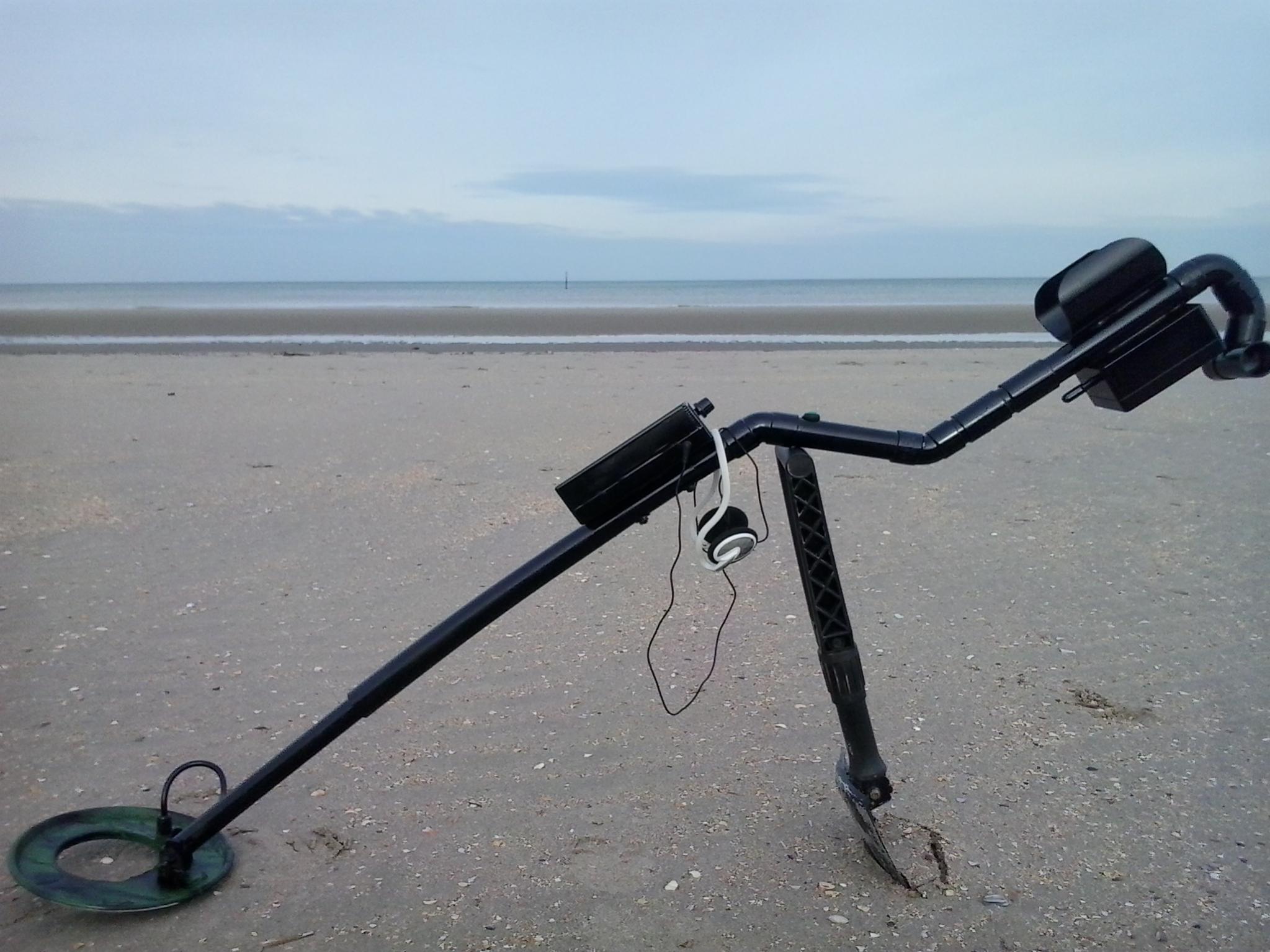

                  Had some fun at the freezing cold beach this weekend...
                    many thanks, Bernard
