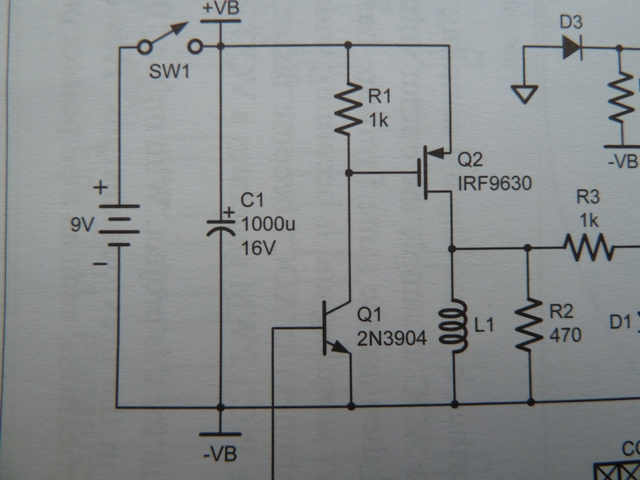

          • Now I understand it. I was confused. I have compared the schematics of various PI circuits. Coax cable can be used with other PI detectors, such as the circuits of the detector book. But not at the PICKINI. Here is a short circuit would occur. Therefore 3x connections for the coil. (see schematic). Here are 3 wires in the cable must be. For other detectors 2 wires (lines) sufficient-- so coax. PICKINI no coax cable.
            Dirk
            • Here the difference between the circuits
              PI from Detector-book
              PICKINI
              I hope you understand why I was so irritated ....with coax-cableand shielding.......and so on....

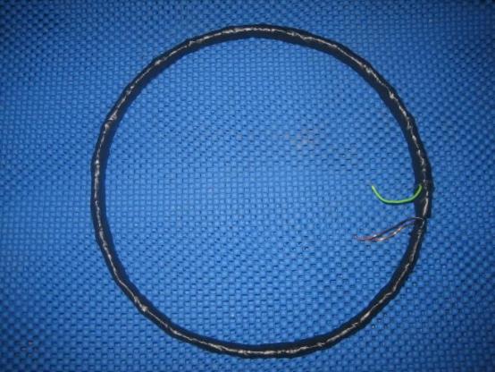

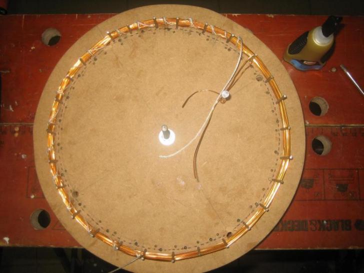

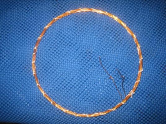

              • A couple of weeks ago I built a coil for a PICKINI detector that was the best so far. The detector remains stable even when sensitivity is cranked up to the maximum ( in a field away from any noise ).
                Step by step instructions:
                1. Wind a bundled coil with enameled copper wire around a circle of nails - diameter 21 cm - 27 turns.
                Wrap the bundle tightly with e.g. kite string and add some super glue to the knots in the string.

                2. Wrap the coil with 2 layers of electrical insulation tape.

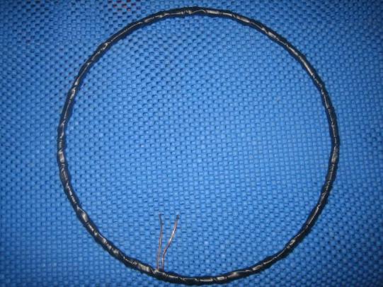

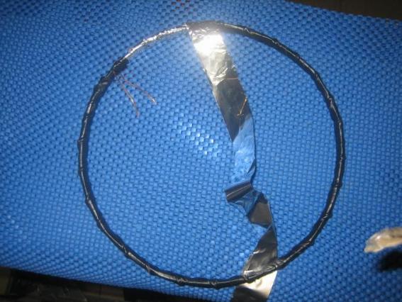

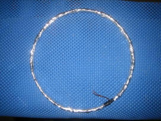

                3. Wrap the coil with a layer of aluminum foil. I used normal kitchen foil cut in narrow ( 2 cm ) stripes.
                Do not wrap it completely around - leave a gap open of about 1 - 2 cm.
                4. Add a ground wire over the aluminum foil -- wrap it around the foil a couple of turns so that it makes good contact.
                Add another layer of insulation tape over the alu foil:

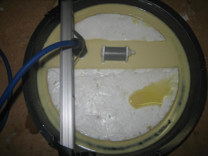

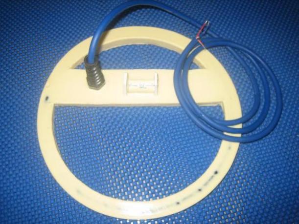

                I then put my coil in a silicone baking mould, added 2 fixation brackets + the cable and cable strain relief.
                Next, poured 2 component resin into the mould. It settles within 20 minutes and turns from transparent into an ugly yellow color:
                The cable is microphone cable.
                Fresh from the mould after about 30 minutes:
                This coil gives good results and is a classic recipe for a shielded coil. I am in no way a coil specialist, but just picked up this information here on the forum.
                The major advantage of this coil is that it doesn't trigger false signals when you touch the ground or grass when waving it over the ground. I had this problem with an identical unshielded coil.
                Best regards,
                - Bernard

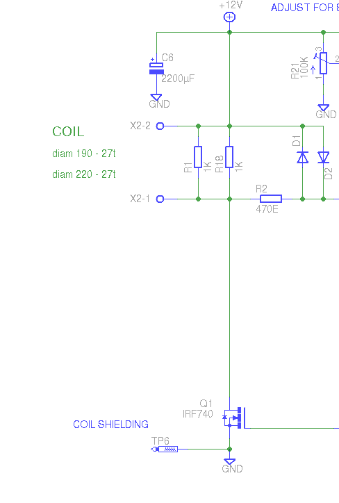

                  In that case, connect the shield to the +12V line, but (if you're using a metal enclosure) make sure you don't connect the case to the 0V line, otherwise you'll short out the power supply.
                  Ask F117 where he connects the shield.
                  • Hello Qioazhi
                    F117 used microphone cable. (See last Picture) Two wires and a shield. Therefore, he has three wires in its cable and the shield can on the ground (-) connect . But I prefer to use coax cable (RG5.
                    Microphone cable I've tried. The coil damps extreme. Much less power.
                    Thanks for the note of connection to (+). So I can use coax!

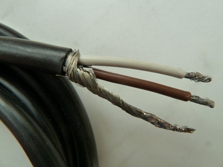

                      • Hello Bernard
                        I bought at conrad this microphone cable.
                        If I have it connected to the coil, then walked down the performance. I've tried it. When I read the article by J. Rogowski (bbsailor) understand correctly, does this relate with the capazitance, not with the resistance of the cable. Both wires are close together.

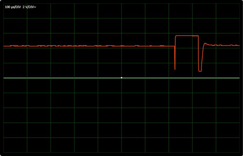

                        At the moment I am still trying my oscope. I can not even cope with the oscope. I think that the wave does not look right.
                        all the best,
                        Dirk
                        • Hi Dirk,
                          nice oscilloscope picture !
                          At first sight, it looks identical to what I am seeing on the scope.
                          When you trigger on the falling edge of the top trace, you may be able to investigate the rising flyback slope in more detail.
                          I am not a coil / cable specialist so I will not judge/comment on the use of a particular type of cable.
                          There are people with far more experience on this forum that maybe want to add comments on this ?
                          - Bernard
