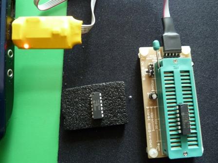

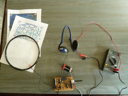

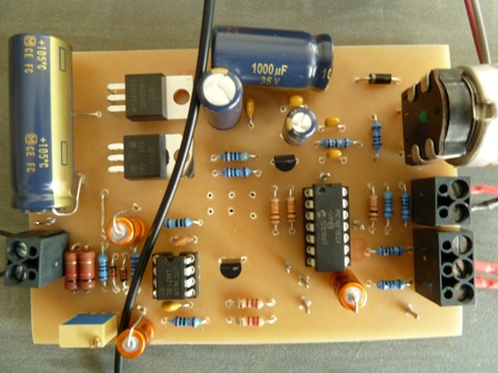

      • I have the circuit "PICKINI" built. Finally, a circuit that works!!! Thank you Bernard for publication. Also, the HEX-files could be easily loaded into the 16F1824. Click image for larger version
ID:	337068 It is fun to see how it works. And gives courage to build the circuit with 16F616 and 20MHz Xtal. Click image for larger version
ID:	337069 Click image for larger version

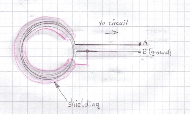

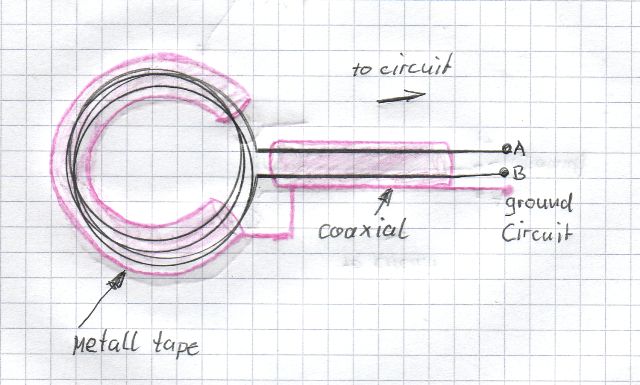

ID:	337070 I have two short questions: 1 Have I understood correctly that the multi-turn pot (R21) is for adjusting pin 3 of the opamp (8V)? 2 The shielding. Do I have the shielding tape as shown in Figure 1 to make the coil, or as shown in picture 2? Click image for larger version

        • Have I understood correctly that the multi-turn pot (R21) is for adjusting pin 3 of the opamp (8V)? 2 The shielding. Do I have the shielding tape as shown in Figure 1 to make the coil, or as shown in picture 2? Thank you, Bernard, for this nice project! Regards, Dirk
          Dirk,
          1. The multiturn potmeter is indeed for adjusting the DC offset of the opamp: 8.0V at pin 3.
          2. I normally use shielded microphone cable = ( 2 conductors + common shield ) instead of coax (1 conductor + shield ?).
          The connection in picture 1 is wrong IMHO - but then again I'm not a coil expert. In picture 1 you will short the shielding = GND with one of the coil connections.
          So, use picture 2 -- but what is the outer shielding of your coax cable then ?? Does it have inner shielding = one of the coil connections AND outer shielding = GND (shield) ??
          Best regards,
          - Bernard
          • Sorry, I was blind .... In your circuit, a ground terminal is provided. Directly under the large capacitor. I'm going to get me today microphone cable.
            Thanks for the note.
            Dirk

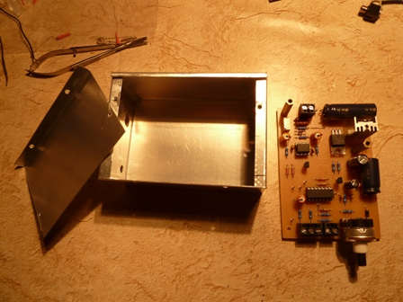

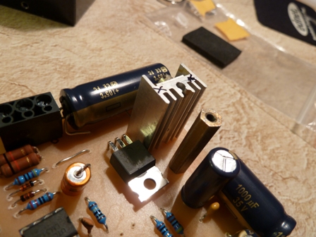

                      • Hello,

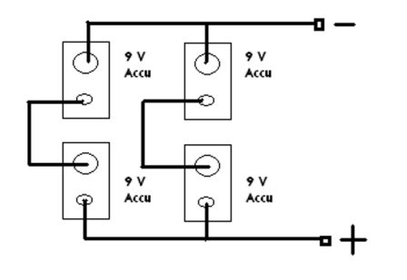

                        I use 4 x 9V ACCU. The total voltage is 21 V.
                        The 12 volt regulator is very warm. Therefore, I use a small heatsink.
ID:	337098Click image for larger version

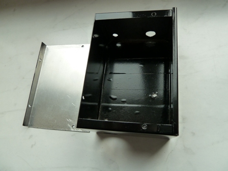

                        For the circuit I made a casing made ​​of thin aluminum sheet. I have found that there is a very good protection against interference. So far, I could do without the shielding coil. Let's see what the result field tests ....

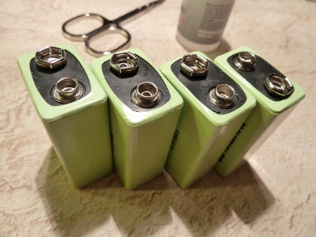

                        • Dirk,
                          How do you connect 4 x 9 V blocks: 2 in series = 18 V and then 2 of these in parallel (hopefully with 2 diodes in series ? ).
                          Or just 4 of these in series = 36 V ??
                          Also, the capacity of these 9V blocks is very low ( around 300 mAH ). NiMH batteries in series will give you a resolution of 1.2V and have a capacity of 2000-3000 mAH.
                          A simple constant current charger can be found here:
                          http://users.telenet.be/willaert/MD/...n/battery.html
                          I strongly recommend using 15x rechargeable NiMH AA cells in series instead of 9V blocks.
                          - Bernard
                          • A quick calculation of the dissipated power vs temperature rise in the LM2940-12.
                            Based on this datasheet: http://www.ti.com/lit/ds/symlink/lm2940-n.pdf -- page 15
                            Power dissipation in the device = ( Vin - Vout ) * I => (18 - 12) * 0.135 = 0.81 W
                            Max juction temp = 125C - ( max ambient = 50C ) = 75C
                            Thermal resistance = 75 / 0.81 = 92.6 C/W
                            From the datasheet:
                            If the maximum allowable value for θ(JA) is found to be ≥ 53°C/W for the TO-220 package,
                            ≥ 80°C/W for the DDPAK/TO-263 package, or ≥ 174°C/W for the SOT-223 package, no
                            heatsink is needed since the package alone will dissipate enough heat to satisfy these
                            requirements.
                            If the calculated value for θ(JA)falls below these limits, a heatsink is required.
                            So, in this case, the 12V regulator in TO220 housing can be safely operated without heatsink.
                            • Hello Bernard
                              Thank you for the very important information! Yes, I use 2x2 9V batteries. Please where the diodes must be used? (Sorry for these questions - I'm an electronics newbie).
                              You're right, it's probably better to use 1.2 volt batteries (as shown on your website). I'm going to build me an additional housing for these batteries.
                              Thanks again for the advice!
                              Dirk
