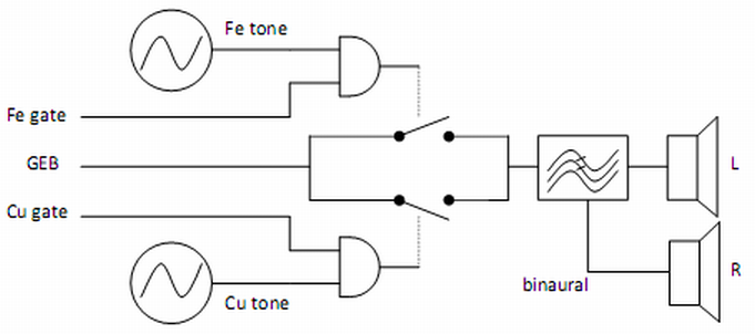

Final part is the audio part with binaural conditioning. With binaural you can use any of the channels to produce a mono audio for a built-in loudspeaker, but otherwise it requires stereo amplification.
Sounds are produced by means of amplified and conditioned GEB channel. As it is aligned to have null at ground response, and freely adjustable to assume any angle of the foreseable ground responses, even the exotic ones, it will be very flexible. The angle is relative to the Tx angle, but not with the frequency, so only minute adjustment may be needed when Tx frequency is changed.
This separate GEB approach, as separated from All metal channel, is beneficial at difficult grounds as they both perform optimally their respective functions. Joint GEB/All metal is useless at difficult ground as it can perform only one of the functions properly ... if you adjust for perfect ground rejection, your discrimination gets screwed up. And vice versa. I don't think this is an original idea, but it makes sense.

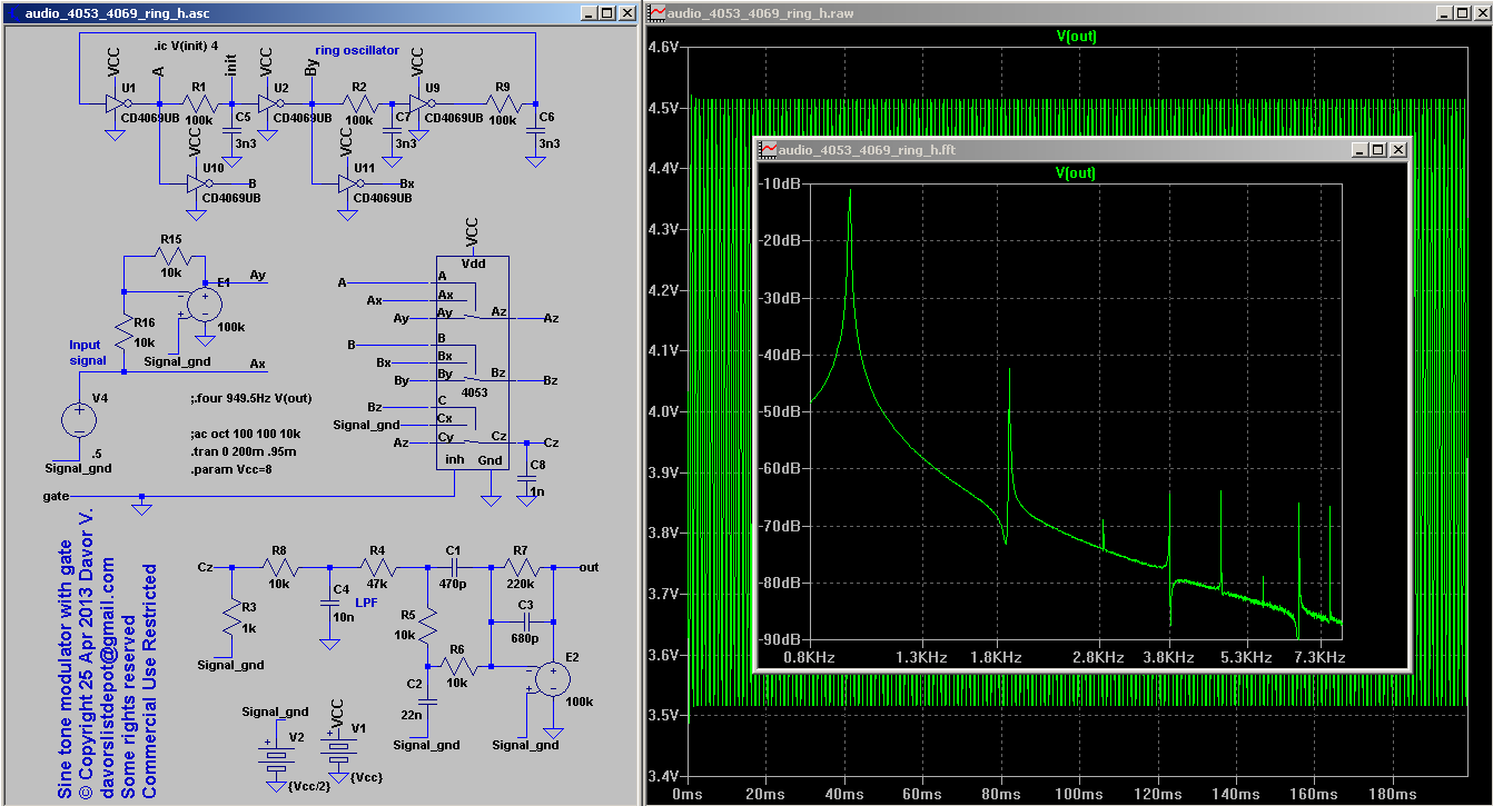

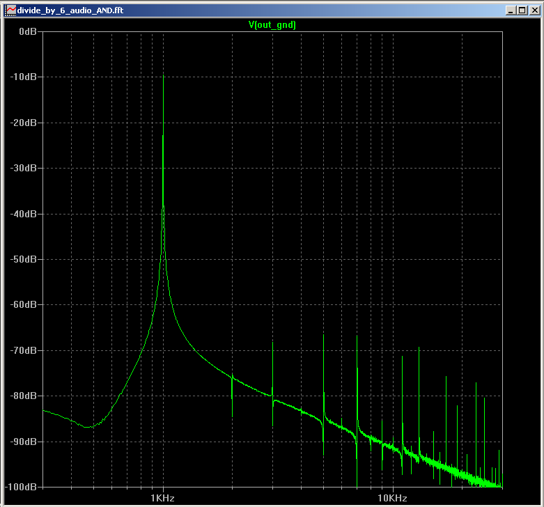

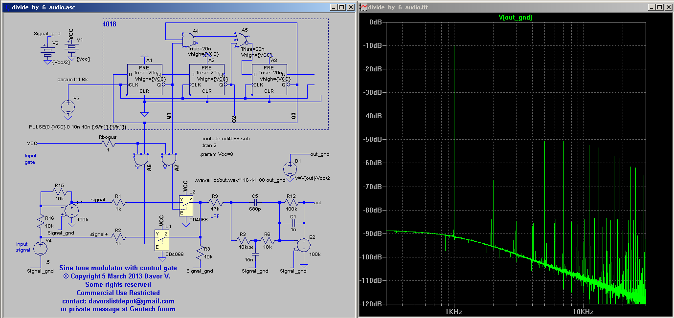

Tone is produced by phase shifted switching with switches duty cycle of 50%. More about this later. A consequence is a synthetic sinewave with suppressed harmonics up to the 5th, at GEB amplitude (and phase). There is no real need for rectifying GEB voltage because this works either way. Switches are gated by discrimination signals, so that all combinations of tones are possible; neither, either, both. Elliptic filters take care of the remaining harmonics so that pure sinewave goes out. Tones are phase shifted in binaural fashion.
Here is the schematic

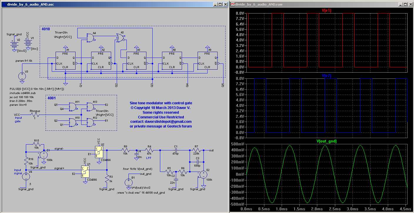

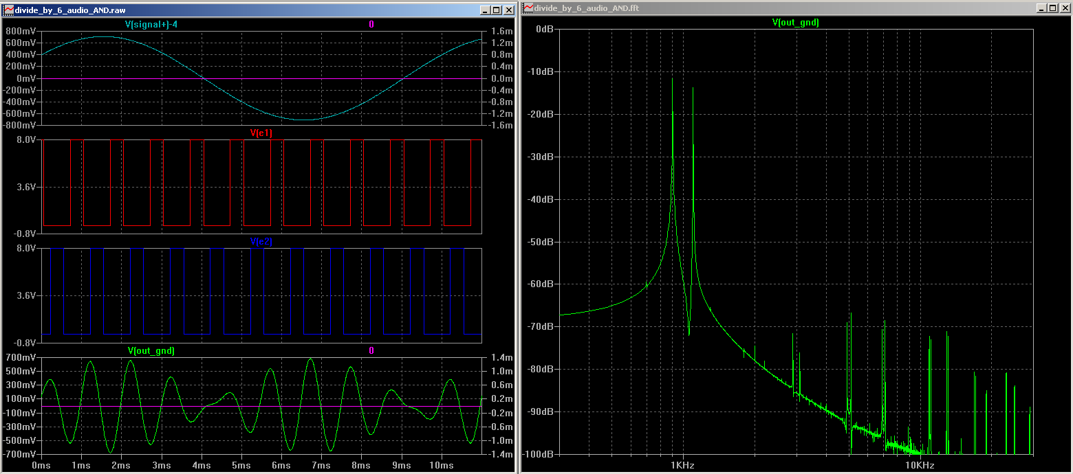

Residual disbalance signal on the RX coil , being converted to DC , is blocked by C6 and C7 and can't overload your amplifier , isn't it ? But motion signals can go further to the chopper .... it's interesting . IMHO very good solution !
