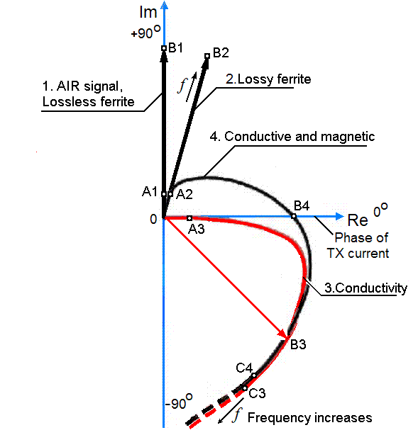

    I have a suggestion:
    Let somebody explain two figures.
    The first one is a block diagram of principle on which received signals are formed. It explains what means "difficult ground".
    The second figure explains why the conductivity generates frequency dependent resistive and reactive components, and when magnetic permeability contains resistive component.
    These two figures contradict your statements in post # 1:

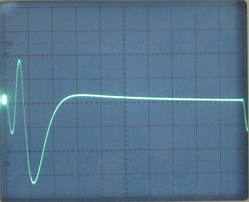

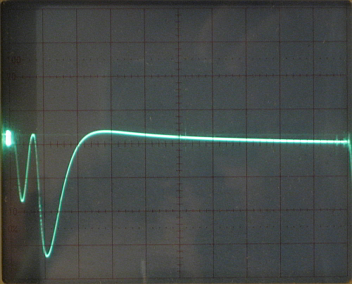

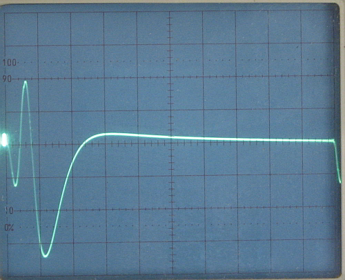

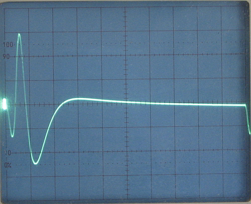

        Here are a few more pictures.
        All have the ground, as the earlier ones, but then I added a target also.
        1) Ground only
        2) Ground and ferrite
        3) Ground and 1"square alu foil that has a TC of 10us
        4) Ground and silver dollar
        Remember this is at the output of the preamp, that has a gain of only about 10. therefore the change in the signal wave form is very small for the alu foil target. Look at the tips of the sinusoid at the transient.
        I find that I am showing the full dynamic range that this screen shot can show, the minimal, just barely visible deflection for the alu foil and the maximum of the silver dollar that just hits the edge of saturation on the negative rail.

          The first 30 usec of your traces look different than what I would expect. Have you tried reducing the amplifier gain to maybe 4? I think the no target signal should start at .6 volts times the gain and decay from there. Maybe I'm wrong.
            Tinkerer
            You are right, the wave form looks different from the traditional PI wave form. The traditional PI uses clipping diodes at about 0.6V and high gain in the preamp.
            The TINKERERS uses an induction balanced coil to get rid of the Flyback voltage spike of several hundred V and uses no clipping diodes.
            This is why, with the TINKERERS, you see the part that is normally clipped and the part that is usually lost in the preamp saturation.
            You would need the usual 1k gain in a fast traditional PI preamp to see the response of the 1" square alu foil.

              Thinker, this is not true. Your oscilloscope shows that all metal detectors are time domain instruments. We all live in Time domain, but you are using a term "phase", attributable to Frequency domain. Can you explain how the phase angle appears on your oscilloscope? Please don't use your oscilloscope and Time domain for analysis.
              The most suitable tool is Frequency domain because it removes the mist of math operation "convolution". Another tool is the DSP, but it uses terms as "deconvolution" and "impulse response" (see patent US
              The visual Frequency analysis shows that if we usе suitable frequencies, we can make the phase difference between gold nugget and ferrite halfspace less than 180 deg. See how we can obtain phase difference almost 90 deg or 135 deg.
              At frequency A we have ferrite response 0A1 and gold response 0A3. The phase difference is almost 90 deg. This is ideal for synchronous demolator.
              At frequency B we have ferrite response 0B1 and gold response 0B3. The phase difference is 135 deg. This not ideal for synchronous demodulator, but visual analysis shows that at 45 deg and 135 deg it operates well.

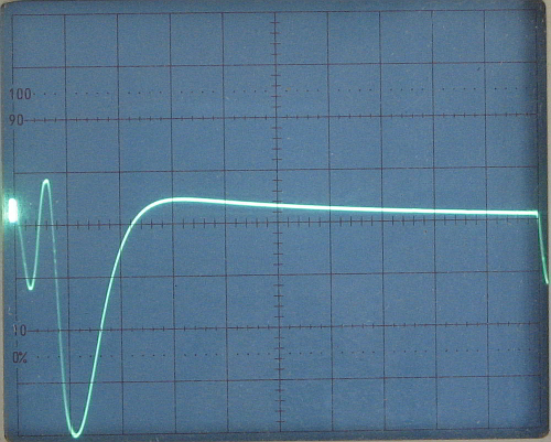

                                Mickstv, sorry about the picture quality, if it is not good enough to do the superposition, I will redo tomorrow.
                                Davor, this one is for you. Could you help me measuring the time of when this target signal merges with the Ground signal? Maybe just using a comparator to start with?
                                I am going to start a new thread for that, as it is a different subject from the ground balance.
                                Below is the picture:
                                Ground and large target of short TC. The actual target is a piece of alu foil of about 2"x2". It is a large target of high amplitude response, but of short TC. I think we should see the difference in response between the silver dollar.
                                Tinkerer
                                Earlier we had the ground and a silver coin. The silver dollar has an estimated TC of over 300us. (just a guess)
