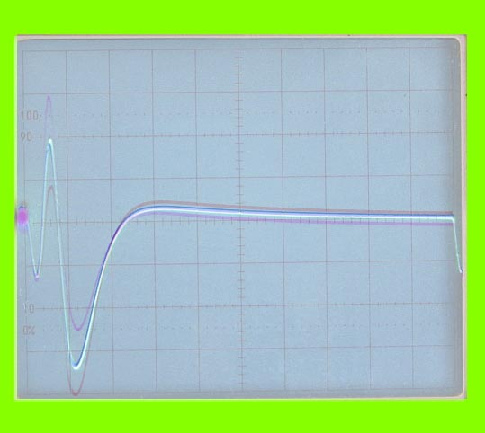

        Here you go Tinkerer,
        Ground is original green
        Ground + ferrite is purple
        Ground + foil is blue
        Ground + silver dollar is dull red
        All side effects of some fancy filters and gradient stuff. Not perfect but I've already spent too long on it..

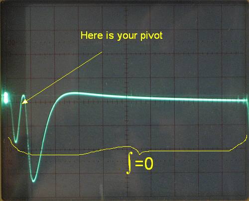

          Davor, this one is for you. Could you help me measuring the time of when this target signal merges with the Ground signal? Maybe just using a comparator to start with?
          First thing's first. There is a high probability that either ground or the target tau shall meet far beyond the pulse duration, hence you can't count on a far end junction. But there is your pivot at the beginning.
          Your diagrams are showing a pivot in all it's glory. It is obvious that the pivot will become some kind of ... a pivot. Next thing is to establish a tau relationship. Again, it is obvious that shorter taus respond sooner and the first up-going hump is more prominent for them, also the second down going hump is more prominent for the longer taus. But up to the pivot these curves go along. Trouble is a reference that is prone to offset errors. A whole curve, or infinite number of curves would have a nett value of zero, or the integral of the whole shebang would ideally be zero. I'd suggest you to make an integrating servo to keep the average of the signal at precisely zero.
          Some early CRO shots show the translation of the long tail up or down with the applied target. To remove ground, I'd play with the relationship of zero crossings past the pivot. Establishing a zero crossing is easy by balancing the sample before and after the actual zero crossing, but to do that I'd need to remove offset, hence an integrating servo. Once in action, the zero crossings can self-balance to the ground, disbalance proportion says target tau, and amplitude it's size/proximity.
          It is also possible to integrate windows between the zero crossings to establish amplitude more directly.
          Please note that such ground balancing will not be able to establish tau directly as a relationship to ground balanced zero crossing on difficult terrains. Direct relationship could be possible only in air tests. Some further refinement will be necessary for target ID on difficult ground.
            When I think about it, with 10,000 pulses per second, zero crossings are easily obtained by a mere sign() function e.g. a comparator. Pulses obtained that way can be balanced with some PLL-like mechanism (correlating result with prediction, correcting prediction in a loop).
