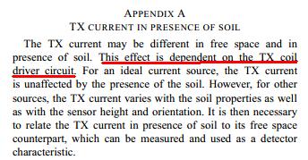

          Can someone please elaborate from the first document posted. See below quote.
          Question is, what parameters is being referred to below that the TX driver is what influences the TX Current in air compared to in the soil??
          Ideally soil and air would be both the same, but how does the TX driver achieve close to ideal/optimum results?
          Is it Frequency/PRR of use? or the amount of TX Power being used? or both?
          If it is TX Power, altering for different power levels in experiments would be interesting to see the results for targets buried in soil tests with varying power levels.

              Sid, The problem arises only when TX coil moves because ground operates as a core for TX coil.
              Eric Foster has a solution to avoid movement: he places a very large TX loop on the ground and searches with RX coil inside the loop.
              An old solution in Frequency domain is to use P-I-D controller for amplitude stabilisation of voltage across TX coil:
                Thanks for the reply Mikebg.
                Lets say we have no variable TX current in soil when a coil is moved side by side (neutral soil, equal characteristics)
                We know that TX current induced in variable soil will differ compared to TX current in air and vice versa.
                How does the TX driver determine the amount of current induced in air compared to in soil as per that paragraph statement i posted from the first document from Ferric toes.
                I think its reffering to different TX power levels can be used with different certain soil conditions which is what then determines the efficiency of the current induced in soil compared to the original transmitted TX Coil current.
                Is the PRR selected and the TX coil current selected have a influence in achieving the strongest Magnetic field in certain soils?

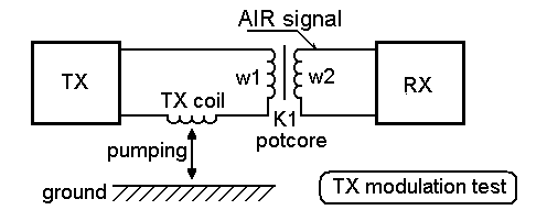

                  Sid, don't think what happens in the Earth. Think what sees the synchronous demodulator. It receives a large combination - AIR&GND signal. I will explain its properties in Frequency domain.
                  The AIR component is direct proportional to frequency. It is always in quadrature to phase of TX current.
                  However the AIR signal is proportional to primary field. Since the GND signal is generated by primary field, if AIR signal is modulated, then GND signal is also modulated.
                  The GND signal is proportional to frequency squared when the soil has conductivity.
                  In common case the GND signal has phase difference with AIR signal - see loci 3 and 4 in this post:
                  At ground balance, the synchronous demodulator can not see the amplitude modulation of GND signal. However it sees the modulation of AIR signal.
                  The AIR signal is modulated at movement of TX coil with small modulation index. However the TGT signal appears as modulation of AIR&GND signal with very small index. I tested with PI the orthogonal (TWO BOX) loop configuration. It has very small modulation index because TX coil appears relatively far from ground:
                  CONCLUSION: For maximal sensitivity, we should use induction balanced search head to suppress AIR&GND signal and P-I-D controller to suppress amplitude modulation of AIR signal.

                      Please fill a plastic bowl with salt water and measure the modulation index of AIR signal pumping with search head. You'll get a much larger modulation index of AIR signal than does this the target. The SPICE can't show such small index, but the synchronous demodulator senses it.
                      Then do the same with a P-I controlled TX to realize that you're wrong.

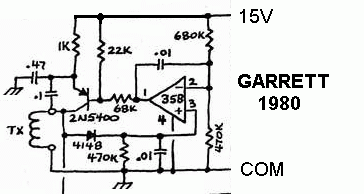

                          Davor, why you hate to copy the best solutions? Do you know more than the world known masters?
                          GARRETT uses P-I controller in their TXs more than 30 years and MINELAB - more than 15 years.

                          OK, let's have it your way, can you tell me what order is the regulation network in this Garrett oscillator, and why it's regulation overshoots?
                          I thought of a lengthy answer explaining all that's happened between the 1998 cornerstone paper by A. Hajimiri and T. H. Lee, "A general theory of phase noise in electrical oscillators" which led to better oscillators of nowadays, but let's hear your arguments.
