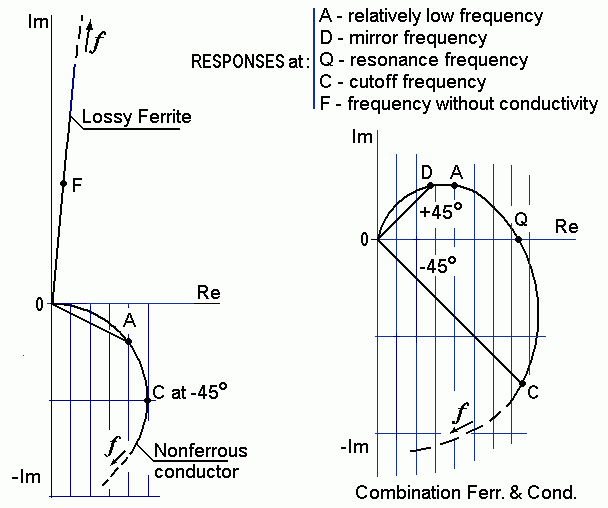

                                UrbanFox, you are missing this link
                                The post relates to block diagram in this post
                                Theory shows that phase angle of pure permeability is independent on diameter of TX loop.
                                The theoretical spectral characteristic of soil without conductivity is shown in this post
                                Below is attached the measured spectral characteristic. It shows that soil has combinarion of permeability and conductivity because the response contains timeconstants. The position of frequencies A, C, D and Q depend on diameter of excitating loop:
                                Here is visual illustration:
