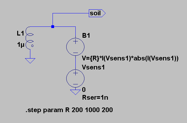

  • I think I've got a candidate for a viscous soil "target" spice model. It can be "convinced" to behave, but tuning it will be quite interesting. I simply replaced a LR target's "R" with a modified behavioural U/I combination, otherwise handy for creating voltage controlled potentiometers, but in a way that resistance is proportional to the absolute value of a current passing through it. Hence the resistance gets lower with time.
    If the "V=f(..." term is reduced to V={R}*I(Vsens1) the Vsens1 and B1 combination would perform as a resistor of R ohms.
    So far I'm off any comparable result but it is promising. It does have a linear response in a log/log scale.
    I'd be very happy if this could be tuned for everyday use, but I have zero experience with viscous soils. If someone gets lucky tuning this, please share with rest of us.

      I've never got around to using Spice, although I use other simulators from time to time. You say that your simulation has a linear response in a log/log scale, and presumably the settings can be adjusted to alter the slope? What we are looking for is a negative slope of 1, which is the theoretical value for non interacting SPM particles. In practice the slope can vary a bit either way from 0.9 - 1.1. This I have measured for a wide range of materials from different sources on my viscosity meter. Other sources of measurement report a wider spread, but this I believe to be due to non ideal instruments by which the measurements were done. The viscosity meter I have is in use in the geophysics dept of three different universities and two geophysical survey companies and none have yet reported errors in these figures. Some exotic rocks or particle assemblages may well fall outside the -+10%, but the measurements so far have been for soils, sands, rocks, and fired clays that would normally be encountered in the hobby of metal detecting. What is encountered in the field appears to be small changes in slope and large changes in amplitude.
      Eric.

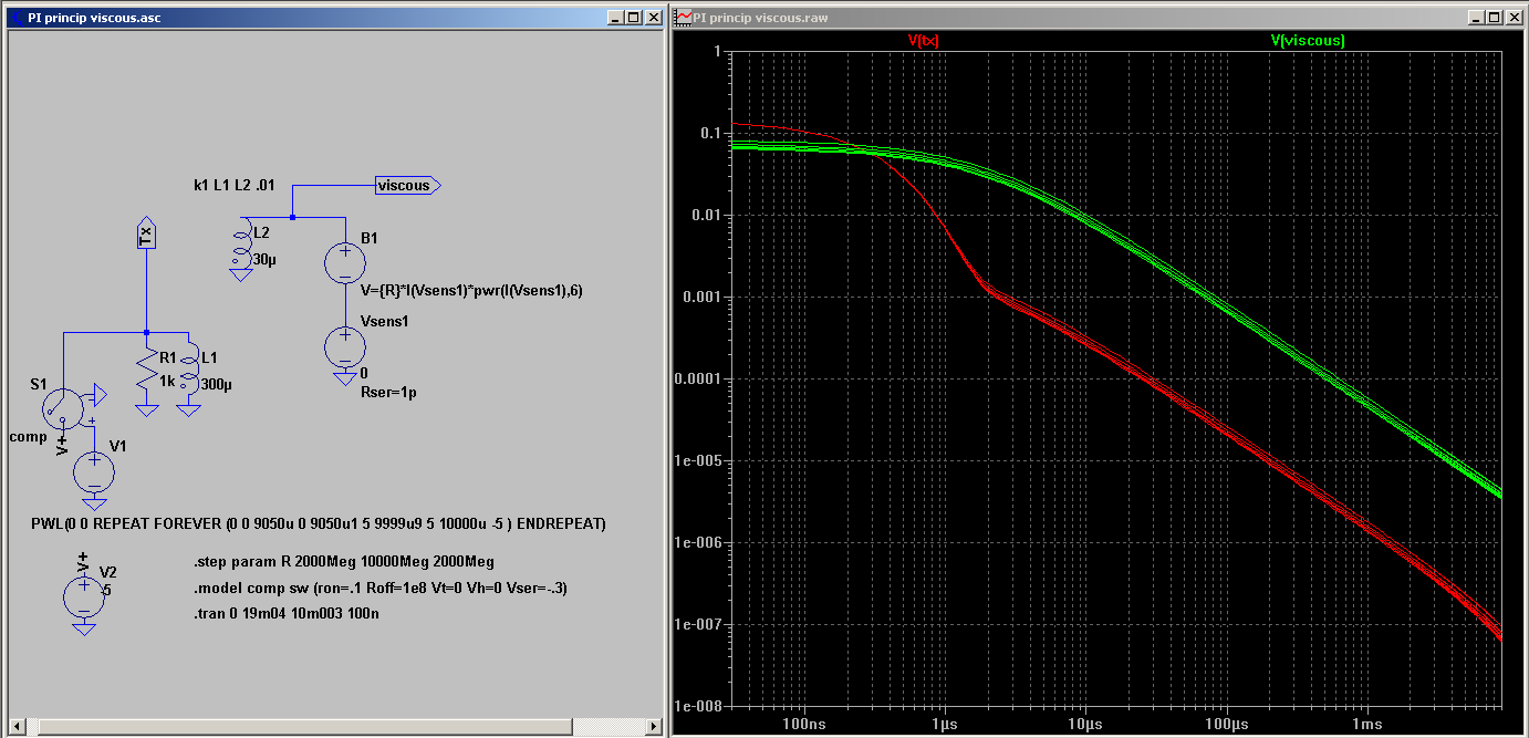

        Coil was probably 6in D at most. Vertical scale probably 3 decades. This is raw data straight off the preamp with no processing.
        Eric.
        This may explain discrepancy in results. My coil was large, significantly larger compared to target size, made of solid conductor (proper Litz wire unavailable at a time) also different scaling, so coil response most likely overshadowed the desired response. Have to recheck this in a different setup.

          I gave this simulation target another go to learn more about the slope and stuff. The variable resistance approach was a real deal, only the abs (I...) part needed some extra boost to behave. I must put it on power of 6 or more to approach a slope of -1. With the original value it is closer to the slope of -2. I instantly learned a lot about the viscous soil. It is so incredibly dependent on the coupling, hence a monocoil is perhaps the stupidest setup you can have on such soils.
          I'm not certain if this model will ever be a verbatim representation of viscous soil, as it is obvious it can't go below a slope of -1, but perhaps it can be useful as a learning tool.

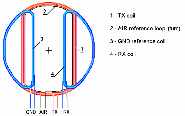

                      • Here is the DOD loop system for realisation of algorithm for ground balance described in post #77
                        Search head has 3 receive coils generating signals AIR, RX and GND.
                        The project was realised in 2008:

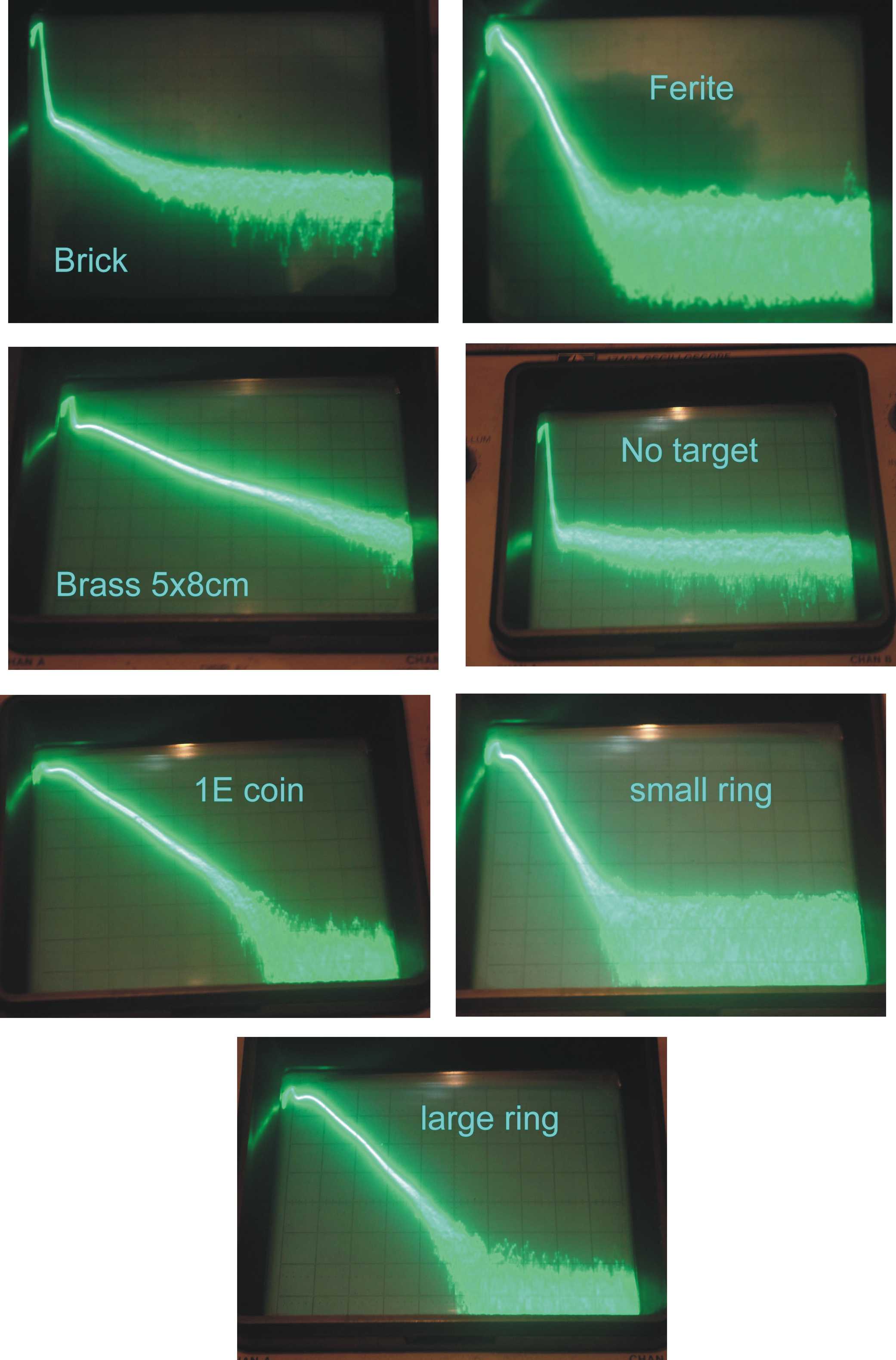

                            Good-bye civilization, back to analog scopes. Just improvised one simple LOG amp setup to try few tests. This is temporary solution, signal displayed directly from log amp video output. Serious noise problems prevented DSO use, also this is short of at least 30-40dB additional dynamic range available but still can be interesting and informative to someone. With different design (sampled, integrated and time resolved video output) i want to build test rig specifically to test different soil responses, over 80-90dB dynamic range and various pulse widths, down to 1us or less. Lot of fun with log amps, also lot of observations and conclusions to be done. Last time i tried this, big fat coil and big fat pulse prevented me to make useful measurements. On picture below, horizontal scale is 200uS (20uS\div), vertical not calibrated, around 50dB, ignore top 1 division. Analog display is better for noisy signals, tried averaging on DSO but in fact DSO monitor itself produce significant interference, so dusty old 1740 did the job.

                              Looks like pictures of that meteorite that came down over Russia . Can't beat a good ol' analog scope at times. It's good that you are seeing some differences now.
                              Eric.

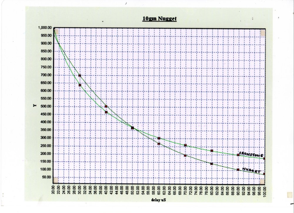

                              • I've just done a couple of plots and superimposed them. Linear plot this time and shows the decay of a piece of Oz ironstone compared to that of a 10gm nugget. Both were initially set at an arbitrary 1000 units amplitude at 20uS. It looks as though the nugget starts at 950, but it does curve up to 1000 due to early time skin effect. Curve fitting software cannot fit mixed exponentials. Optimum nugget/ground SN seems to be 30uS
                                Eric.
