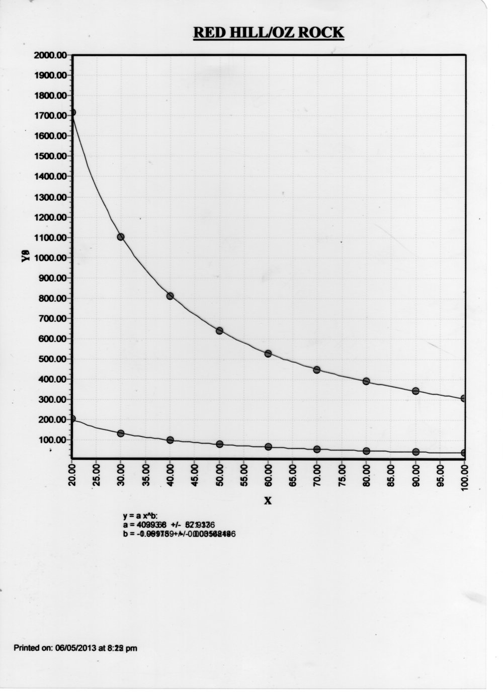

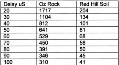

                        • Refinement continues in viscosity plotting and accuracy of the negative exponent. The plot below is a superimposition of 10gms of Red Hill soil and 10gms of Oz ironstone pieces. Readings were taken at 10uS intervals between 20uS and 100uS. I did not start at 10uS this time as there seems to be a non linearity that creeps in for times earlier than 20uS delay, and this will affect the slope fit at later times, although by only a tiny amount. The non linearity is not in the equipment, so it must be the sample. It is particularly true for Oz ironstone which has anomalous responses as reported earlier.
                          The fit data is superimposed, so not legible, but the figures are RH Soil -0.999 +/- 0.0054 and Oz ironstone -1.061 +/- 0.0031.
                          RH Soil is just a whisker shy of the theoretical value for viscous decay.
                          The linear graph also emphasizes the large amplitude difference between a strong USA soil and strong Oz goldfield material. Both measured on the same instrument sensitivity.
                          Eric.

                            Slope well may deviate even more than -1.27, not due to ferrite, but due to measurement method. Some constructive criticism. Namely, measurement method, as described before, using variable pulse, then stepping integration time and delay will tend to “flatten out” and average any measurement to look close to slope 1. I'm well aware of necessity to do this, due to noise considerations and small samples, method is perfectly good if slope is initially assumed to be around 1, but otherwise may tend to cause some uncertainty and mask eventual deviations, if there is some in initial process.
                            • Originally posted by Tepco View Post
                              Hi Tepco,
                              I have examined the method I use for obtaining the data and cannot find any significant errors due to instrumentation. Of course, the method is open to scrutiny and I welcome that, but full details of the technique will be kept under wraps for obvious reasons. Tests I have done to check for instrument error are to change the sensor coil inductance i.e. 200uH down to 50uH with no effect other than reducing the overall amplitude. Checking linearity of the system throughout, and measuring known metallic TC's and checking for linear decay on a log/lin scale. The instrument has no temperature drift from 5degC to 30degC, although the sample has susceptibility and viscosity drift. Auto correction is applied at each delay measurement so that a true zero baseline is obtained. The same sample has been measured several times to check that the readings are consistent. Sample volumes have been measured for 5gm, 10gm amd 20gm and slope is the same. Each measurement is subject to a +/- 1 least digit on the display. Here are the raw data sets for the two samples in the graph in my previous post. Plot them how you will to check my results.
                              Eric.

                              • Hi Eric,
                                thanks for the interesting results.
                                I think, that the term "viscosity" needs a clear clarification right now.
                                How would you define or declare the term "viscosity"?
                                Cheers,
                                Aziz
                                PS: there is an interesting non-linearity < 20µs, which should be followed as well.
