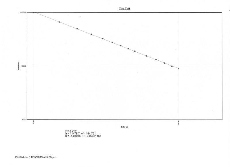

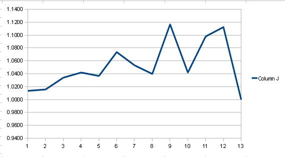

        Hi Eric,
        That method for determining exponents actually only holds true for an exponent of 1. Anything else and it delivers incorrect results, try it on a generated curve and see.
        Aziz I'm not sure what your method is but I'm pretty sure its also not correct. Nice work on the least error fit though, better than mine.
        My method pretty simple exploiting the fact that the slope of the log\log plot is equal to the exponent. So, using the first set of Redhill points as an example: a=(log(204)-log(134))/(log(30)-log(20))
        Applying it to the Tuff there's not much of a trend. It does go up broadly to start with but very erratically and the final exponent is actually less than the first. I'm starting to lean towards measurement error.

          Well it's all good clean fun, but all I need is the slope to 2 decimal places, so I might as well stick to my graphing software exponent calculation. 2DP is an order greater than has been done before, and I have eliminated many of the inaccuracies in previous instrumental results. Anything further may be of interest to environmetal magnetism scientists, but the primary interest here is knowledge for effective ground balancing in a PI metal detector.
          -1.05 it is.
          Eric.
          • Just out of interest I tried log log graphing in sections of the Tiva plot. i.e 1,2,3, - 2,3,4, - 3,4,5 etc and getting the graph calculation for each. I got 1.014, 1.023, 1.037, 1.039, 1.053 ..... which are not far removed from my original results. I still think the effect is genuine, particularly as the RH Soil and Oz rock go the other way.
            Eric.

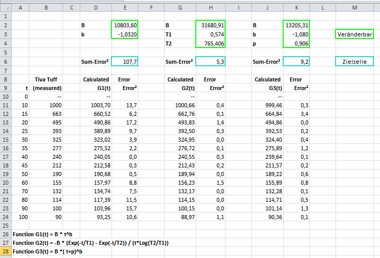

            • Thanks for the clarification guys.
              I'll update the data for the Tiva Tuff.
              BTW, the Oz Rock can't be modelled (fitted) with less error.
              Both approximation functions
              G1(t) = B*t^b and
              G2(t) = -B * (Exp(-t/T1) - Exp(-t/T2)) / (t*Log(T2/T1))
              doesn't fitt well in the measured data. The error at the beginning and at the end of the samples (early and late samples) is quite high.
              Cheers,
              Aziz

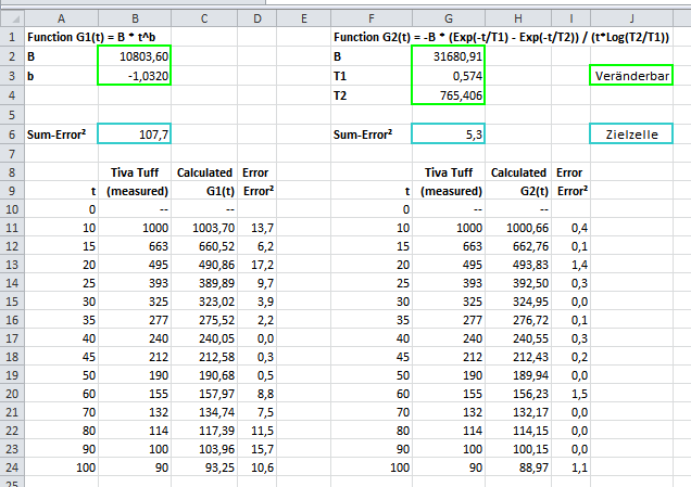

              • Look at this.
                G2(t) approximates the decay behaviour of Tiva Tuff much better (less error).
                Excel table (zipped):
                Decay_Eric_TivaTuff01.zip
                Aziz

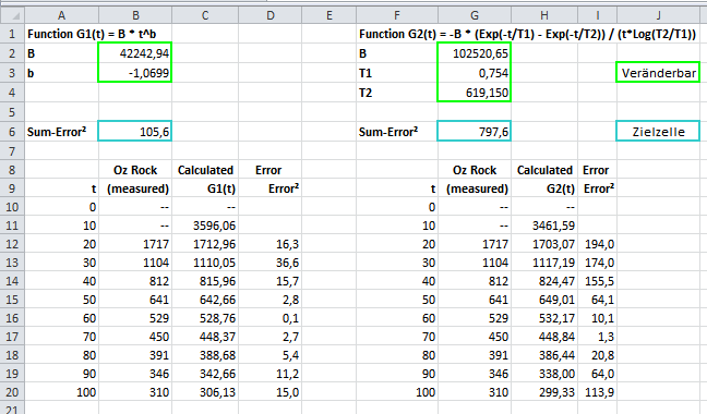

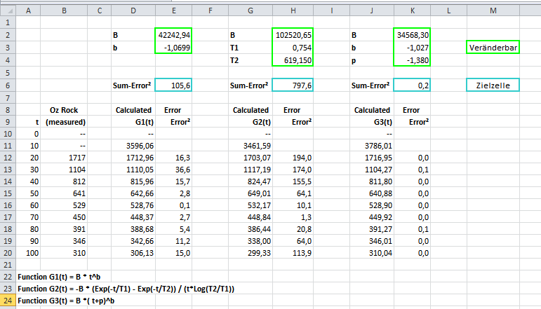

                • The Freakin Oz Rock
                  Now look at the freakin Oz Rock this time. And you will understand, that the Oz Rock is difficult to tame and it will screw your GB. All the nice presented formulas in the scientific papers can be thrown into the garbage bin now.
                  Decay_Eric_OzRock01.zip
                  I can't get better approximations with less errors. Even my own solver software does not deliver them.
                  Maybe Eric makes a more accurate measurement once again? (like the Tiva Tuff)
                  Cheers,
                  Aziz
                  • Aziz's Magic Formula G(t) = B*(t+p)^b
                    My magic formula is the best fitting and approximating formula so far!
                    G(t) = B*(t+p)^b
                    I'll show you all the three formulas in comparison soon.
                    Aziz

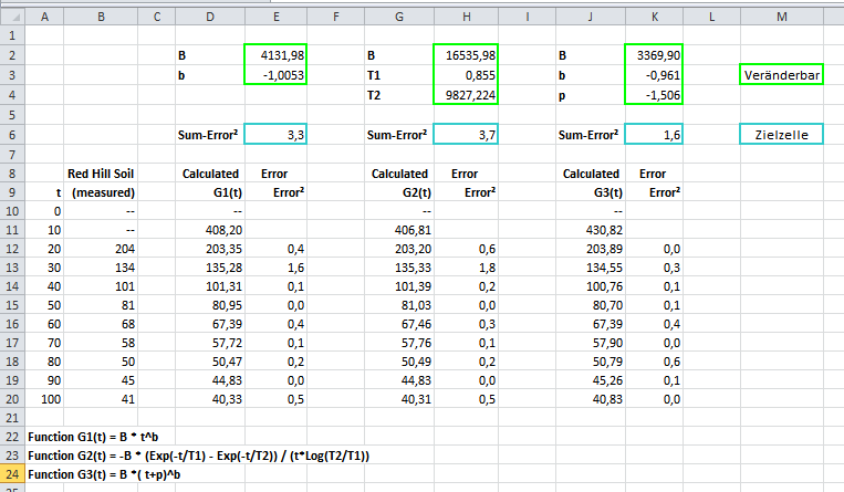

                    • Now lets see the best fitting results:
                      Red Hill Soil:
                      The freakin Oz Rock:
                      Tiva Tuff:
                      And the freakin Excel tables (zipped, three tables):
                      ExcelTables01.zip
                      Bugger me!, keep digging every signal!!!
                      (Could be a hotrock! *LOL*)
                      Cheers,
                      Aziz
                      • Hi Aziz,
                        Thanks for doing all this work. You had better summarise in words though, so we can all understand what you have found. I will re-measure some Oz rock samples as accurately as I can and post them shortly. I don't think a detailed magnetic study has been done before on Oz goldfield ironstone, so its properties will not be in any paper or textbook. Pity the sample I gave to Yoga Das as few years ago was not investigated. I will get in touch with someone else I know who might be able to get a mineralogical analysis done.
                        Eric.

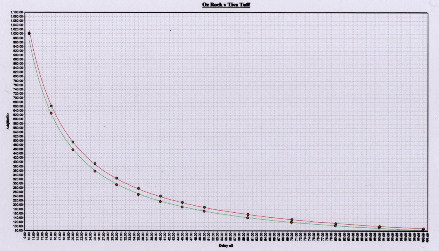

                        • Here are two superimposed plots of Oz Rock (green) and Tiva Tuff (red). Both plots commenced at 1000 units and placed on top of each other so only seen as one at the start point. The curve fit for the Oz rock was too far out in relation to the rest of the points, so ceases just below the 1000 dot. This indicates a faster initial decay for the Oz rock. The linear decay plot shows the true difference between both curves which gradually come together at late times. I get a slope calculation of -1.094 for Oz compared to -1.016 for Tiva for the portion between 10 and 20uS. You can see how the red dots drift below the line between 20 and 50uS and how some red dots drift above in the Tiva plot. This is to do with the opposing changes of slope that have been noted with these two different materials.
                          Does it matter? Not for most ground, but Oz ground is still a challenge that needs to be addressed.
                          Eric.
