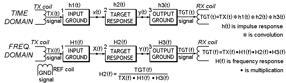

            • #51
              CONVOLUTION AND DECONVOLUTION
              I mentioned for convolution in 04-07-2008:
              "The complex plane displays things in periodic (frequency) domain. This domain is more obvious than time domain, therefore it is very handy for analysis and calculation because convolution is substituted by division."
              The description of above block diagram was posted in 07-21-2011
              Description in time domain:
              A time varying signal TX(t) excites with magnetic field the ground with target. We can make identification of target (block 2) if we know its impulse response h2(t). To calculate h2(t), we should know the input signal x(t) and the output signal y(t) of block 2 because we know that
              y(t)=x(t)*h2(t)
              where the sign * (star) means convolution (свёртка) - an integral math operation (search the web for details). For calculation of h2(t) we should make deconvolution (обратная свёртка) - a complicated math operation.
              At air test we know x(t) and y(t). The air test is specific case of measurement when h1(t)=1 and h3(t)=1.
              The block diagram shows the common case (when the target is buried). Then the output of block 1 (input ground) excites the target (block 2) and output of target (signal y(t)) excites the block 3 (output ground). As result we receive a very convolved TGT signal from block 3. If we know only the TGT signal and TX signal, we can not calculate the deconvolution of h2(t). We need the convoluting functions.
              Analysis using frequency domain
              A TX current containing suitable frequency spectrum excites with magnetic field the ground with target. We can make identification of target (block 2) if we know its frequency response H2(f). To calculate H2(f), we should know the input signal X(f) and the output signal Y(f) of block 2. We know that output signal of target is
              Y(f)=X(f).H2(f)
              where the sign . (point) means multiplication. For calculation of H2(f) we should make division of two functions - a simple math operation:
              H2(f)=Y(f)/X(f)
              We know X(f) and Y(f) when we make air test. The air test is specific case of measurement when H1(f)=1 and H3(f)=1.
              The block diagram shows the common case (when the target is buried). Then the output of block 1 excites the target (block 2) and output of target excites the block 3. As result we receive from block 3 a TGT(f) signal which spectrum is multiplication of several frequency responses. If we know the shape of frequency responses H1(f) and H3(f), we can calculate the shape of H2(f).
              To know the shape of H1(f) and H3(f), we should receive a separate GND signal. A method for making this is illustraded in the lower left corner of the figure. A reference coil REF is positioned in induction balance to TX coil. Balance means AIR signal is zero, ie it receives only GND signal.
              However if the ground has conductivity, H1(f) and H3(f) have different shape. We should make measurements to see if H1(f) and H3(f) differs in shape.
