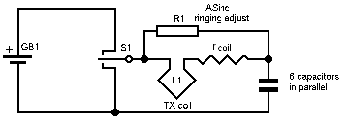

        Moodz, there is no secret in "ASinc ringing".
        I posted in the forum the circuit diagram of a ringing TX with the simplest pulse forming network. It is realized before more than 100 years.
        You can calculate the components of the attached equivalent circuit diagram. Here is a calculator:
        Pulse Forming Network, circuit, equations, PFN, line type modulator, schematic, diagram, waveform, transmission line, pulse generator, Type A, Type B, Type C, Type D, Type E, Type F, Rayleigh, Guillemin, voltage-fed, equations, formulas, square pulse, pulse shaping, pulse forming, section, capacitance, inductance, calculator
        Dave J. uses this equivalent circuit diagram in one of his patents, however he doesn't know that it can operate as an ASinc ringing TX.
