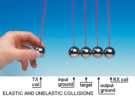

                    • HOW THE SENSING SYSTEM WORKS
                      Look what happens when the balls of Newton's cradle have names :-)
                      What excites the "target"?
                      What excites the "RX coil"?

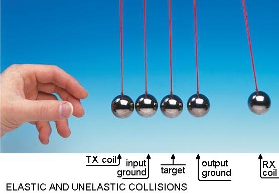

                      • THE ROLE OF THE BAD GROUND
                        The illustration below is valid for an elastic system.
                        What will happen when balls "input ground" and "output ground" make phase shift?
                        What will happen when balls "input ground" and "output ground" are unelastic?

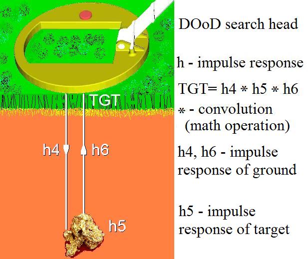

                            Here is the first post:
                            The name of the best ground balance method is
                            DECONVOLUTION
                            http://www.dspguide.com/ch17/2.htm
                            " Deconvolution is the process of filtering a signal to compensate for an undesired convolution. The goal of deconvolution is to recreate the signal as it existed before the convolution took place. This usually requires the characteristics of the convolution (i.e., the impulse or frequency response) to be known..."
                            Measurements in frequency domain showed that OZ dirt has very different properties starting with conductivity as temperature dependent semiconductor and ending with magnetic decay law t^-4 ie 1/(t^4). However the ground properties are not important for signal processing algorithm. More important is the search head to deliver a GND signal. The signal processing should use it as reference to calculate deconvolution of TGT signal. I showed in the Geotech forum the block diagram for algorithm and the suitable loop configuration of search head.
                            The attached image illustrates that the TGT signal is twice convolution of targets impulse response h5(t) with impulse response functions h4(t) and h6(t) of ground.
                            CONCLUSION: To obtain pure information for target, the signal processing should make deconvolution of TGT signal.

                                Eric, three men in this thread think that know the best algorithm for ground balance:
                                - a software ingeneer (Aziz),
                                - a professional (you) and
                                - a hobbyst (me).
                                My algorithm can not be patented because I showed it in this forum and in Doug's forum. However the fun is that the method is not mine. Search the WEB for "convolution" and "deconvolution", read textbooks and papers and you will see that the method has no alternative - all other methods are simplifications and speific cases of deconvolution..
                                Aziz started to explain his method in Doug's forum. The method of Aziz is suitable for a specific type soil, but Oz soils are very different in properties.
                                Remains somebody to show something better than deconvolution. This is impossible.
