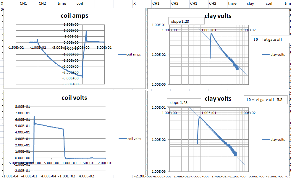

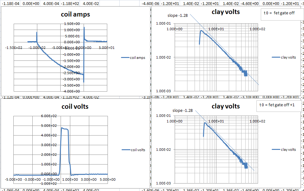

Hi Aziz,
no problem to use t0 = MOSFET gate switch off – then 'p' has to be adjusted to compensate the flyback pulse width. 'p' may also be influenced slightly by the driving pulse width as long as the pulses are not separated in time.
Yes, fully agreed. The problem is that the guys in the VRM document that you linked in post #531 completely ignore the flyback pulse, and only use the pulse width of the driving pulse to derive their equations.
Again, please read my comments to this in post #545.
