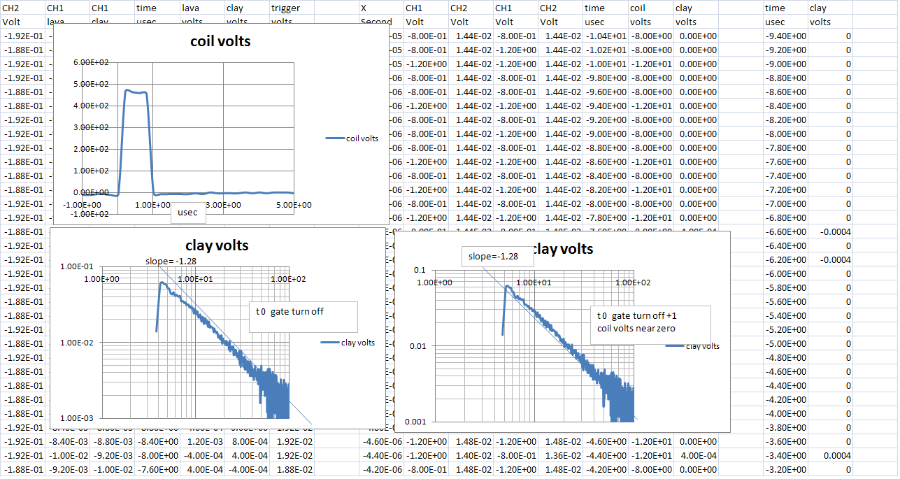

                          • Plots not as clean as PiTec, but show a trend. In the past I've used gate turn off as t 0. Didn't matter for log-lin plots. The log-log plot looks better if I use coil turn off as t 0 same as PiTec. The clay from the yard doesn't give much response. I'll try to add more gain and try to get a better curve. The scope was triggered at gate turn off,t 0. A line with a -1.28 slope was added to both plots.
                            • Thanks, green. Try to extend the flyback pulse width by clamping the flyback voltage to 100 volts or less, then the difference between the two trigger points becomes more obvious. Also, the steepness of the slope should decrease.
                              • "Himmel, Arsch und Zwirn nochmal!"
                                Hey guys, I must insist on t0 = mosfet switch-off time. This is the standard reference time in the VRM science.
                                If you take t0 at a different time p, you are just implementing G(t) = (t+p)^b.
                                And you get different exponents b and they won't be comparable to the parameters of the standard VRM science (exponent b around -1.0).
                                The VRM response is dependent on the period prior to t0 (=switch-off), i.e. the TX pulse history (shape, duration, etc.) and flyback period (the shape, duration, etc. ) .
                                It is quite difficult to determine/measure the end of the flyback period. But it is more precise to take the mosfet switch-off time as t0.
