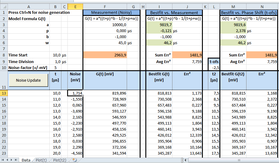

                • Hi all,
                  I have continued my numerical best fit simulations and found interesting facts, we can apply to our latest measurements. I have even added some noise to the numerical simulations.
                  The formula 17 in the mentioned scientific paper can be extended to detect different exponents b. But not phase shifts or time base corrections p. So the time code in the measurement data must be correct.
                  The formula 17 gets into the form, when adding exponent b:
                  G(t) = a*( t^b - 1/(t+w) ), (p set 0 and simplified the equation)
                  The Excel Solver works quite stable to find the parameters a, b and w. It seems, that in this case only one optimal solution is possible (no local minima). That's a good news.
                  But if your time base isn't correct (if you set your time code t0 at 0 µs but in reality it is time shifted like t0 = +1 µs) then we get totally inconsistent & not reliable model parameters. (see first pic).

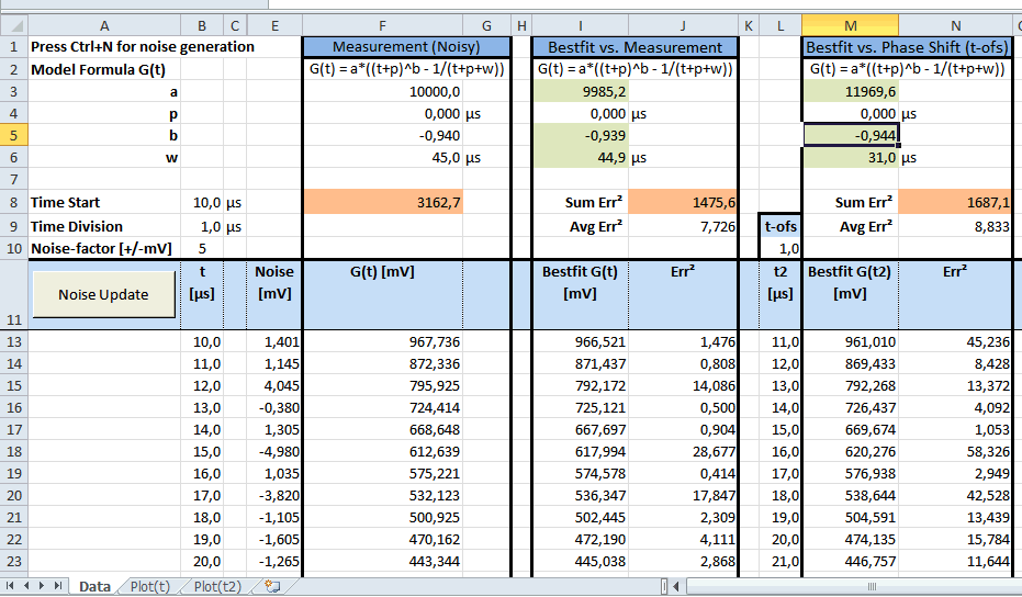

                  If we set exponent at b=-1 (1/t term gets valid in formula 17), then we can detect phase shifts and time base correction offsets (see second pic).
                  But this wouldn't make sense. Better we eliminate p with correct time base and look at the exponent b variation. And we can test, whether the VRM formula fits well into the measurments.
                  Cheers,
                  Aziz
                  PS: The exponent b calculation is quite more stable and reliable than other parameters. We can compare the b=-1 best fit against the calculated b in the measurement data. And this is going to be very interesting, which one wins the run (with less fitting errors).
