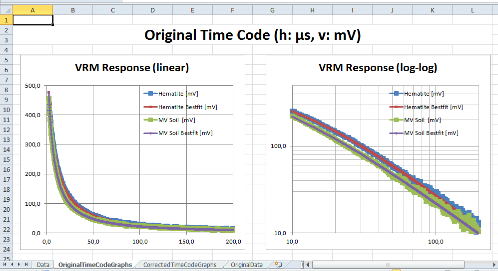

                      • Solution and Solved Issues
                        Hi all,
                        I think you have scratched your head long enough. It's high time to reveal it.
                        VRM decay measurements require precise and accurate timing records.
                        I'm referring to the data provided by Thomas mentioned in the post above (see link there). And why the hell it hasn't been a straight line log-log decay?
                        In the post #47 and we can obtain the following infos:
                        Pulse on period: 50 µs, flyback period: approx. 2 µs, "Decay curves start approx. 5µs after the 2µs pulse". And we have the time code of the samples starting from 2.4 µs.
                        One of the VRM measurement was "adjusted" to have same initial decay value (approx. 456 mV). It is very obvious, that the time base for that VRM measurement was time shifted. But recorded at the same time code with the other VRM measurement.
                        So we have a totally unknown and imprecise time base for the VRM measurements.
                        time code = real time + offset time

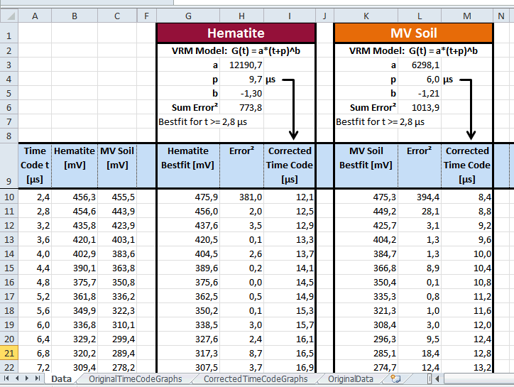

                        And now comes my magnificiant VRM formula:
                        G(t) = a*(t+p)^b
                        This formula can detect such unknown offset time shifts in the measurement data. Provided that, there is no significant physical effect in the early decay times. We haven't figured this out yet and we would require very precise data for this issue to solve. But it is very likely, that p either doesn't exist or can be totally neglected due to not significant effects (p < 1 µs). Note that every TX and RX combination of the front-end may cause p to exist even there might no physical effect.

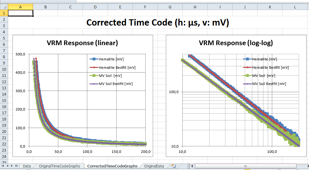

                        Well, if the time code in the VRM data was correct we would see nice straight lines in the log-log plots. Indeed, that's going to happen (see below). We have for the hematite sample a decay exponent of b = -1.3 and for the MV soil b = -1.21. BTW, it has been already found that the exponent is dependend on the pulse length (see Paltoglou and other scientific publications).
                        G(t) = a*(t+p)^b reduces with the correct time code into
                        G(t) = a*t^b
                        And that is the good old exponential decay (not to confuse with the exponential decay of the target responses Tgt(t)=a*Exp(-t/TC) ). The 1/t law requires conditions to be valid, whereas the exponential decay is always valid.
                        The pictures and the Excel file to peer review for you (that's very important of course).

                        The corrected time code is calculated as follows:
                        corrected time code = time code t + p
