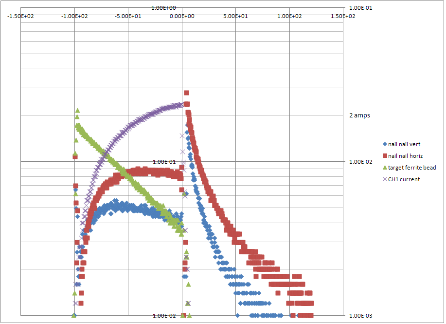

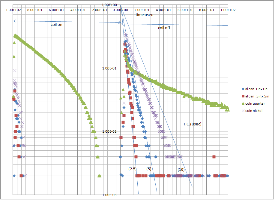

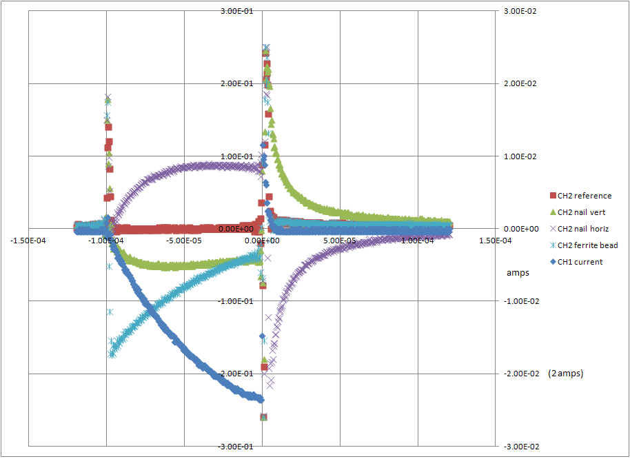

VRM decay measurements require precise and accurate timing records.
I plot decay curves because each time I try to get them better and I learn something trying. Sometime the T.C. are different than stated in other posts. What is important in measuring ground response? I'm guessing 10 or 100 Mhz amplifier response doesn't matter and 100khz or 1 Mhz does. What is the minimum frequency requirement needed to measure ground response. I'm thinking coil resonance and damping might be important. Reading the replies above, on time is important. Is charge shape important? When does decay time start? Does a flat peak on the flyback matter? What else is important. Is there a test that be could done on the setup that would check for minimum requirements? Maybe recording a target with a 1 usec T.C. I'm thinking this is important for measuring ground response, maybe, maybe not for rejecting ground.
